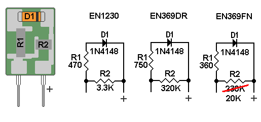

I just always post this thread whenever i see the 'homebrew bias parts' from CBtricks being posted:
https://www.worldwidedx.com/threads...rawing-and-the-correction.157713/#post-436556
the 369FN has a typo and will not work correctly as it is drawn.
