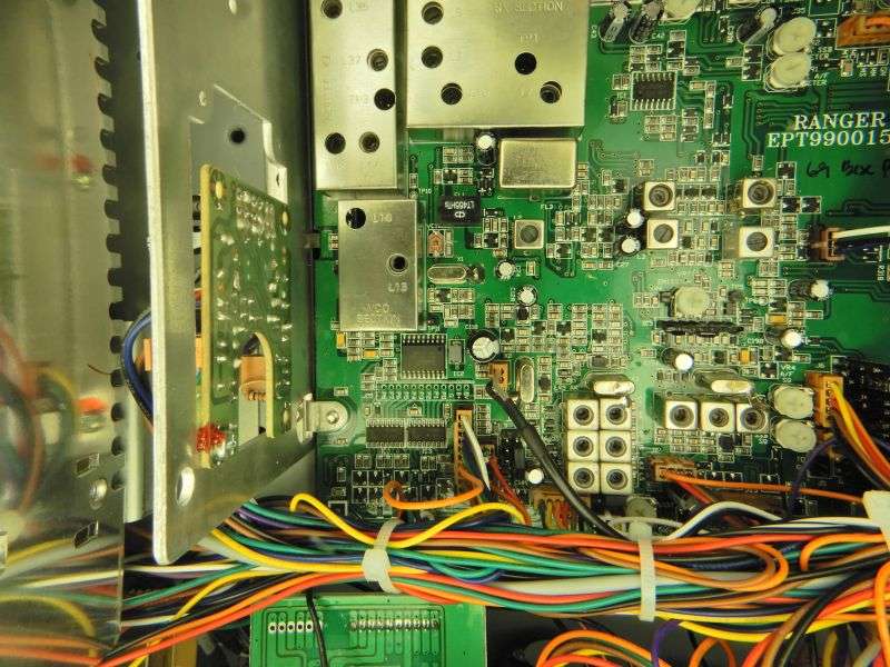

This is the new circuit-board number, mostly surface mount now.
So here's the front-left corner of the circuit board where all the PLL stuff resides.

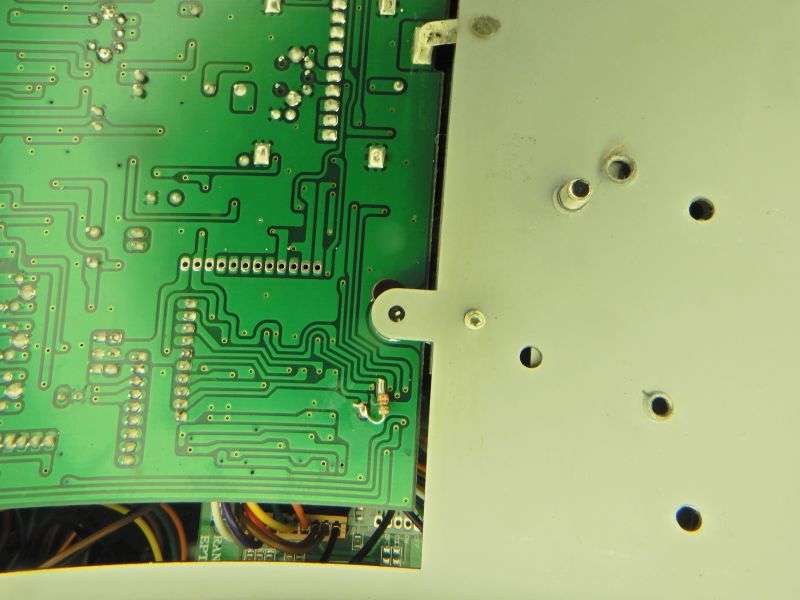

Directly beneath on the 'solder' side of the pc board you'll find this 100 ohm 1/8-Watt resistor. Remove it.

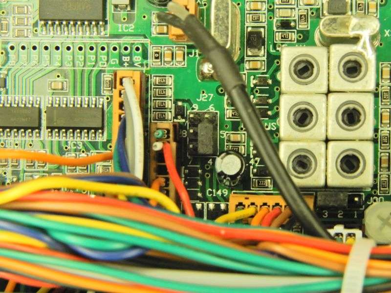

You'll find one set of six jumper pins and one set of three at the front edge of the pc board.
Plug them as seen here, the one with three pins connects pin 2 to pin 3, the left two pins. The six-pin header gets 4 and 5 connected.
And that's it. The six-position band knob along with the "High/Low" lever switch gets you twelve bands.
