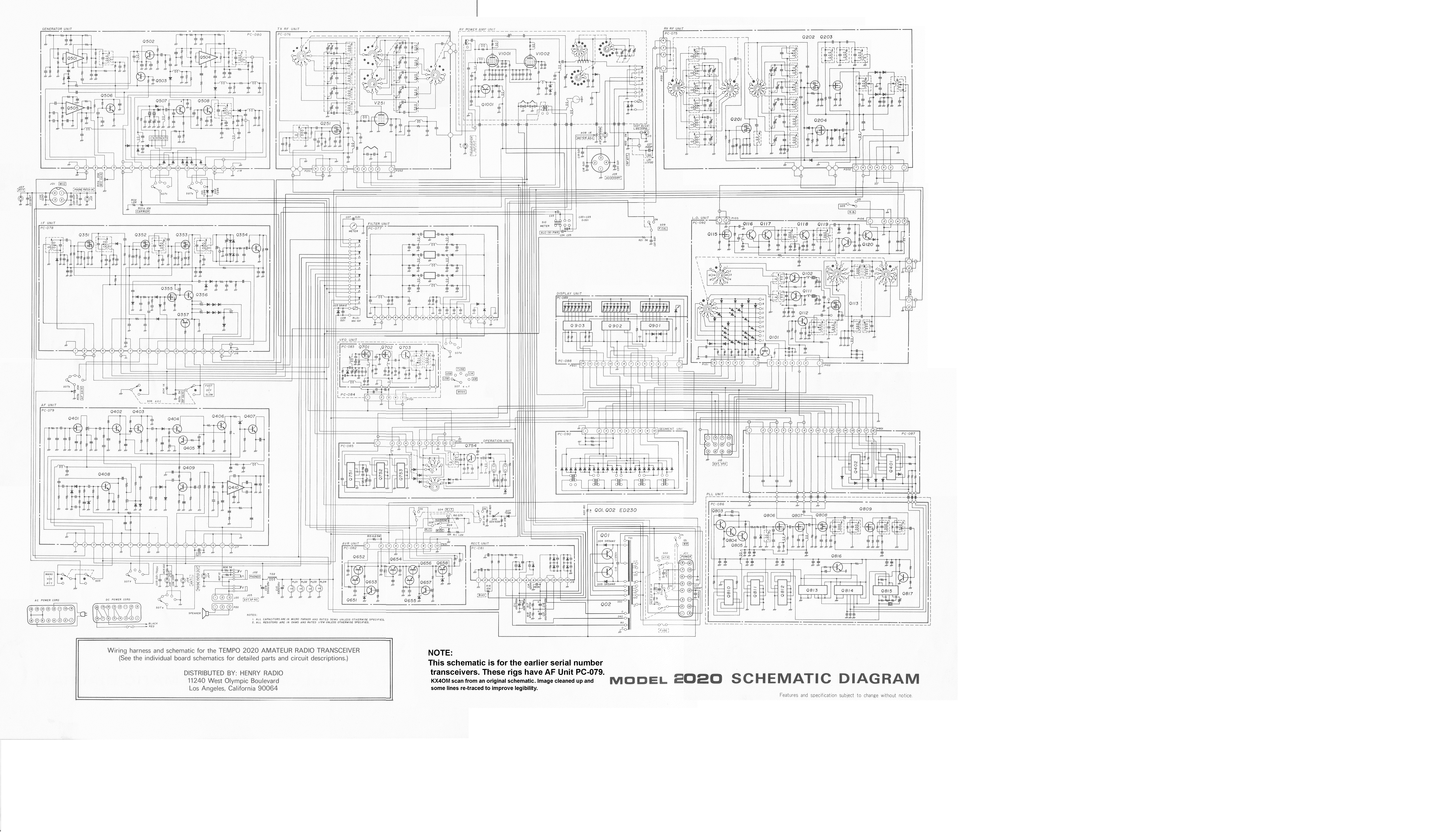

Uniden Tempo 2020
schematic ref. uF V Digi-Key P/N

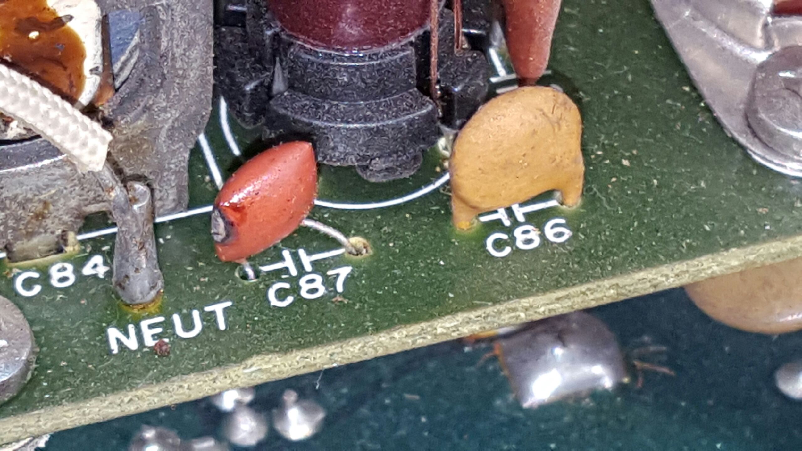

c87 arcing to the neutralization wire

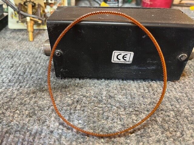

But to see on old Tempo rebuilt using our newer technology of 3D printing - allows us to maintain the older equipment by fixing what was once an Achilles' Heel of it.
