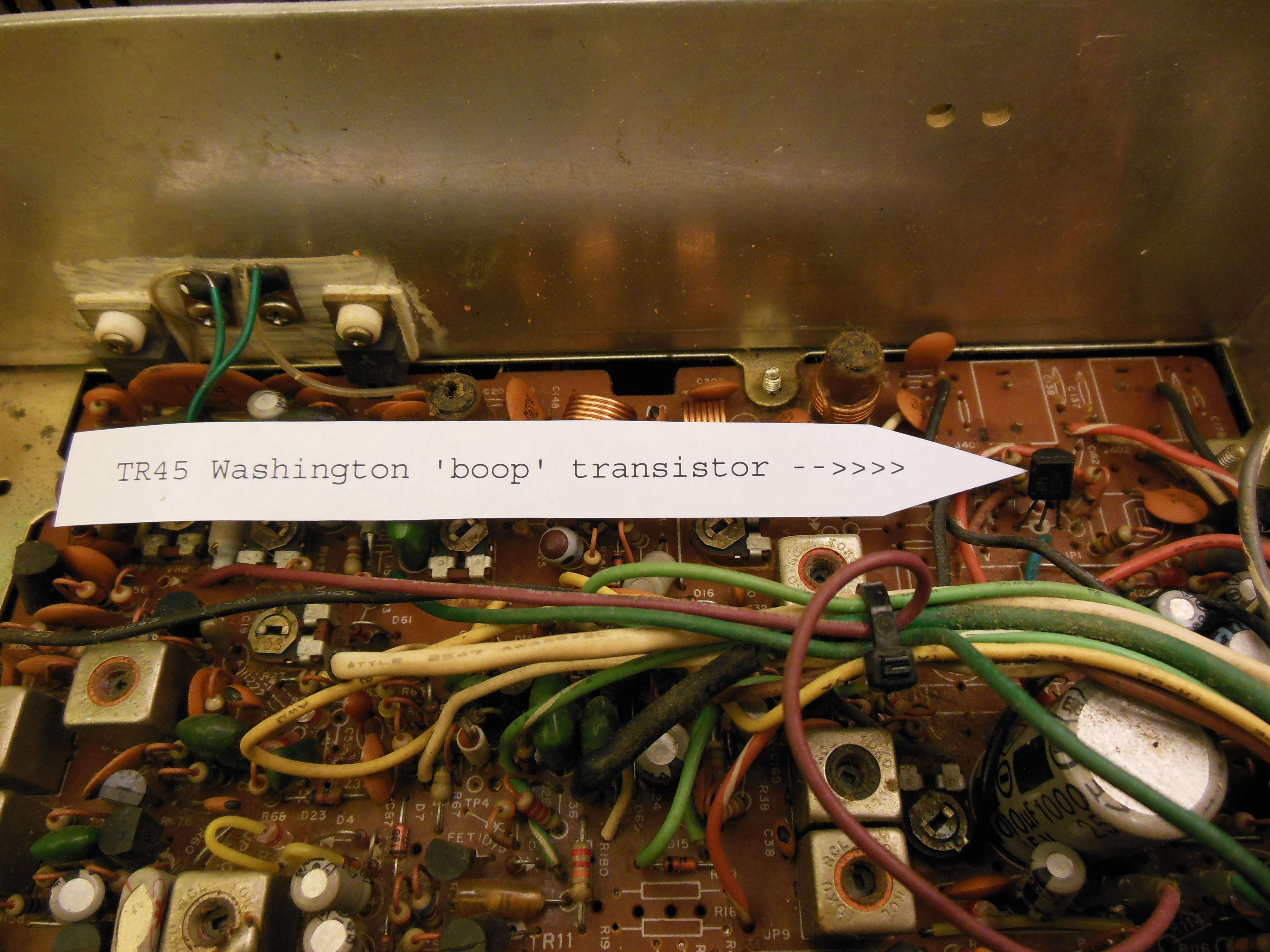

I see this a lot on the 858 chassis radios. Trc457 458 138 Washington etc. Sometimes a quick chirp sometimes a slight fart. Only the person on the other end can hear it. Never could figure out what it was. But a lot of people have said give the VCO a little turn. Never tried it.
We found this became a common problem in the 1990s-era Washington when the modulation limiter is opened up.
Fix is to remove a mute transistor. It serves to shut down the receiver audio when the PLL loses its lock on the channel frequency.
It's marked TR45 in the late version schematic, but the screen print on the top side of the board does not have a callout for it.

the added benefit of removing this transistor is that your receiver will no longer mute when changing channels.
you know how when you spin the channel knob a bunch of clicks like trying to go from channel 1 to channel 30 in an instant, and your receiver goes quiet until you get to channel 30?
well that won't happen anymore once you remove that transistor.
you can now spin the dial around looking for open channels without clunking through them slowly.
the equivalent transistor in a dual conversion MB8719 like the 148/2000 would be TR47.

TR45 fixed the fart. Thank you! I was just about to let it keep farting till you posted this. Thank you again..
The popping between channels was the next issue to be looked at and TR45 took care of that also. Killed two birds with one stone.
I have same year or close radio so your saying if the modulation limiter is cut you have to remove tr45?
You don't have to.... it just stops the "BOOP" sound when the channel selector is changing. Maybe you like that sound and want to keep it in lol... It's up to you.
