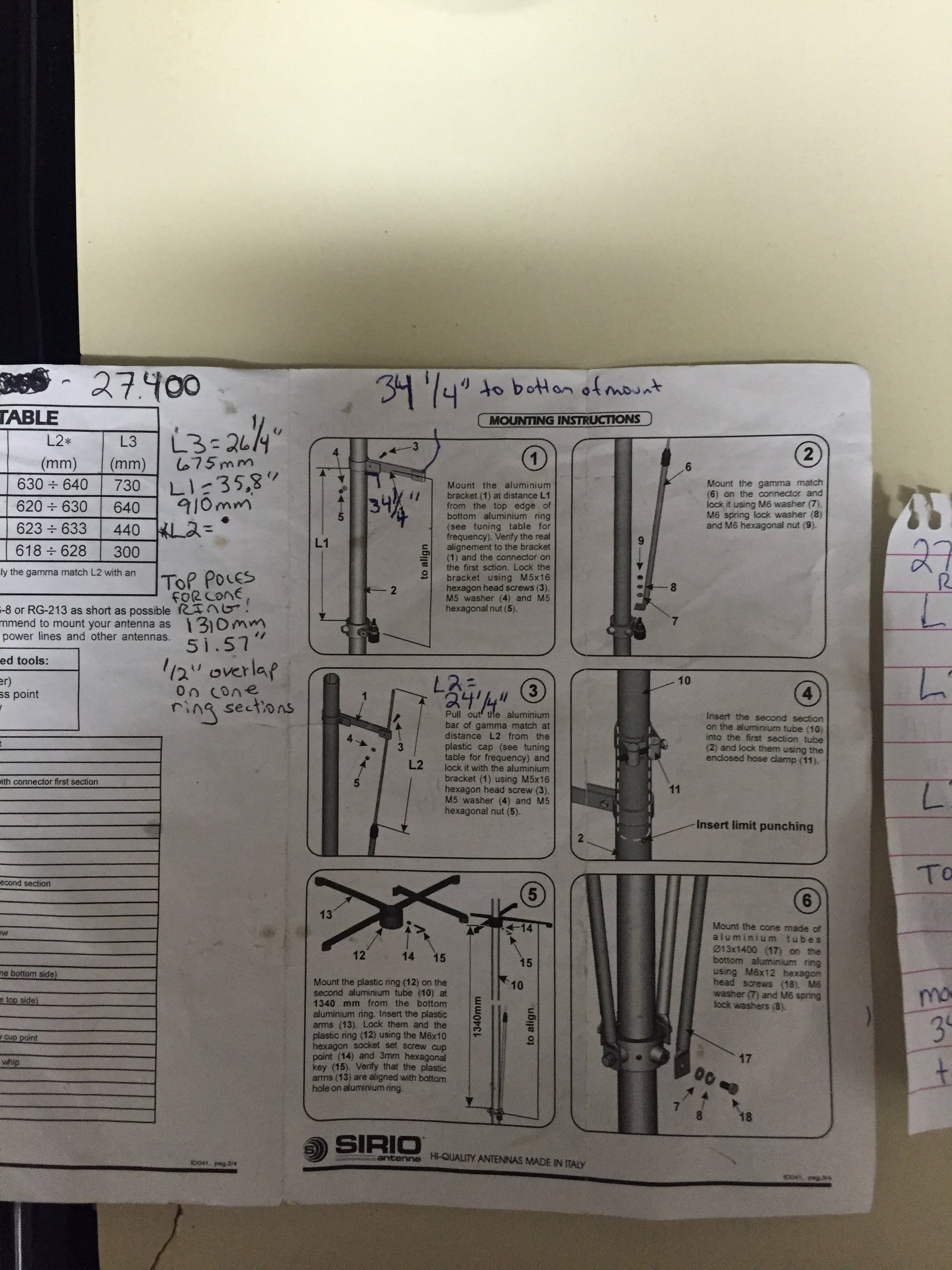

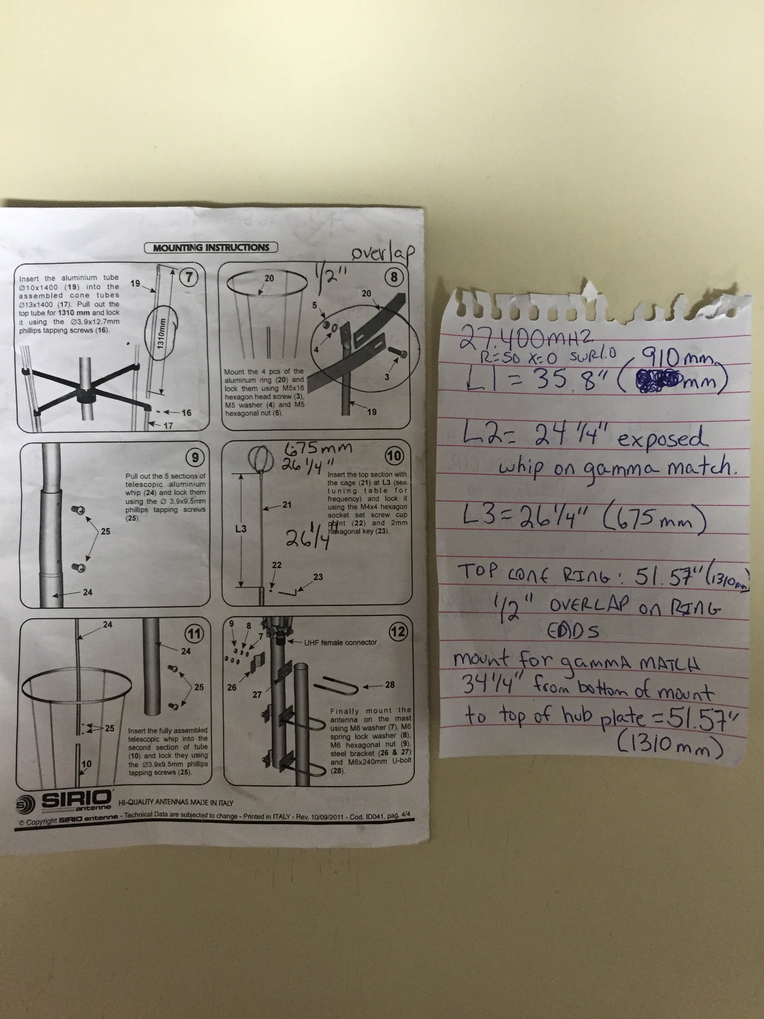

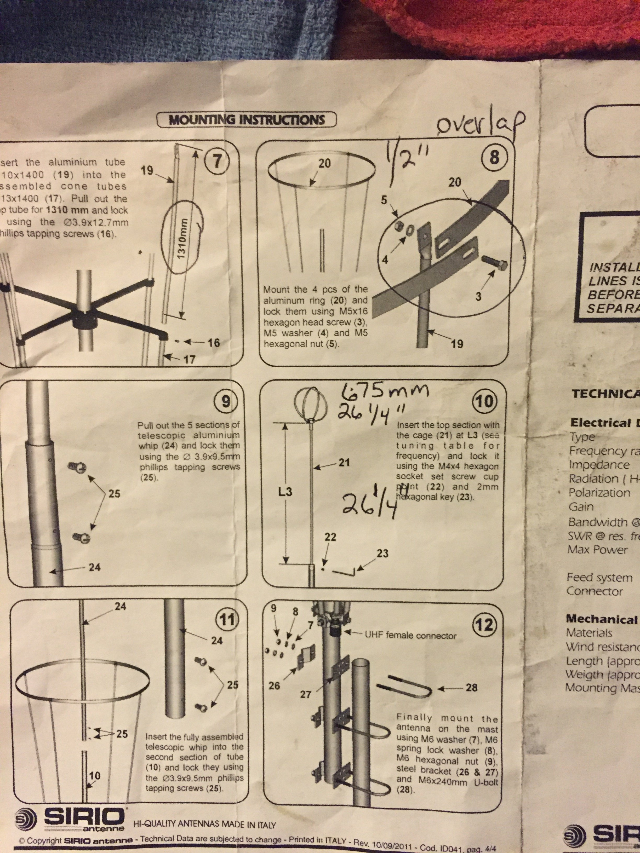

Yes I did Marconi, I adjusted the cone ring to have a 1/2" overlap. I moved the upper portion of the cone ring poles up to 51.5", and I lowered the whip to 26 1/4". And lastly I adjusted the gamma match a bit. This made antenna resonant at 27.400 or there abouts with the readings i gave above. Vswr stayed at about 1.3:1 on channel 1 and goes to channel 27.555 with the same vswr. Never made it to 2:1 vswr, but will get some more readings tomorrow. R and X change a bit but not bad like before. Much more wide banded it seems. At radio all is same. I'll get all dimensions up Marconi, including the length of the gamma match whip. I was just too tired to mess with it anymore. Need to place back up in the air and all should be good. I spoke with a different local and he too was impressed that the antenna was only 7-8ft off the ground. Said I had best signal I've had to him ever. This is the opposite way of my other local that said the same. I came up now on the upper channels ans from 1 to 40 the signal reports now stay the same. Again I thank all of you for the help and will get the antenna dimensions all posted as well. Now I'm happy with the antenna, and pleased with myself for getting it right. Took some time, but I kept on thinking what The DB said to me and it stuck. Changing physical dimensions was totally what was needed. And I was totally prepared to go the distance to resolve it. Wasn't as easy as tuning my tornado, can see why some would be intimidated by this antenna. But I am hear to tell you that if you take your time and follow the instructions and have some good help it will go much smoother. No mention of the 1/2" overlap anywwhere, and also the length for the gamma match, the formula they give makes no sense to me. See photo below for reference as to what I am speaking of. Anyone care to explain this one to me. I had a hell of a time tuning gamma match, but was able to get it. It's very touchy and doesn't take much movement when it's close. Just my experience so far. I still need to fill in the length for L2, but will do that tomorow. Here are the rest of the measurements I used for tuning to 27.400MHz.
Hope this helps. The rest of the antenna just slides together and screws to hold in place. This is where I used heat shrink and also I used no-ox on all connections and also a very light coat over entire antenna. Makes the water just bead right off. Anyway. Again I hope this info helps someone. It helped me a bunch. Thx again fellas!!

Marconi, here are all the measurements besides the poles that are pre-measured. Photos attached.
