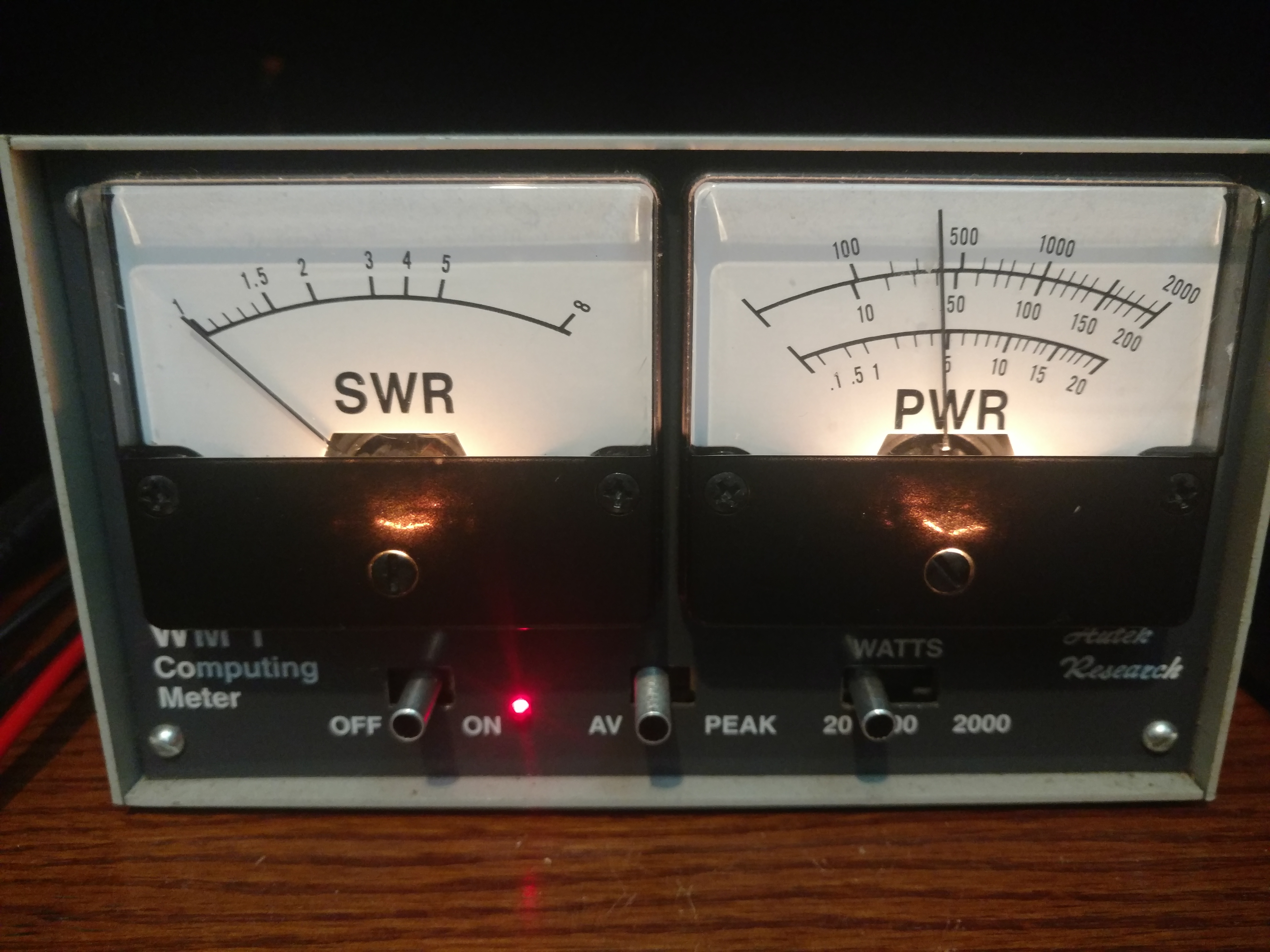

Here is the radio dead key. On average mode and 20w scale. Right about 5w.

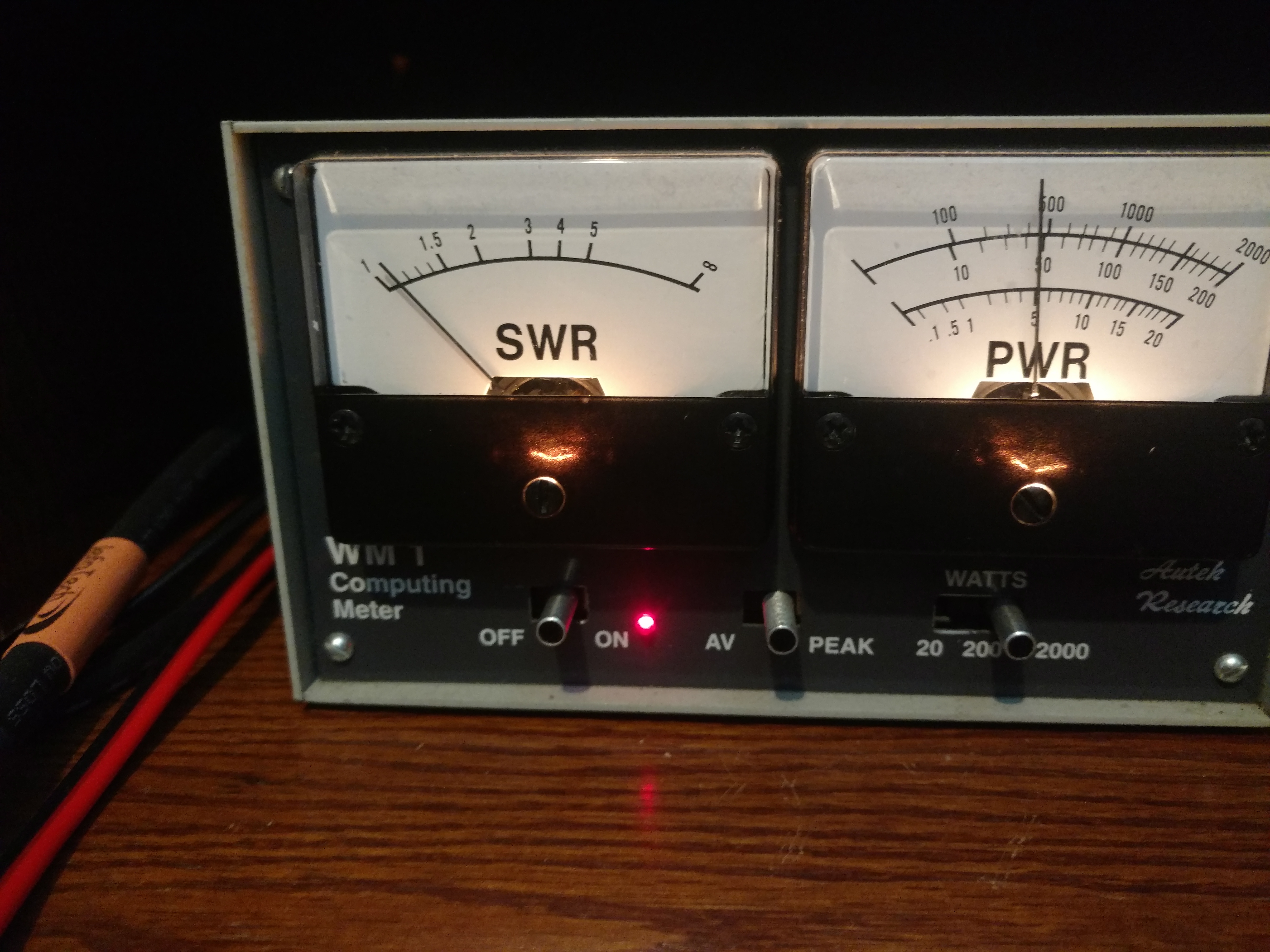

Here is the radio peak output. Peak mode and 200w scale. Right around 50w with a whistle.

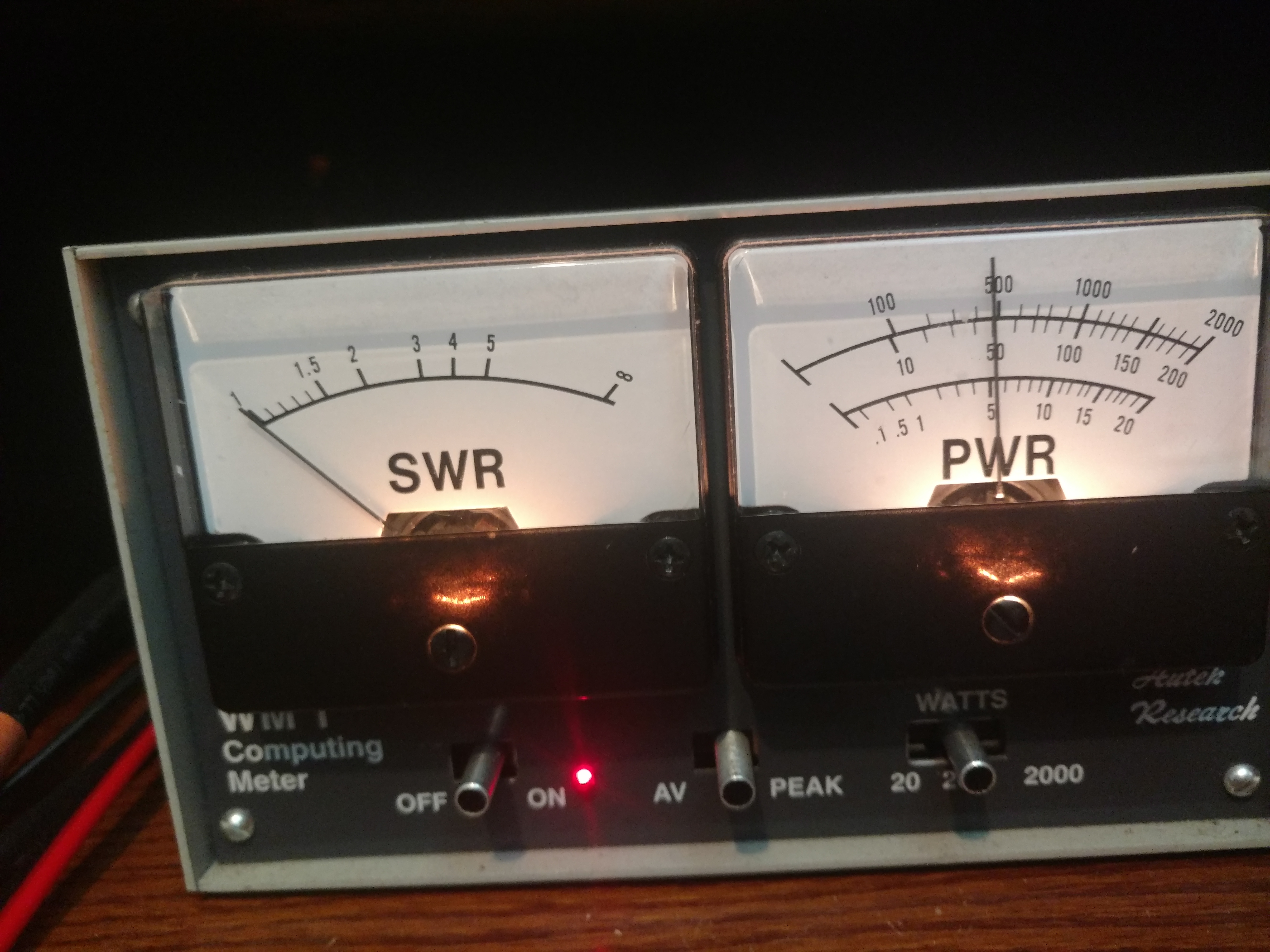

Here is the amplifier dead key. Peak mode, forgot to switch to average. Should be about the same without modulation. On 2000w scale and about 100w output.

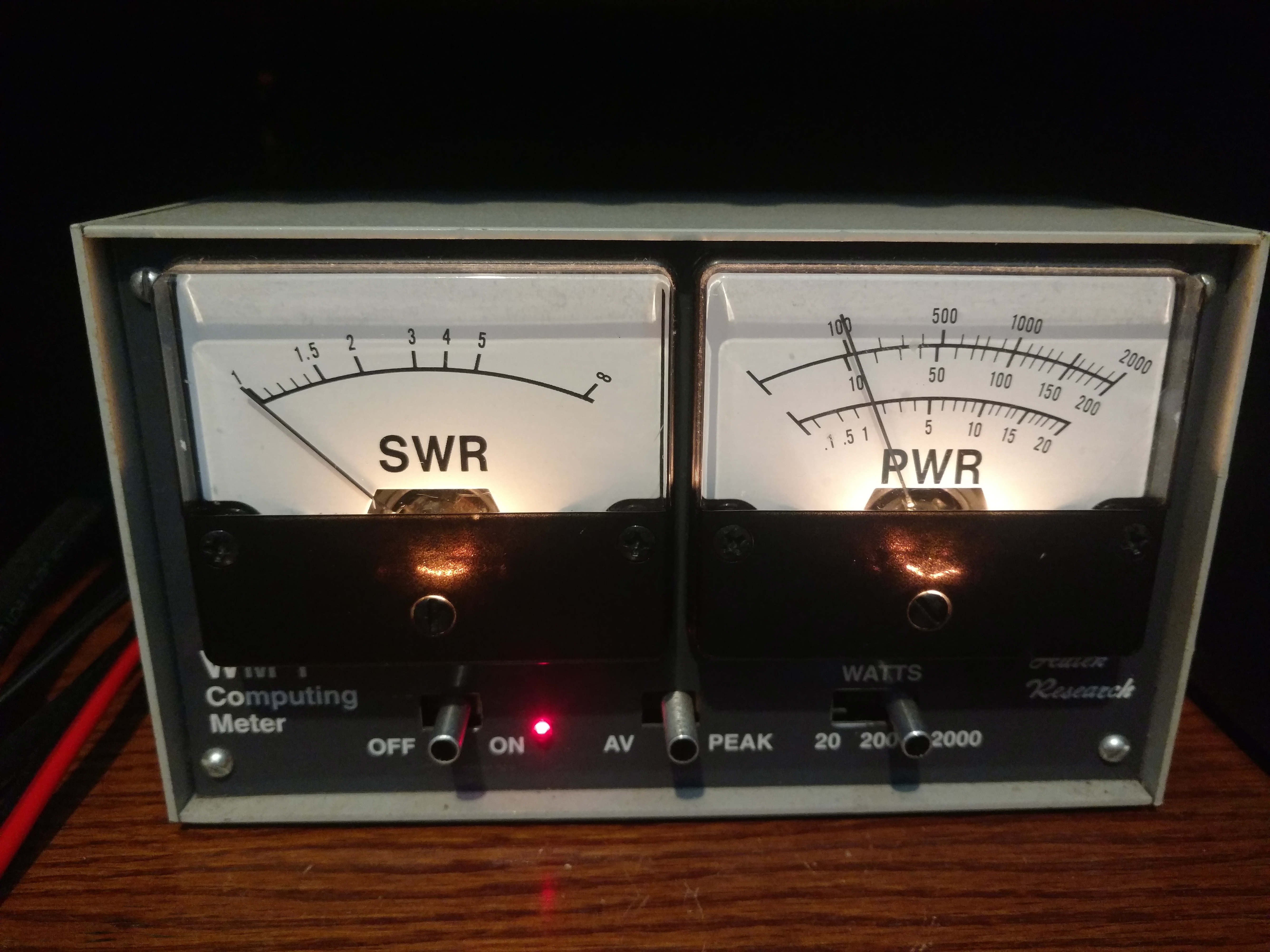

Here is the amplifier peak output. Peak mode and 2000w scale. With a whistle, about 500w. I can make it bounce higher but I think that is just the momentum of the needle.
