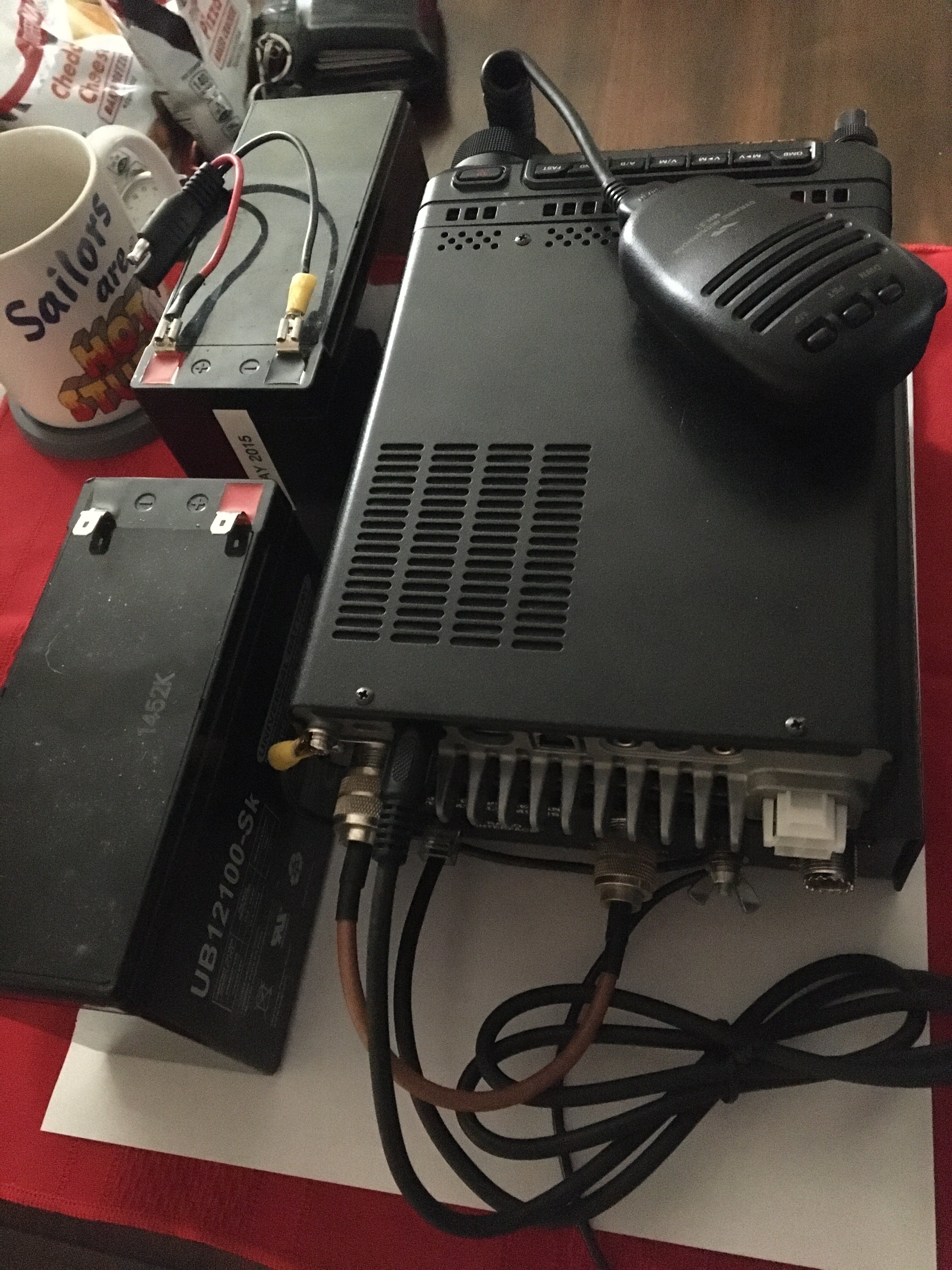

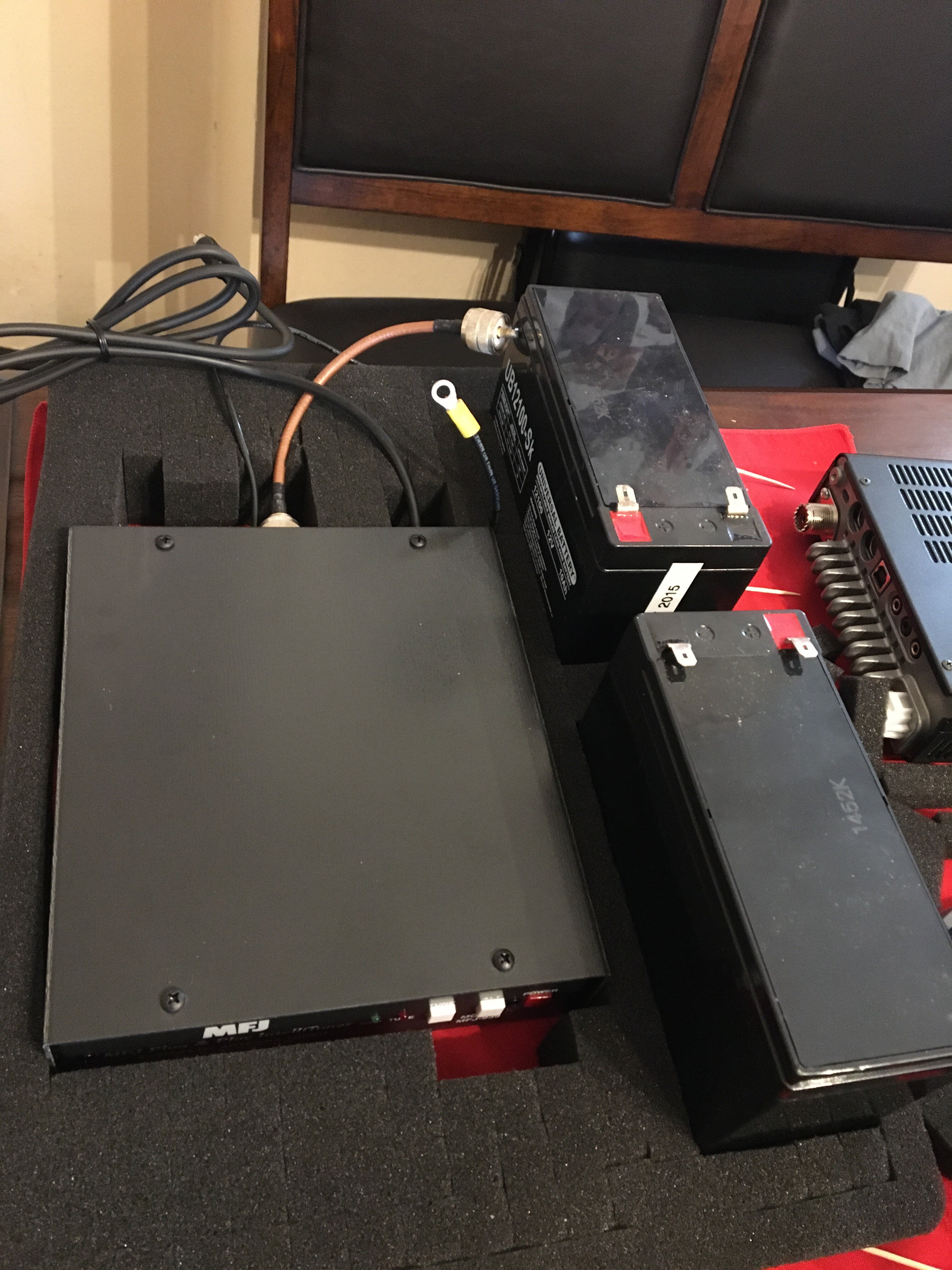

Second option is the HF Apache 3800 case. Interior is 14 7/8" x 10 5/8" x 6 1/8". The white paper shows the interior size of the 3800 case. Use would be open the case, pop the front leg on the 891 to get a decent view of the screen and VFO. MFJ-939Y tuner would be under the rig. Case would be open during operation. Holds 2x of the 10AH SLA also. Last pic shows 891 leg up. I would drill and install a PL-239 passthru for the antenna feedline and power port for charging the SLA or other batteries.

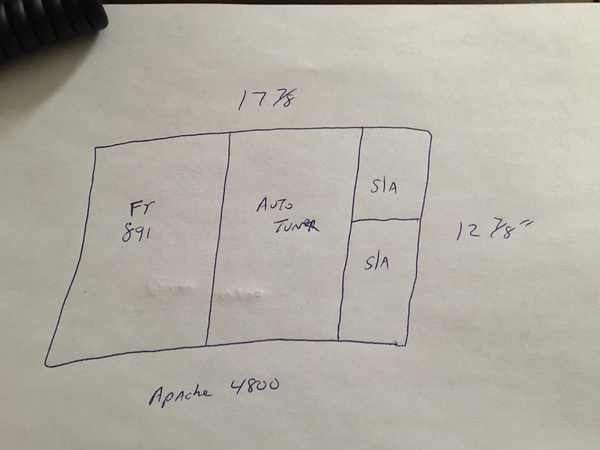

Other option is the Apache 4800 case.
Tuner/Radio/2x 10AH batteries side by side. Case interior is 17 7/8" x 12 7/8".

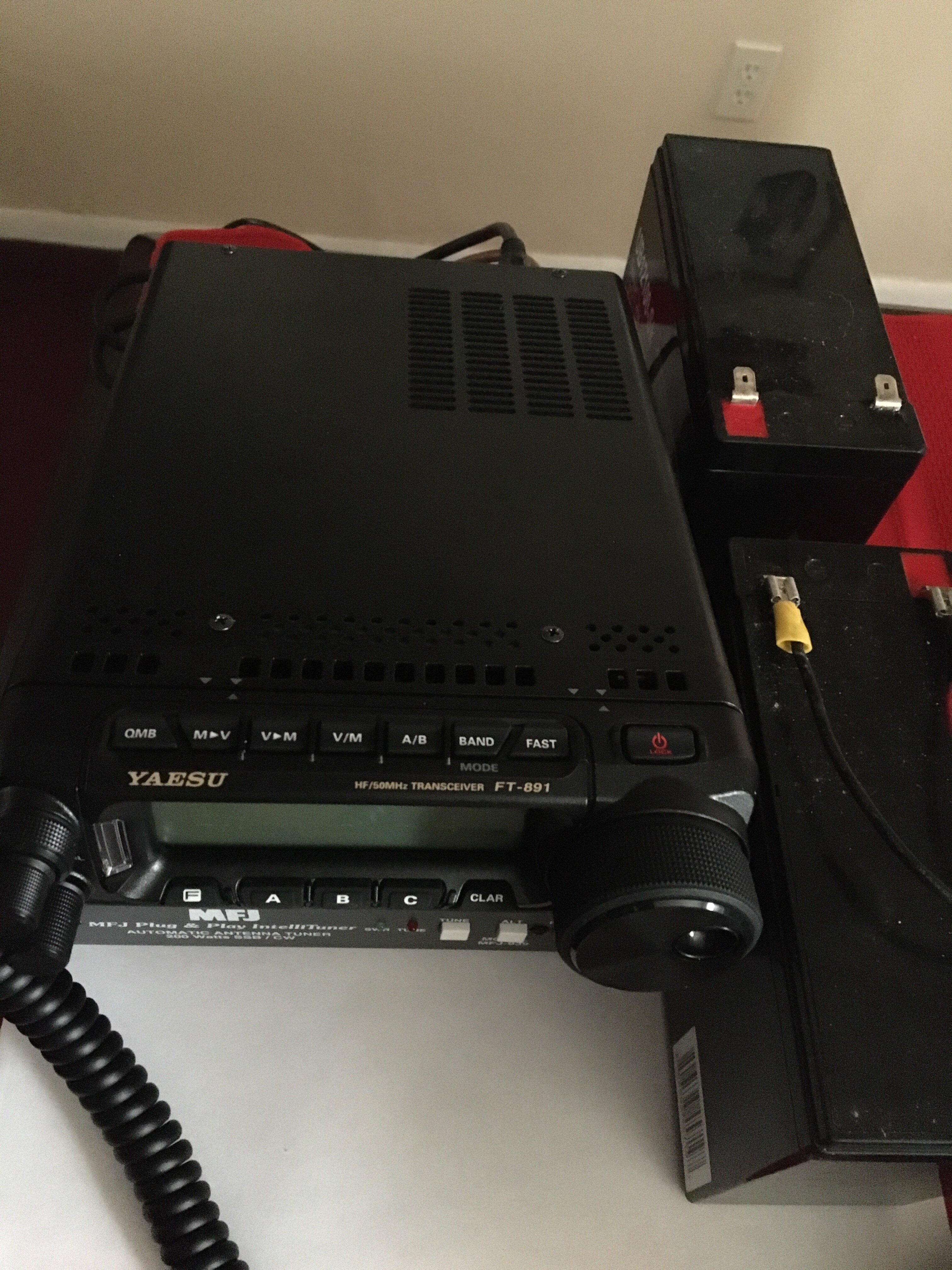

The 891 with out the head and using a 90' coax is about 9 1/2" long. Only 6 1/8" wide. The head with knobs adds 1 5/8" to the 9 1/2".
I'd like to also keep the 2x 10 AH battery in the box to.

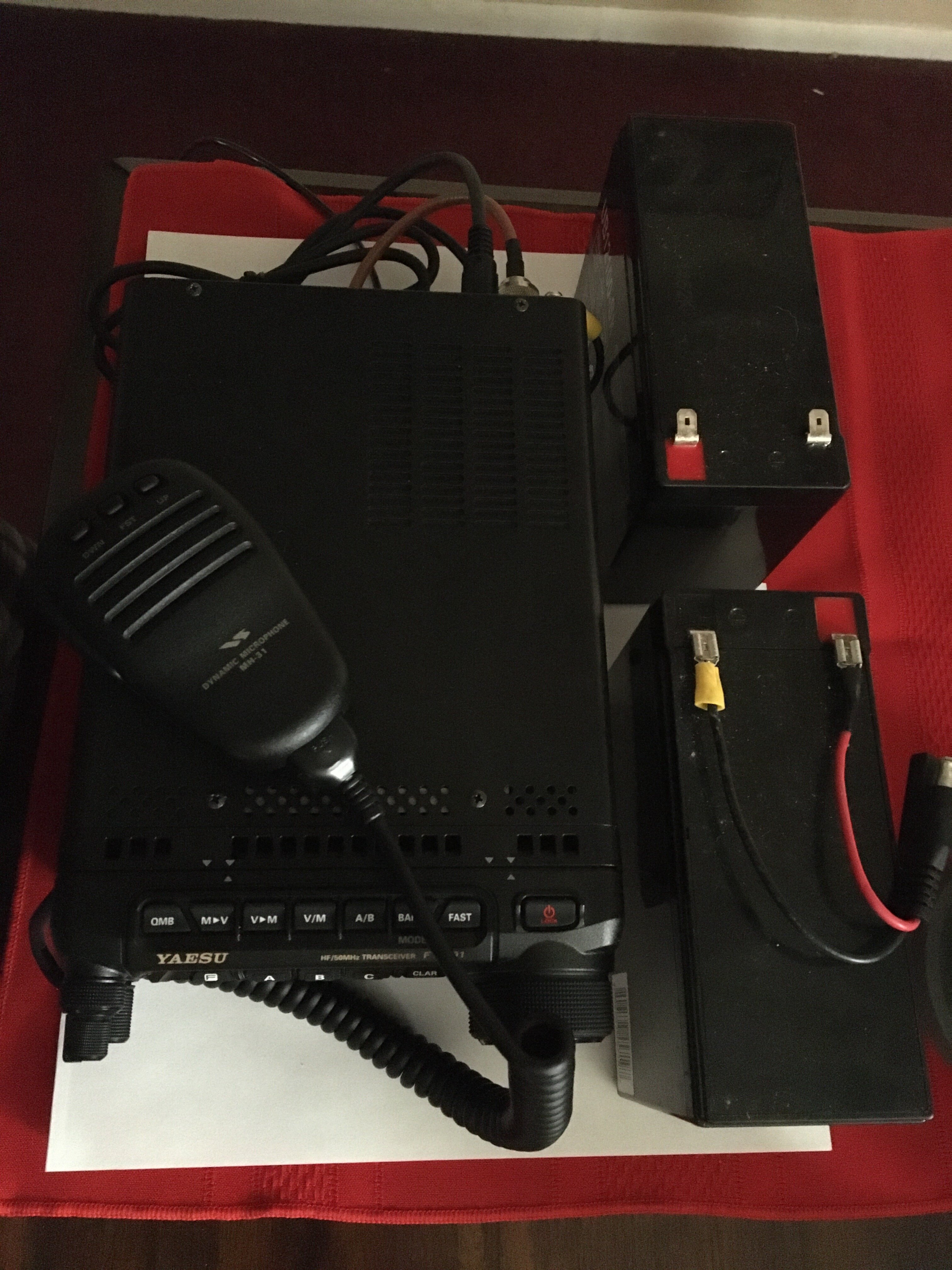

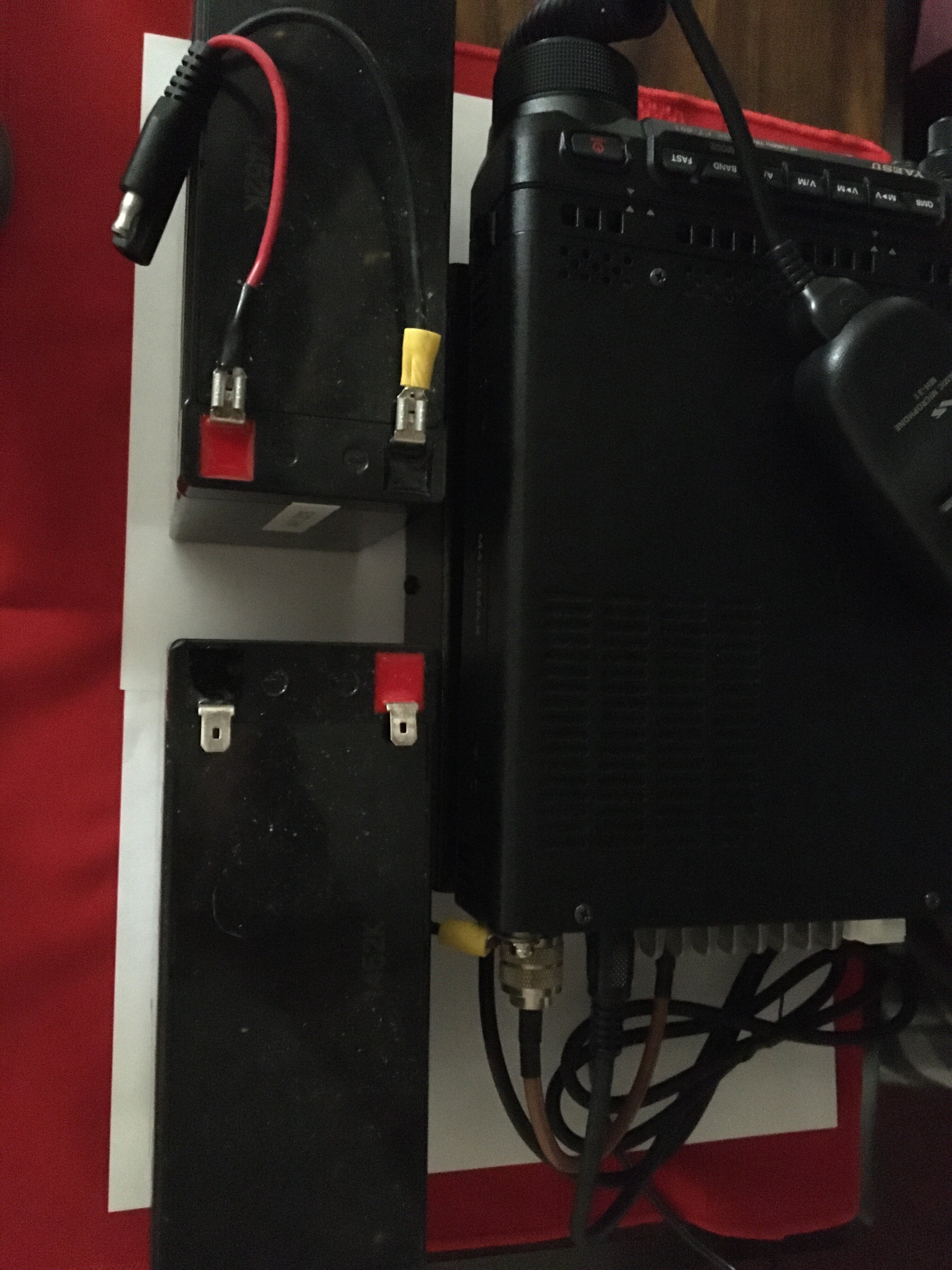

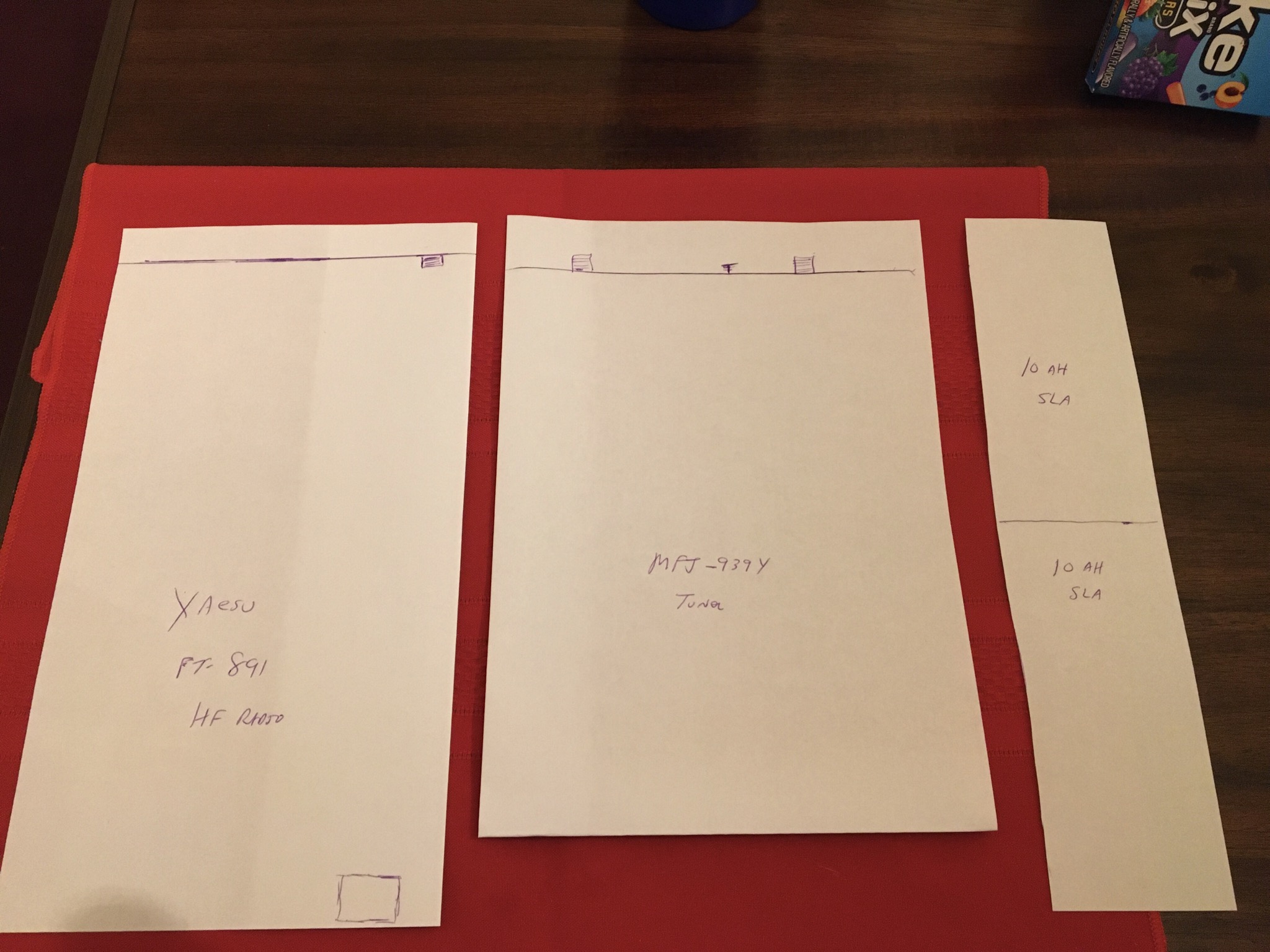

Here is a mock up of the 4800 case (the bigger one noted earlier). I ran out of red. But the 2 batteries on right hand side are within the interior of the case measurements.
Thinking I will detach the head since the box is 6 5/8" deep and set on top of the foam or something. Keep the VFO knob further than the 3/4" or so I got on the front edge.

Well I found a 25% off coupon that was expiring at midnight yesterday. I ordered the 3800 case I did the first mock up with. $37 shipped with taxes and all. Also looking at Anderson Power Poles and such for this project. Should make connections quicker.

I would rewire the pigtail connector (and obviously the radio connector too) to have the POSITIVE lead be inside the rubber insulator and the ground be on the exposed metal pin.
YMMV

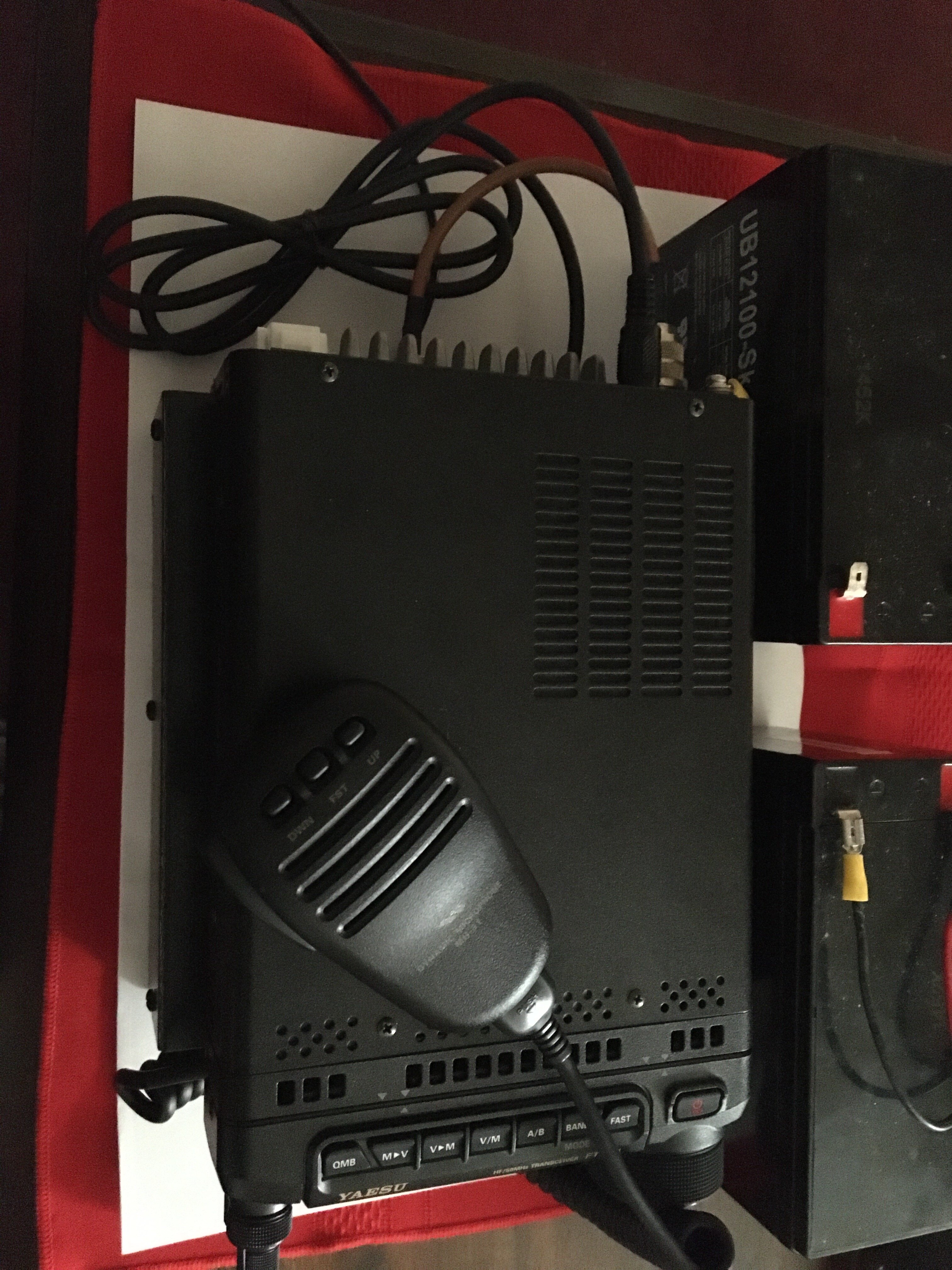

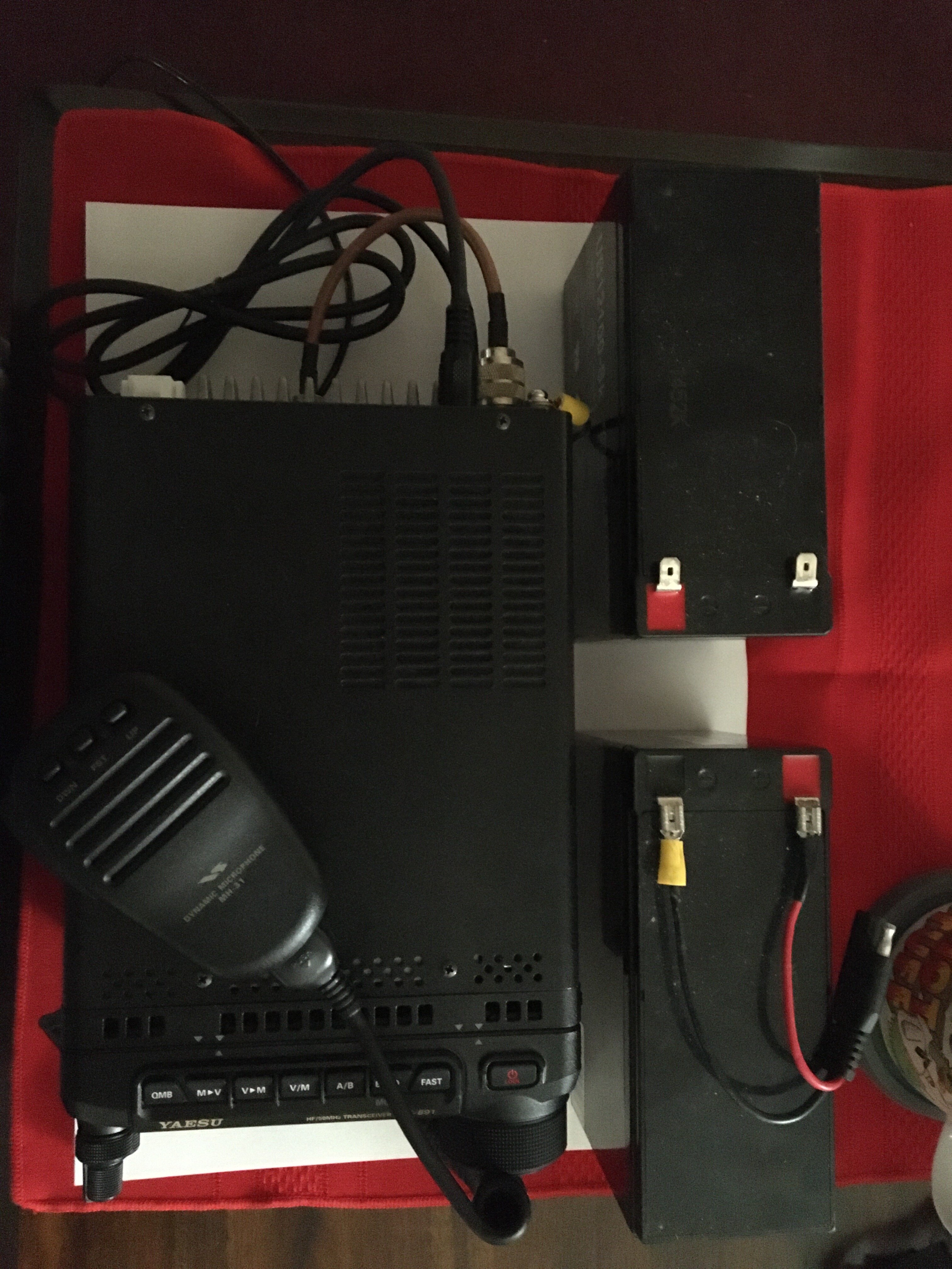

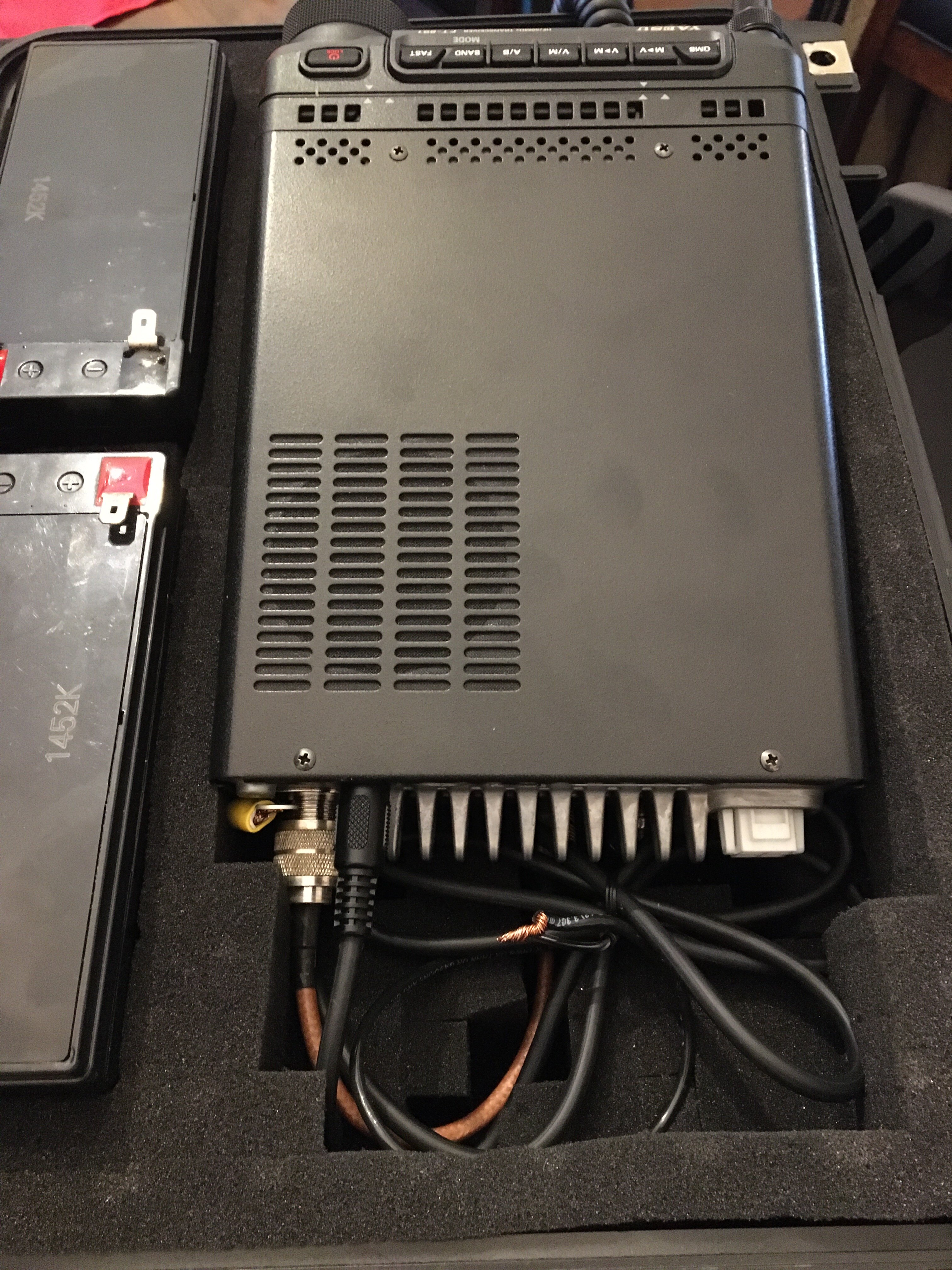

Pic 4 and 6 will be the in use pic. Pop up the 891 and start transmitting.
I will be disconnecting the radio DIN during transport to avoid damaging it.

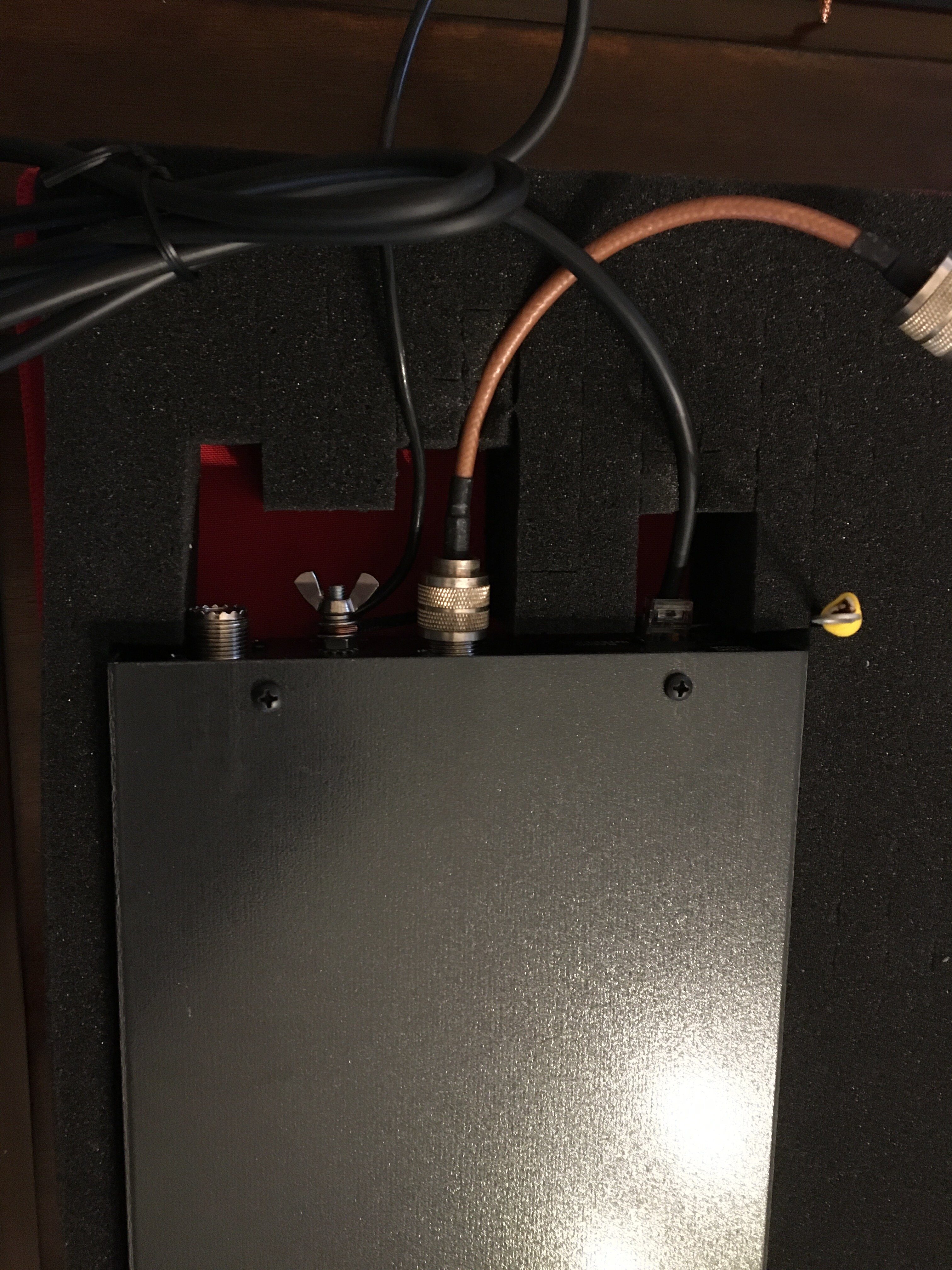

Mic drops in that back area pretty well and case closes fine. (Last picture) Had to cut the eggshell part to prevent crushing the mic cord too much.
Waiting on power pole wiring and jack. And the S0-239 passthru connection.
