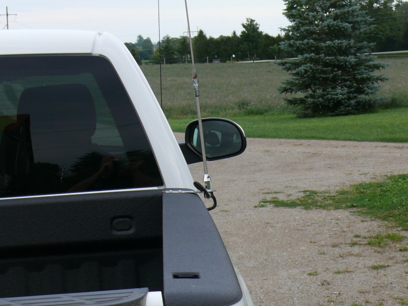

On my old 05 Sierra I ran mag mount for a few years, then drilled the hole. I ran a Wilson 5000 with power (Texas Star DX500) for years. Now on my 2012 Sierra I have a whip mounted off of the side of the box. Way better performance with the whip.
Hey Binrat I responded to your email.....well I am not sure I want to drill a hole yet in the roof, but mabey off the side of the box I will look into that. I dont use the mobile too much but I do want it to work well.
I'll say from experience that if you don't ground things right and mount your antenna In the right spot you will have fun dealing with the issues lol. If it was me I would pick mount it and ground everything well and buy a quality antenna and coax and upgrade your alternator and be done.
Damm you Doc, you make things sound easy.....but yes thats the way I might go or a 102" off the rear bumper....I have about 4" of lift on the truck

Here is my 102" whip on the edge of the box.
