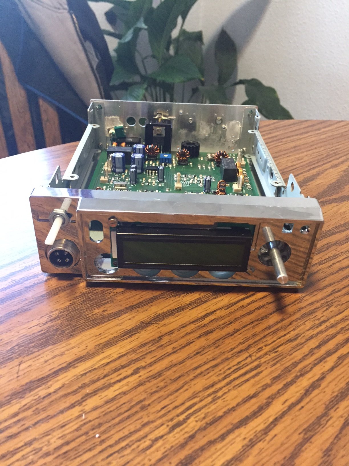

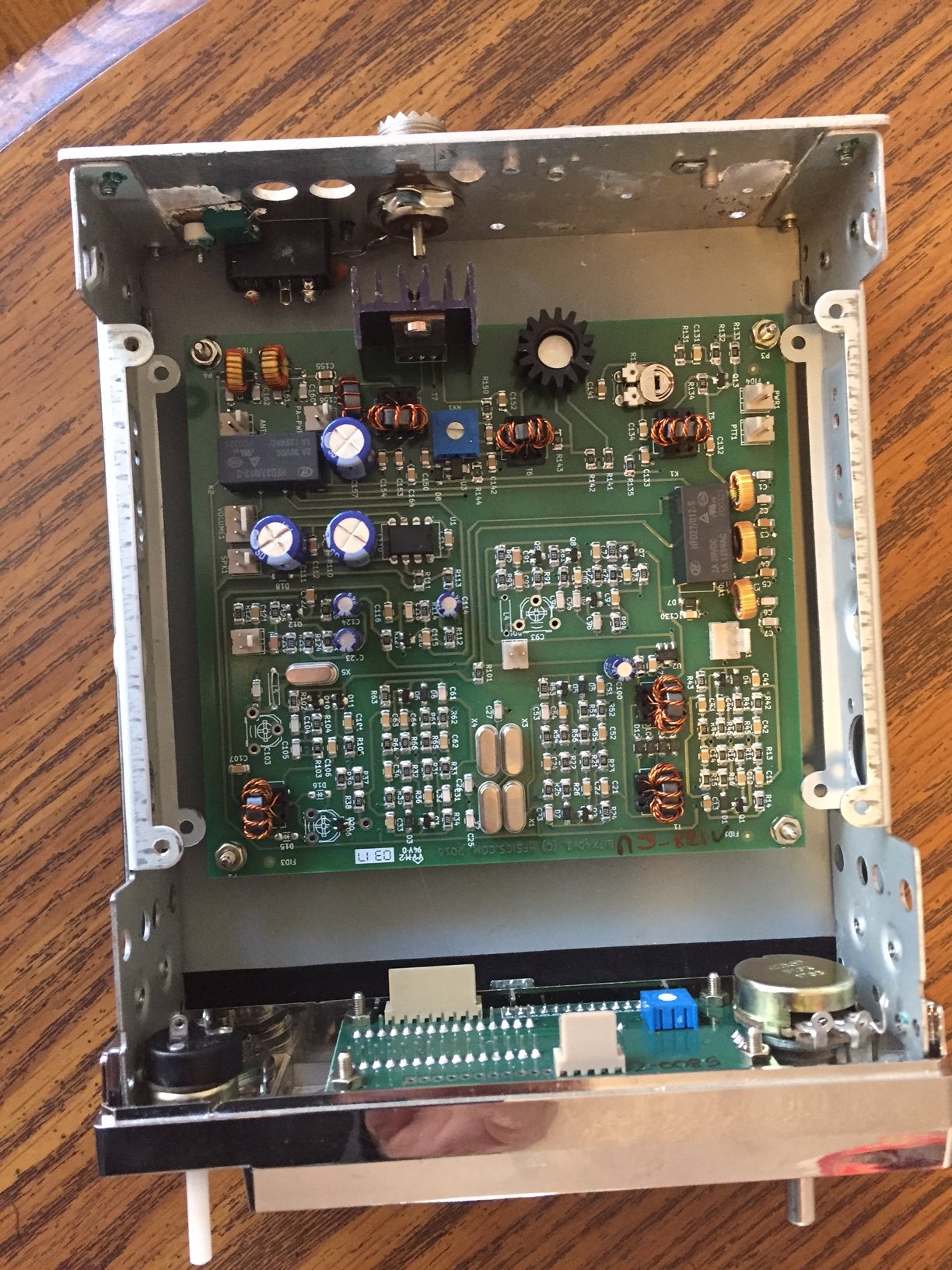

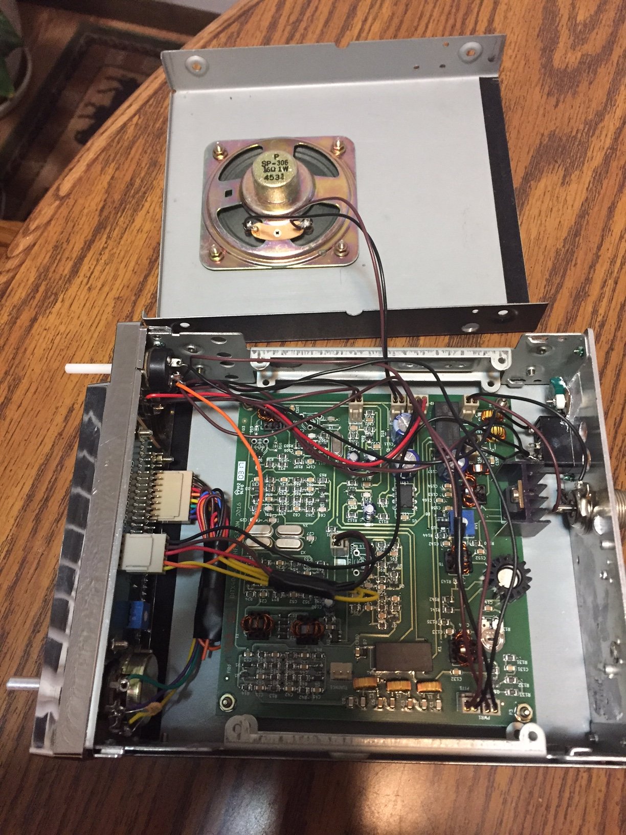

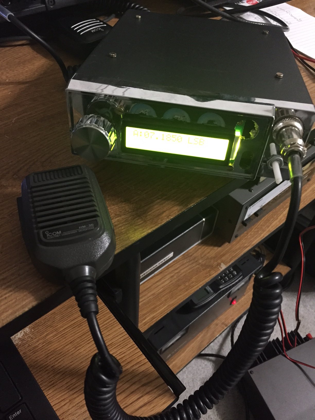

firerunner was on the chatbox talking about these a couple weeks ago so I ordered one also, was surprised to see it in the mail yesterday, so I started working on it, $59 with free shipping from INDIA , I used an old cb case to mount it in, just got it fired up and it works, I was receiving cw and phone with just my roll of solder touching the antenna jack,lol,, need to make a faceplate yet, and wire up the mic for it

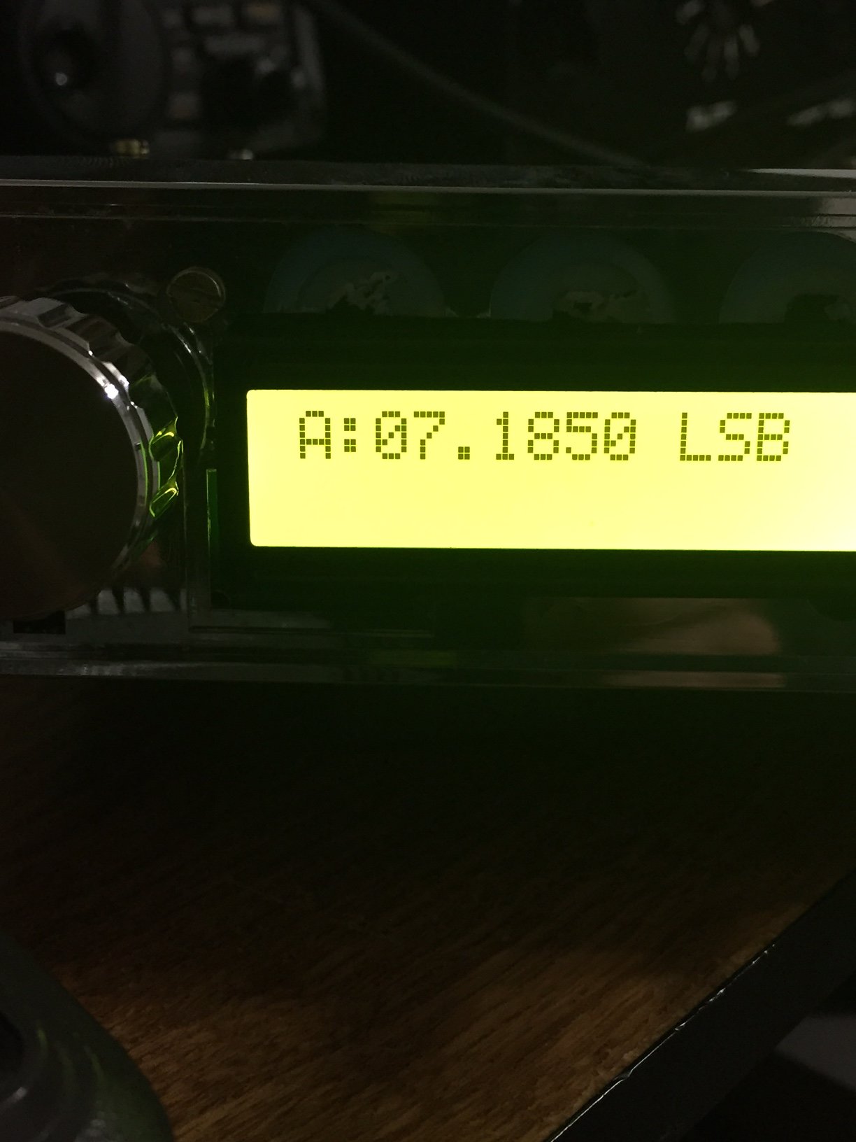

I hooked the bitx40 to my 80m doublet fed with 600ohm true ladder line, with a Johnson matchbox and had no problem making contacts with it, even got a contact in south America. mine does a solid 4-5 watts pep with the icom hm-36 mic,, the receive is great, the radio has a calibration option, mine was off about 200hz but after doing the calibration it is dead on frequency. the tuning is a bit tricky at first, the tuning pot only has so much range so when you get to the stop the frequency will start to auto-count up or down depending on which way you turn the vfo then you just turn the opposite direction when you go past your desired frequency, pretty simple when you get used to it. the board doesn't have any memory for what frequency you were on when you turn the radio off then back on, seems to just pick a random frequency when you power it up, not too big of a deal. all in all a great radio for the price and it just plain works!
