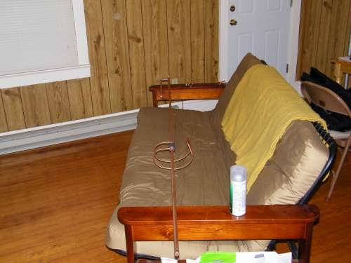

I would like to submit the following as my contest entry. For now I have created a pdf file with notes and some instruction on what I did to make the Cactus Super J-Pole. As soon as I get it all completed and operating I will add more pictures. Below is two pictures of the main antenna ready for Clear Lacquer Finish and then Final Assembly.
The Antenna is a Cactus Super J-Pole for use on 2 Meter and 70cm. I will post how it works once I get it operational in the next few days.

The Super J-pole or extended J-pole or whatever the name is works fairly well. I built one several years ago using 3/4 inch copper for the bottom and 1/2 inch for the top 1/2 wave section. I was surprised it tuned so well. I could see a slight difference over a vertical 1/2 wave dipole so it does have some gain. Your project looks good but it will look better up in the air. (y)
