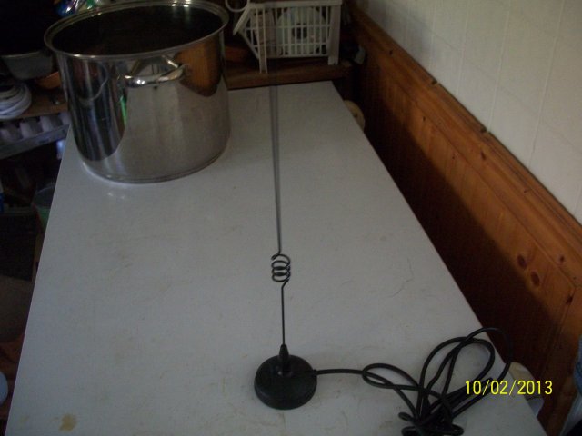

Can anyone tell me by the pic I uploaded if they think I may harm my ht with this antenna. I don't have one yet, but found this one in my old stock. Thanks in advance.
Rocky
P.S. I will be using it for a Yaesu VX-8GR And a Yaesu VX-8R, if it won't harm my rigs.

HT's are pretty good at working into weird SWR. The duckie antenna they come with is hardly ever a great match and with the antenna being held in different positions and in differing proximity to the body, inside a car etc the SWR varies wildly. Plus the power is low too. That being said I would certainly prefer to check the SWR when using any non-stock antenna. My big question is if the antenna you want to use is dual band or just 2m. I am guessing that since it appears to have a PL-259 connector on it that it is at least a 2m antenna and not a cellular antenna. As for 70cm......:confused:
Reactions: 1 person

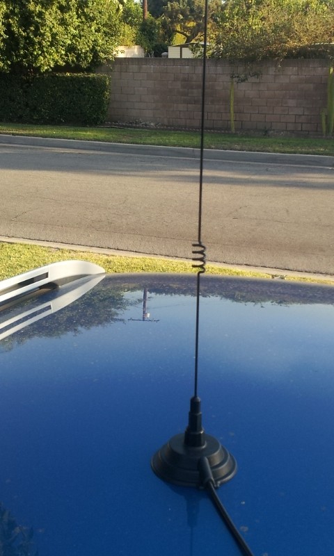

Looks an awful lot like the $25 MFJ dual bander I've got on my HT/Car at the moment. The whip extends 16" out of the coupling nut. Works "okay" as a temporary set up until I get a V71 and Comet 2X4 installed. SWR's under 1:5 on 2m and under 2:1 on 440.
Actually if my memory serves me correctly, I think it was a cellular antenna at one time. I ordered a dual band several days ago, just haven't got it yet. After this thread, I noticed a bad coax so I won't take any chances. Thanks everyone.
Rocky
KD8ILS
Reactions: 1 person
