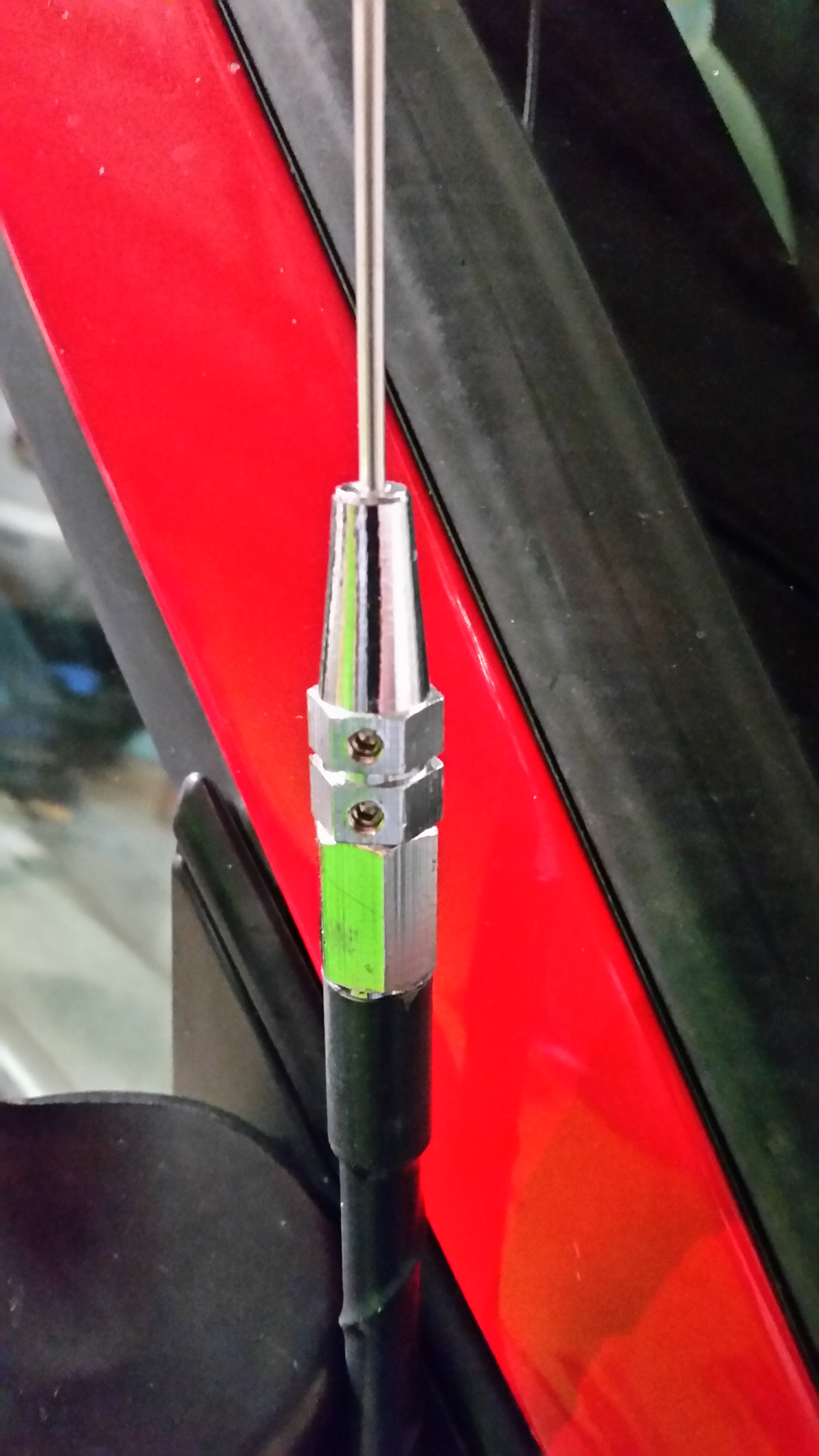

    I won some antennas for mobile use from eBay. Well I guess win might be an over statement since there are parts missing. The mount for the stinger is missing on four out of five antennas. I don't want to give the seller any grief over this, but it does make four out of five antennas useless. I just want to find these premade and chromed. I could make them but they would not be as pretty as store bought. I can do PayPal!
    Any help would be appreciated.

    I would venture to guess you can order them from MFJ, they look to be the same thing they use for the Ham-stick clone.

    Google whip antenna ferrule. There are three different sizes for different size whips. They are an AS-1, AS-2, ans AS-3 ferrules. Lots of places sell them. They should all have a standard 3/8-24 thread on the bottom.

    That's what they are called. It was totally escaping me

    That is the problem I was having. Stinger mount was what I first called it.
