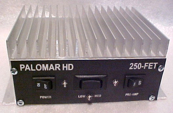

I was giving a nice Palomar HD 250 FET amplifier. I haven't connected it up yet, but I was wanting to know what kind of power should be expected out of it. What do you guys think about this amp?
High drive amp that will work with a 10m export mobile radio, class AB bias design, and you got it at the right price. Just don't over-drive the amp's input with too much power output from your 10m export radio - and it should run fairly clean output. Drive it until you see about 200 watts PEP on SSB. That should be an efficient power level for the two ERF-7530 MOSFET devices. Same goes for the output for AM use. However with FM - adjust the radio output until no more than 40 watts output from the amp . . .
