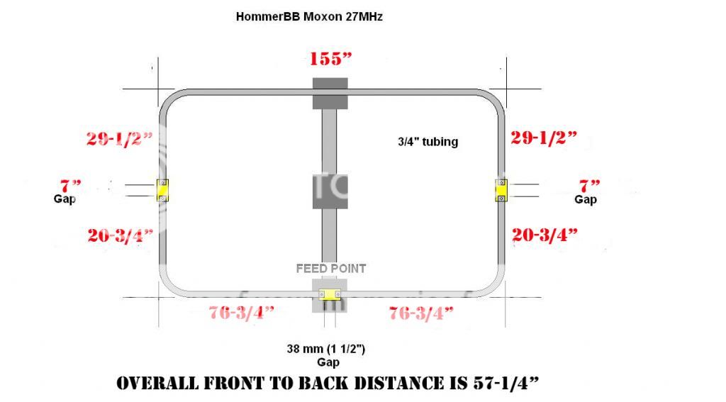

Here is what MoxGen says I should have done with the 3/4" tube to be resonant on 27.385
There is an attached zip file with the EzNec file zipped in it. It was generated by MoxGen as a free space model with zero wire loss.

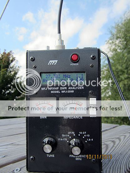

Marconi, here is the 259b readings for the antenna as I built it:
Then I changed them to the ones in the lowest graphic:
Looks pretty close to what my Eznec model predicted for your original model's resonance. My readings are at the feed point, plus I made my model's tubing all .625" inches diameter.

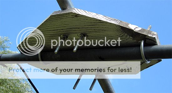

Some homebrew construction details for this Moxon.
Any of the materials can be substituted with higher end more expensive alternatives, however, bear in mind my consistent practice of using common, inexpensive materials and processes to put a effective antenna together. This I do to show folks what is possible with an active imagination, a will to overcome materials obstacles, and a limited pocketbook.
Mast to Boom Plate

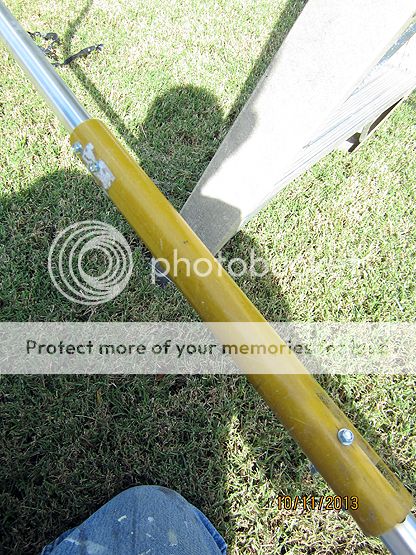

Side Element Insulators

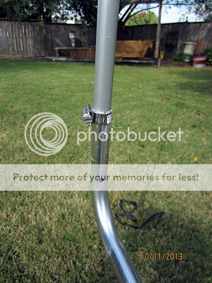

Element Corner COnnection

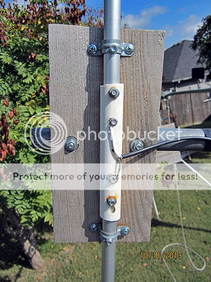

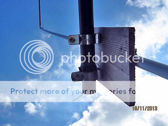

Direct Coax to Antenna Feedpoint

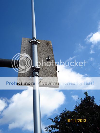

Underside of Element Mounting Plate
Top of Element mounting Plate

Thanks for the pics! Been wanting to put up a small beam because of my limited space. So you did not need a matching system? Just direct feed the coax? What did you use for side element insulators? ( the yellow material?) Do you like it as well as your 2 element quad? Think I read some where in your previous post about the that this antenna will work good at 19 feet? Sorry for all the qiestions. Just don't want to waste time putting someting like this up. Thanks again for sharing!
It is roughly 13' x 5' - small for 11 meters
That's correct.
The yellow material is fiberglass tubes, a shovel handle, but I have also used PVC tube.
This question begs different considerations for each. Let's just say this one has the most advantages due to size, weight, ease of use, less maintenance, potential portability, and superior back door rejection. The 2el quad makes me feel happier.;)
Think I read some where in you previous post about the that this antenna will work good at 19 feet?
It has for me, but there can be extenuating conditions for such a low install - what is near by, what does it need to clear, soil type, on a hill or in flat country, etc - but that may mean less than how well it works at that height compared to other antenna types you've mounted at your place at that height. I have found it does well there, but as with any other install, higher is generally better.
You won't waste your time with one of these. They are a smart choice.
