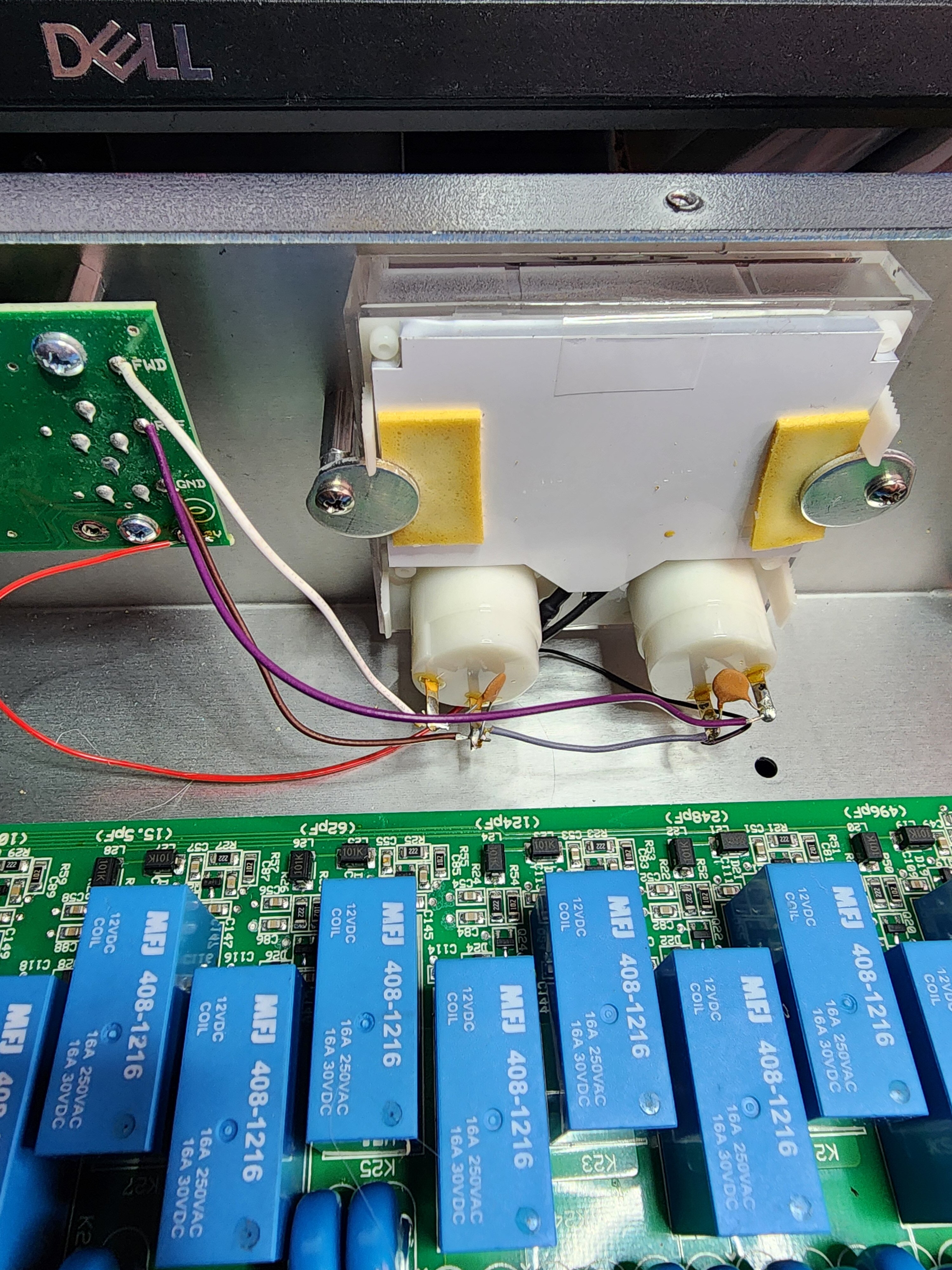

Could someone take a picture? of their wires leading the the analog meter.
here's what I have. pic attached

When I transmit an SSB signal my 998 shows my output at around 19 watts but I'm actually putting out just below 100 watts from the ICOM 7610.. In all other modes the wattmeter on the 998 is pretty close to being correct. I don't use the wattmeter in the 998 since it's not a PEP Reading wattmeter. I use a Autek WM-1 for the output power & SWR readings. The MFJ 929 did the same thing when I owned it so it's not an issue. They Both showed the output on AM as going Backwards but the WM-1 shows forward so I'm good.
Thank You I have given up on it. and Its amazing that MFJ would say the wires are backwards did you check it? and if they are not then the diode's backward LOL

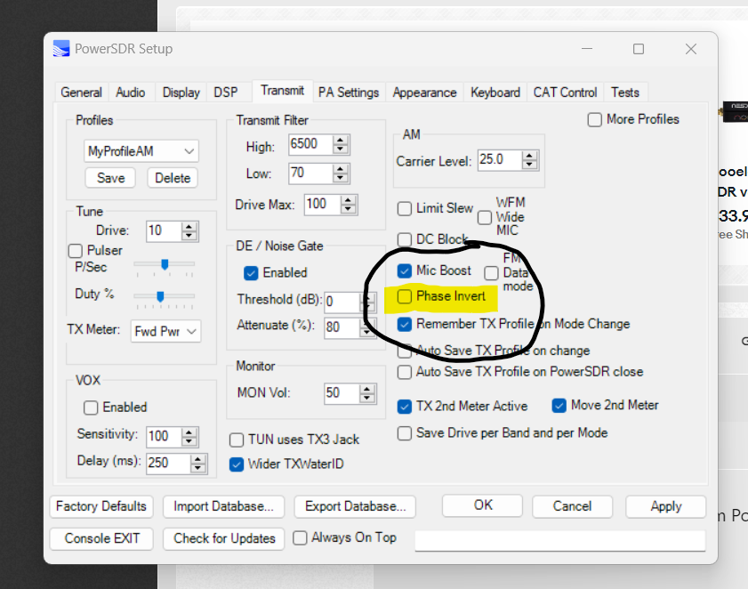

How / Where are you setting Mic Phase?
Not sure what you mean.
I have a Flex 5000a with a Studio Phantom Powered mic attached to the front of the radio and made sure Phase Invert was unchecked. (pic attached)

Your previous posts never mentioned that you were using this type of setup, so it was a bit of a mystery. Try Inverting the phase and see what happens.

Sorry, I Thought I replied. Yes Phase Invert is unchecked in the setting of the Flex 5000a software.
O I did reply, it's above. I did check, it and had the same problem.
