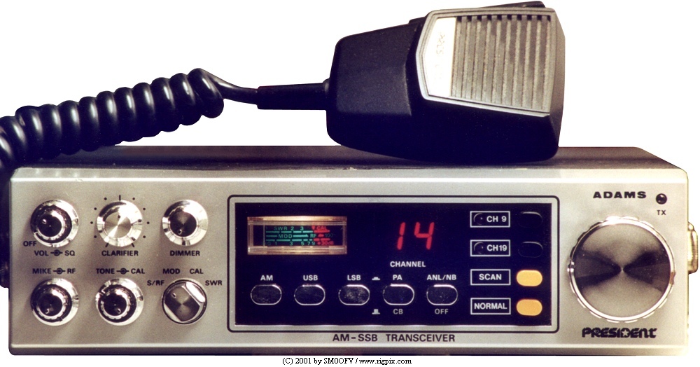

HI FOLKS :D DOES ANYBODY KNOW HOW I CAN EITHER OPEN THE CLARIFIER TO SLIDE ON TX OR PUT A 5 KC FLICK SWITCH ON MY PRESIDENT ADAMS?? IT HAS THE 858 PLL & HAS HIGH BAND FITTED ,CHANNELS ARE A BIT JUMBLED UP ON HIGH BAND (CH16 IS 27.555.) BUT THIS IS NORMAL AS IT WAS FACTORY FITTED. IT ALSO HAS THE REGULAR FCC BAND. I HAVE HEARD THERE IS A MOD OUT THERE, JUST CANT FIND IT :? IM AFTER DOING ONE OF THESE MODS SO THAT I CAN GET THE INBETWEEN CHANNELS (ZERO'S) ANY HELP WITH THIS WOULD BE MUCH APPRECIATED!!! CHEERS,SHAUN. :D

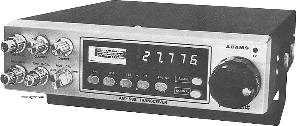

I really like those Adams :) Does yours have the freq counter ?

could be ,ad reads modified by Muller Electronics in Germany in 1979 , it has a VFO on the big knob that moves in 1khz steps other then that , the same radio ,before freq mod the radio would go from 27.775 to 29.775 also is a very large mobile at 19inches by 19inches , AUH YES !! I sure remember those Gladiators :)
HI SWITCH KIT & THANX FOR THE INFO GOOD BUD! :D MY ADAMS IS JUST THE NORMAL CHANNEL READOUT MODEL, I HAD SEEN THAT PIC OF THE FREQUENCY READOUT MODEL ON RIGPIX.COM, NEVER ACTUALLY SEEN ONE FOR REAL THOUGH. WELL I COULD DO WITH A BIT MORE INFO ON HOW MUCH SLIDE THIS MOD WOULD GIVE ME??? I GOT MY EARS A LISTENING FOLKS!! :D CHEERS,SHAUN.
