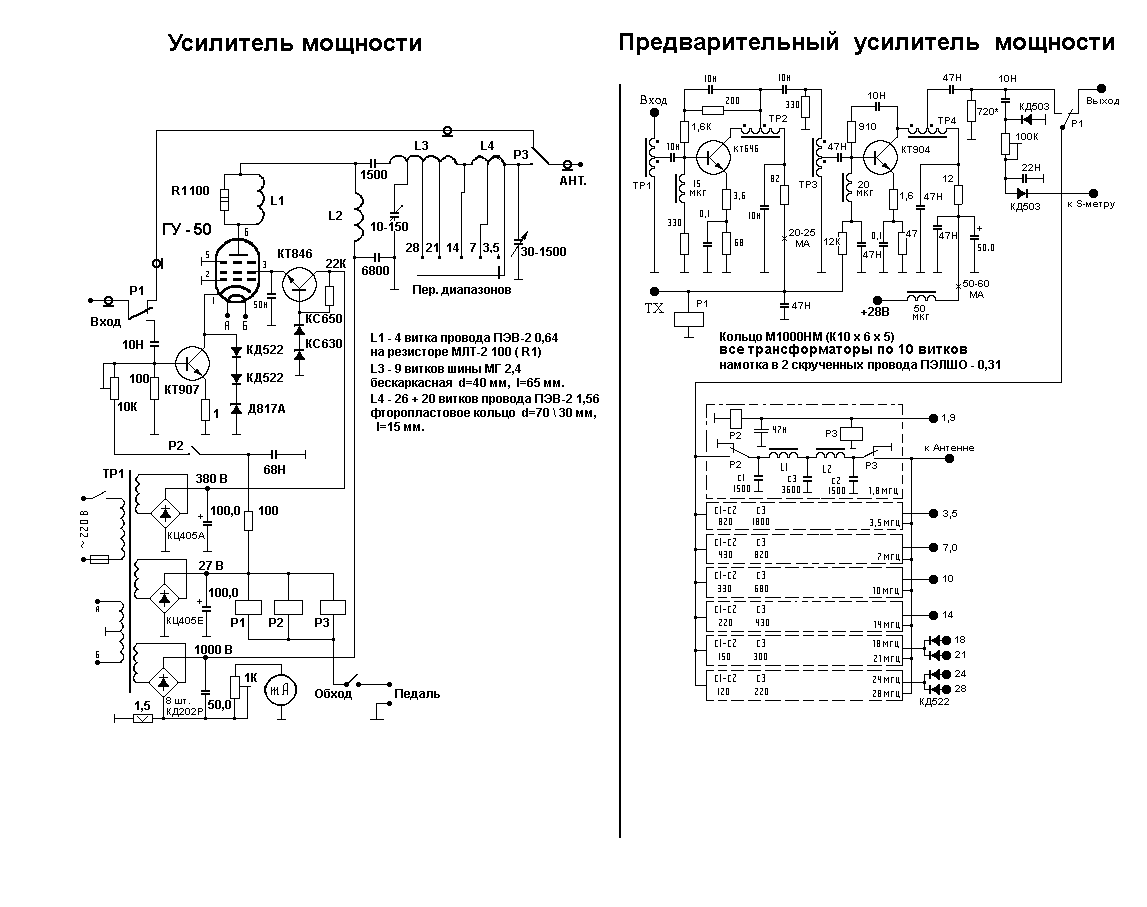

Is the input circuit around kt907 for impedance matching?
Decided to rework my amp project into a mono lowband AM transmitter with modified heising modulation with a toroidal transformer. I would rather use a grounded grid scheme for the gu-50.
