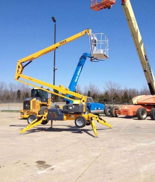

The pull behinds are fine to around 40-45 ft used them many times.
Extra support under the outriggers is a must in the dirt. (4x8's) work well. On concrete they are fine.
I rent them for like $150-200 for 24 hrs. About $300 for a weekend(Fri-Sun).
