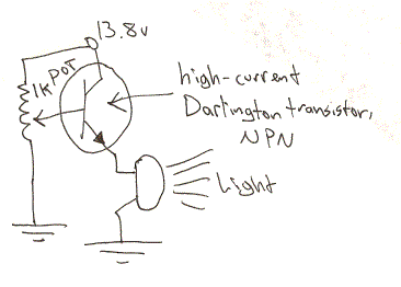

Use an emitter follower circuit, or better yet, a pulse-width modulator. You can control the brightness all the way from off to max, with no smoke signals. I modified an old trolling motor with an emitter follower to get a variable-speed control. Works very well. MAKE SURE you get a transistor rated for at least 1.5 times the max current the light will draw, and mount it to a large heatsink (any good-sized finned chunk of metal will work, in most cases)
