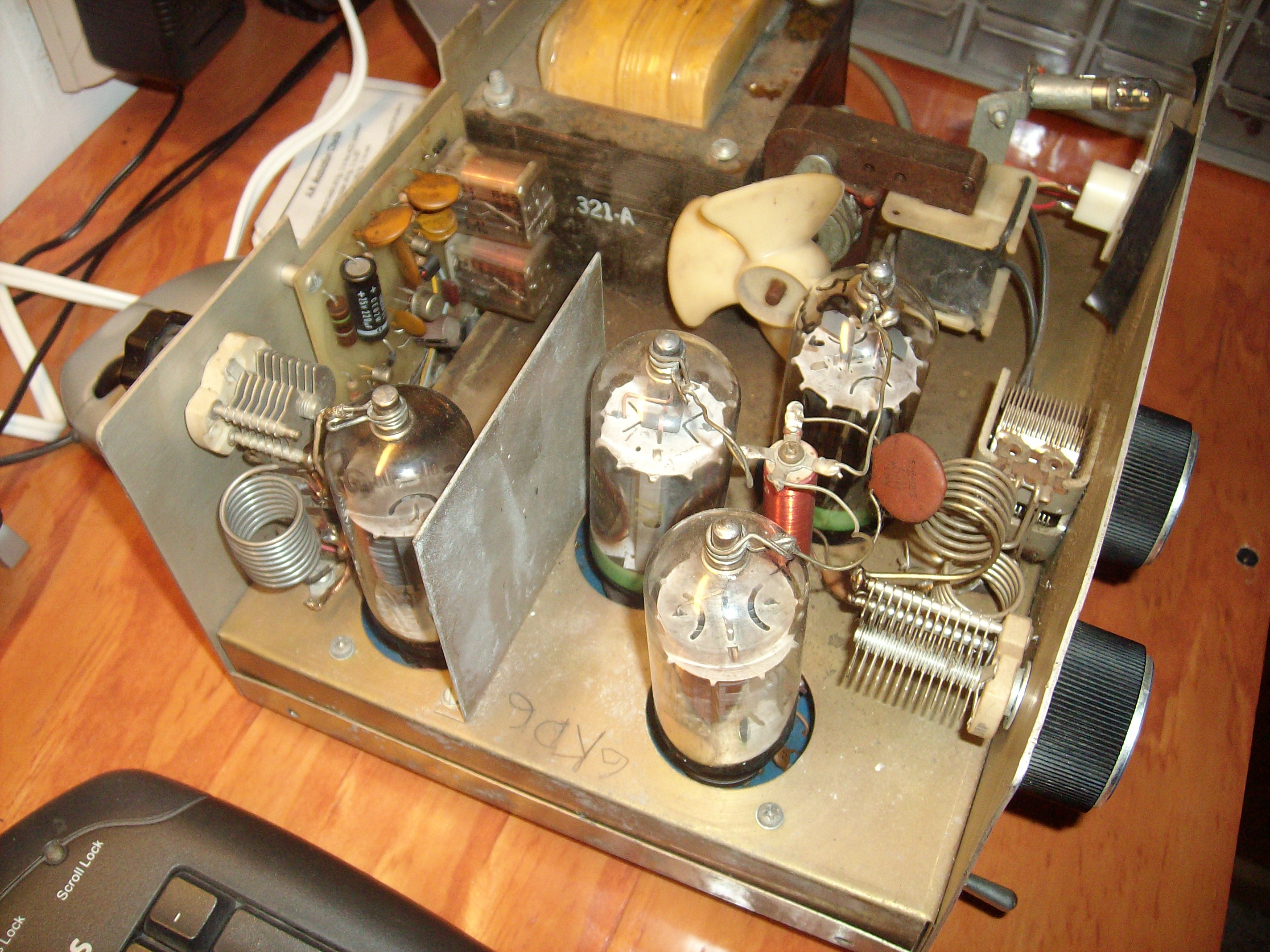

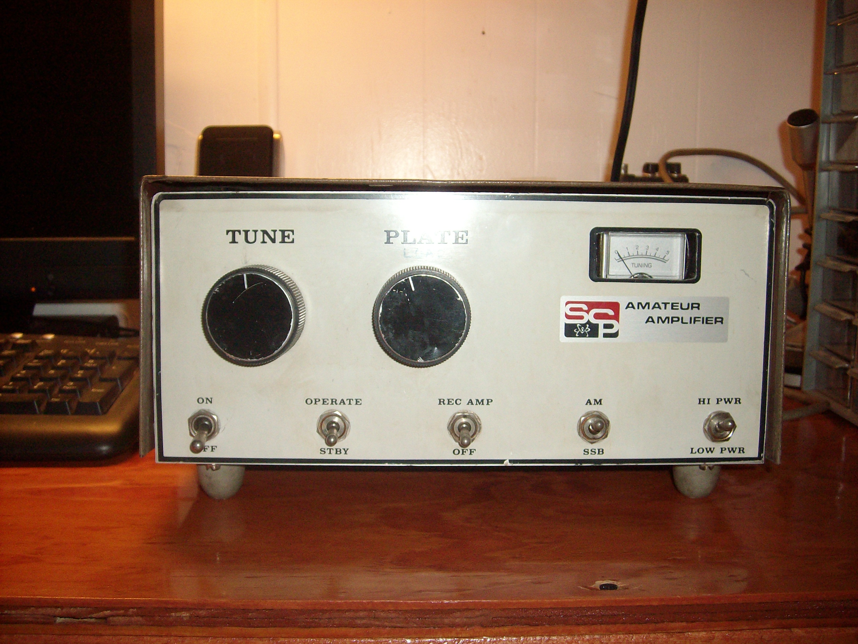

I was told this was the skipper 300, but it is not! the skipper has 3 relays and this one has 2. and this one has the 6LX6 tubes in it. It says SCP and I cant find any info .. it has stopped keying up and I feel it is to do with the 2 relays on that small board.
here are what pics I have
It is hard to tell from the pics, looks like a Firebird that I have seen.
The keyer circuit is probably that metal can top hat transistor, 2n2905 (guessing from the components around it.) Does the pre-amp still work while in stand-by?
well it was all working, then it started to stop keying, I would just turn the rec on and off and it would work again for a little while... then after doing that for a few weeks , the rec and the tx don't work any more. the tubes all still light up they are 6lx6.. but I broke one the other day pulling it out.. the relay do not click at all. tried cleaning them, but still no go.

Start at the input coax and trace the RF input until you come to a 10 pf capacitor, this is the capacitive link to your keyer circuit. On the other side of the capacitor, there is a diode and a choke and a PNP transistor (2n2905). There could be a problem with that circuit.
Also, there is a diode that rectifies the AC to provide the DC to power the relay circuit. That voltage goes through the Standby switch. Make sure that you have 12 volts on both sides of your relay (this show that the power supply is working and that you have continuity through the coil of the relay. No 12 volts means PS is not working or switch is bad.
If, there is 12 volts only on one side of main antenna switch relay then that means that the relay is bad.

YUP thats it.. except mine don't have the little legs and original fan, and has the 6lx6 tubes. I wonder what the differance in tubes are? I would love to have it fixed , but there is no one in Central NY that will touch it.

Most common problem with the keying circuit is the 2n2905 keying transistor. Sometimes a 2n2904 will work, but you would have to figure out the differences in the lead positions.
If you replace the 6lx6's with 6lf6's, replace all the output tubes at the same time. Keep the best 6lx6 for the driver tube.
And be CAREFULL, the tops of those tubes can bite you big time. Turn the amp off and short out the tops of the tubes to the chassis to make sure the power supply caps are discharged first!

I got 4 new 6lx6 tubes in it. just put in a new 2n2905 keying transistor, and still nothing, no rec and no transmit, now the rec relay when moved with a pencil dose make the rec work.. but when moving the transmit relay it don't key up?
Update
Well I replaced the 1n4001 diode and it worked, and was working for a while. now it stopped again.. not the diode again, I think I cooked it? I was putting a receive kit in my general grant, and had it hooked throught the amp. amp wa turned off and in standby, didn't think it would hurt it , but I guess it did.. have no Idea where to start, no pre amp and no tx..
