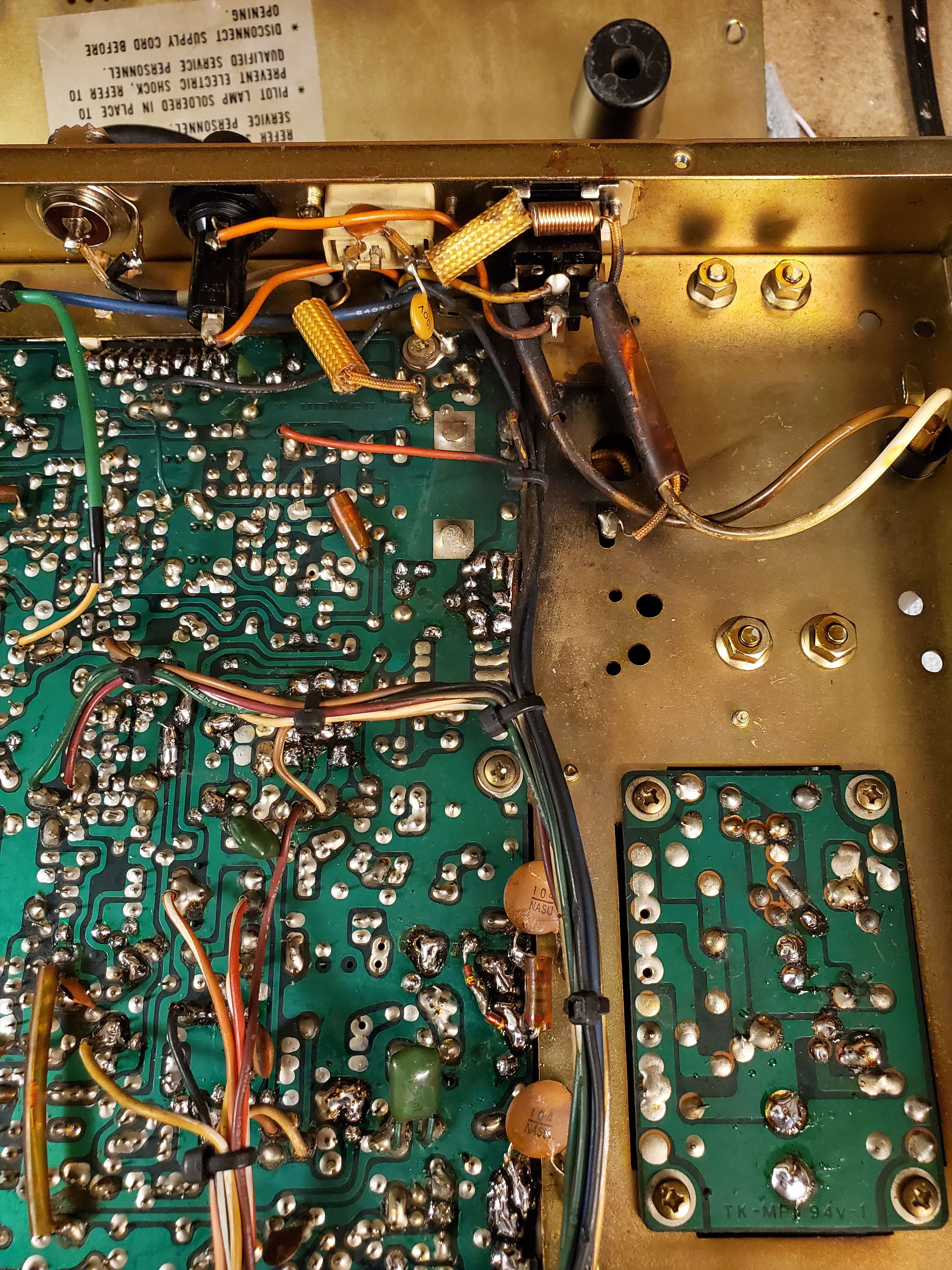

This pic was after I had scrubbed on the underside of the chassis for close to 2 hours.

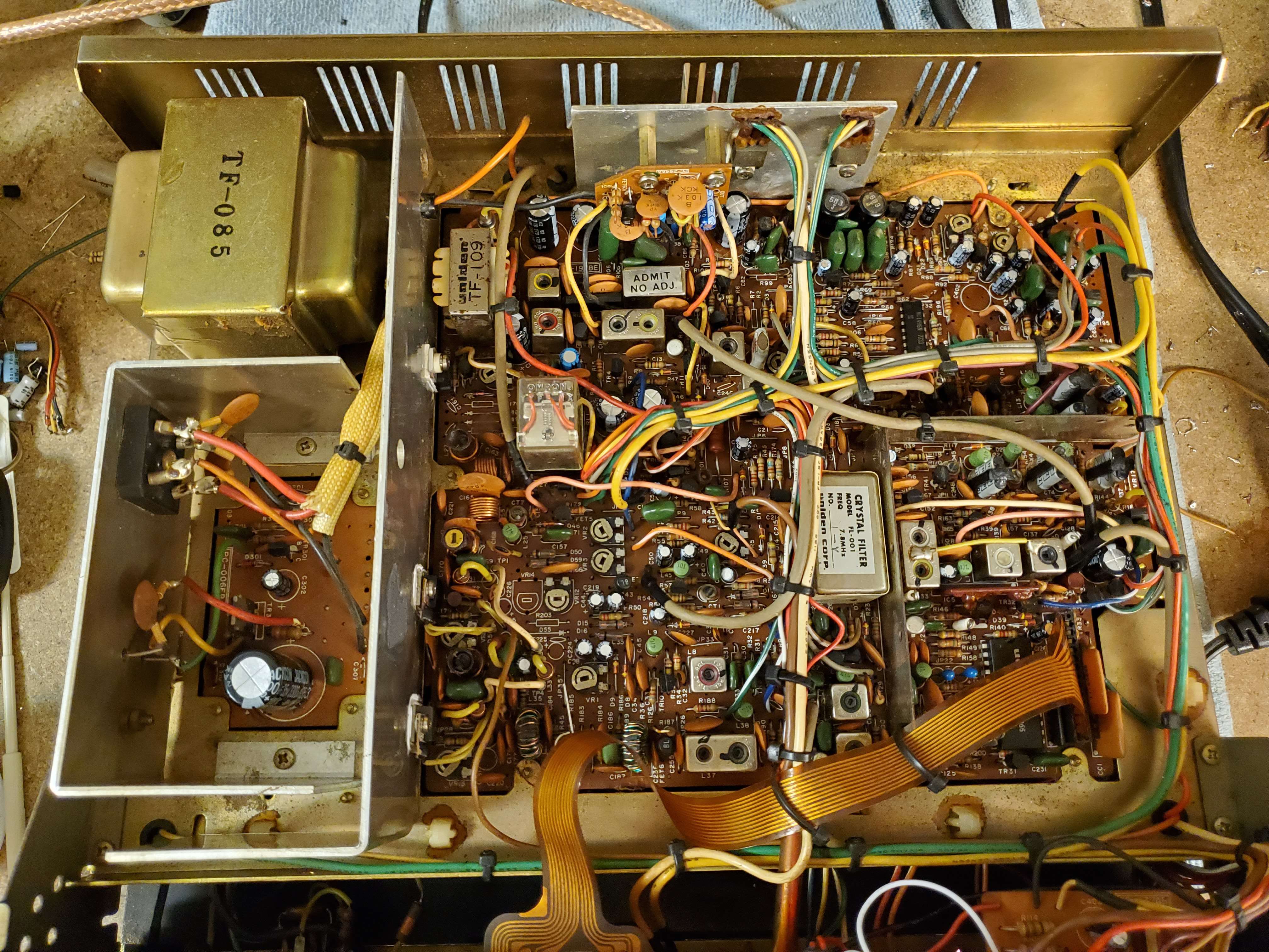

Top side of the board.

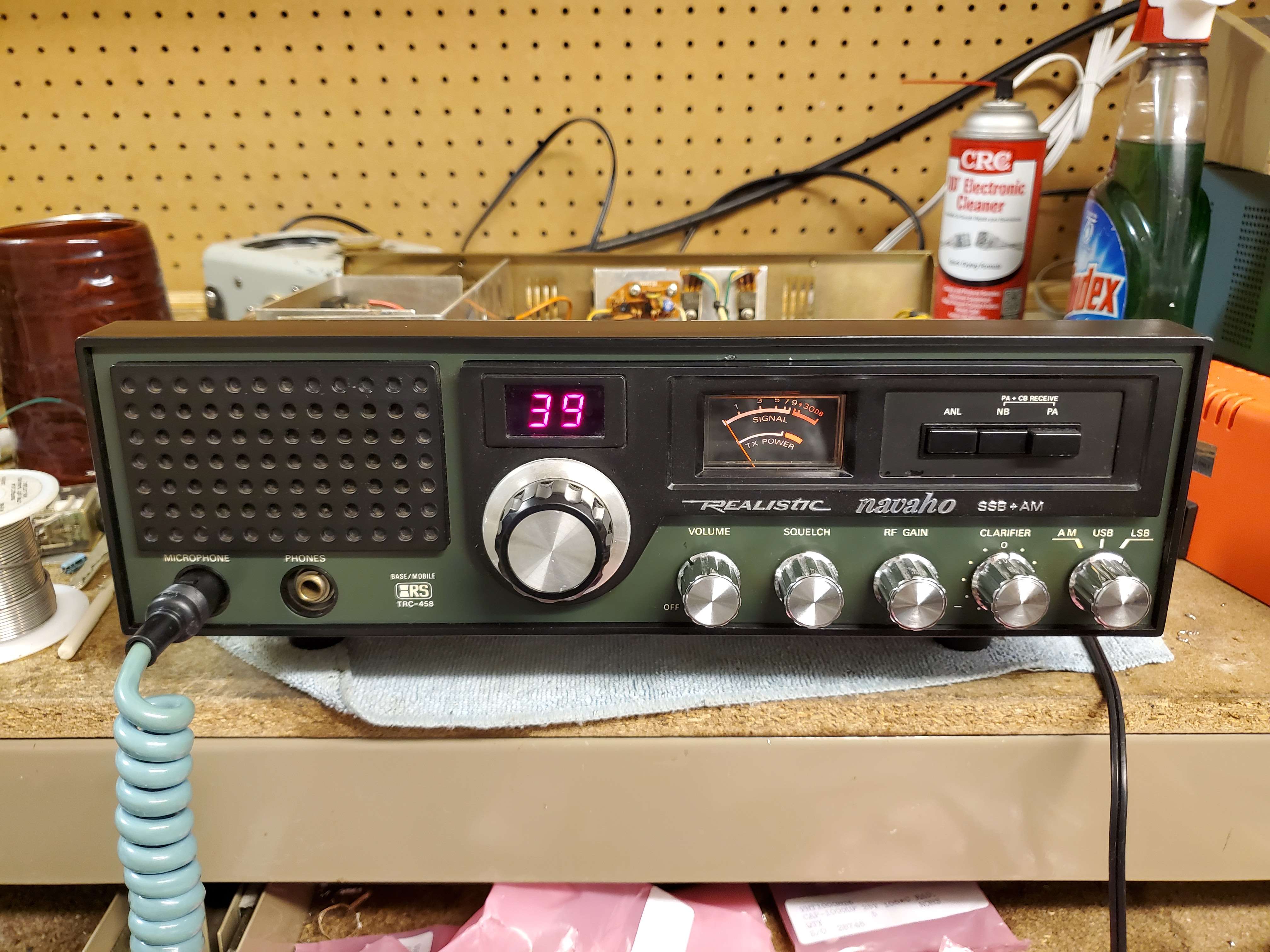

Front of the radio.
