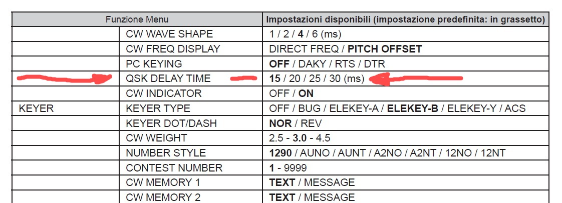

I am able to set the TX delay to 20ms on my Flex 6600M, but nowhere in the menu, on forums, or in questions posed to YAESU, DXE, Flex, 403A have I found this setting for the FTDX-10.
This delay is required to operate the Genius TGXL and PGXL.
Does it exist - and if so - where? Or, if there is a delay already set by the radio - what is its value?
