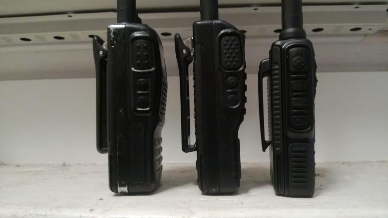

    Like I said, it's little. I thought the FT-250R was little, compared to other radios, but the VX-8DR fits nicely in the palm of my hand. The following picture shows the size comparison. The antenna (without the stubby) is similarly sized with the FT-60R's stock duck.

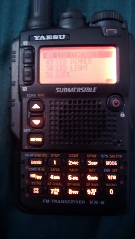

    Let me start off with my experience with the menu. I don't understand why people consider it difficult to understand. By holding down "MENU" for half a second, an extensive list of many (111) self-explained options is displayed. I'll show a shot of this after this paragraph. Saving the settings after changing something in the menu is annoying, in the sense that different menu options use a different button to save the setting you just changed. Yaesu should have made it that one button is the universal "save changes" button, instead of making different menu items use different buttons to save the changes. I just received this radio a couple days ago and after reading the manual (~40 out of 180 pages so far), the settings were learned pretty quickly and were easy to remember, but I'm sure I'll have to look at it again a few times before I remember it all. It's not nearly as difficult as what I've read from others, in my opinion. The audio output was low as others have stated, but I noticed that doesn't happen on all frequencies, especially when in "Mono" mode (not dual-receive). I put the volume all the way up and while some frequencies were still low, some were insanely loud. Tip: Those low frequencies sounded better when put in mono mode (taken out of dual-receive). This also goes for noise/reception. If the RX quality was a bit noisy, I took it out of dual-receive, putting it into mono mode and it sounded fine. Obviously, listening to two at once will compromise RX quality a bit on each. I must admit I enjoy being able to listen to AM/FM broadcast as well as 2 frequencies at once. It's also really easy to do, which is nice (you just press FW + 7). If you read the manual, you'll get the basic gist of how the device's settings and key combinations work and figure out quite a bit on your own. It seems really easy to get used to for me and this menu is nothing like the previous Yaesu models I've been using until now.
