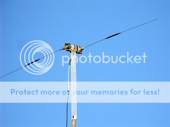

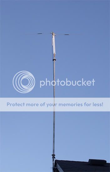

Nothing special here, but thought the idea deserved a photo.
As has been done before and started this thread, two mobiles as a dipole. Good SWR across CB band. Doesn't have the ears of the full-sized Omni I run, but it does work. I've made both local and DX contacts with it. I made it for a small travel dipole to use if a larger wire one is out of the question.
