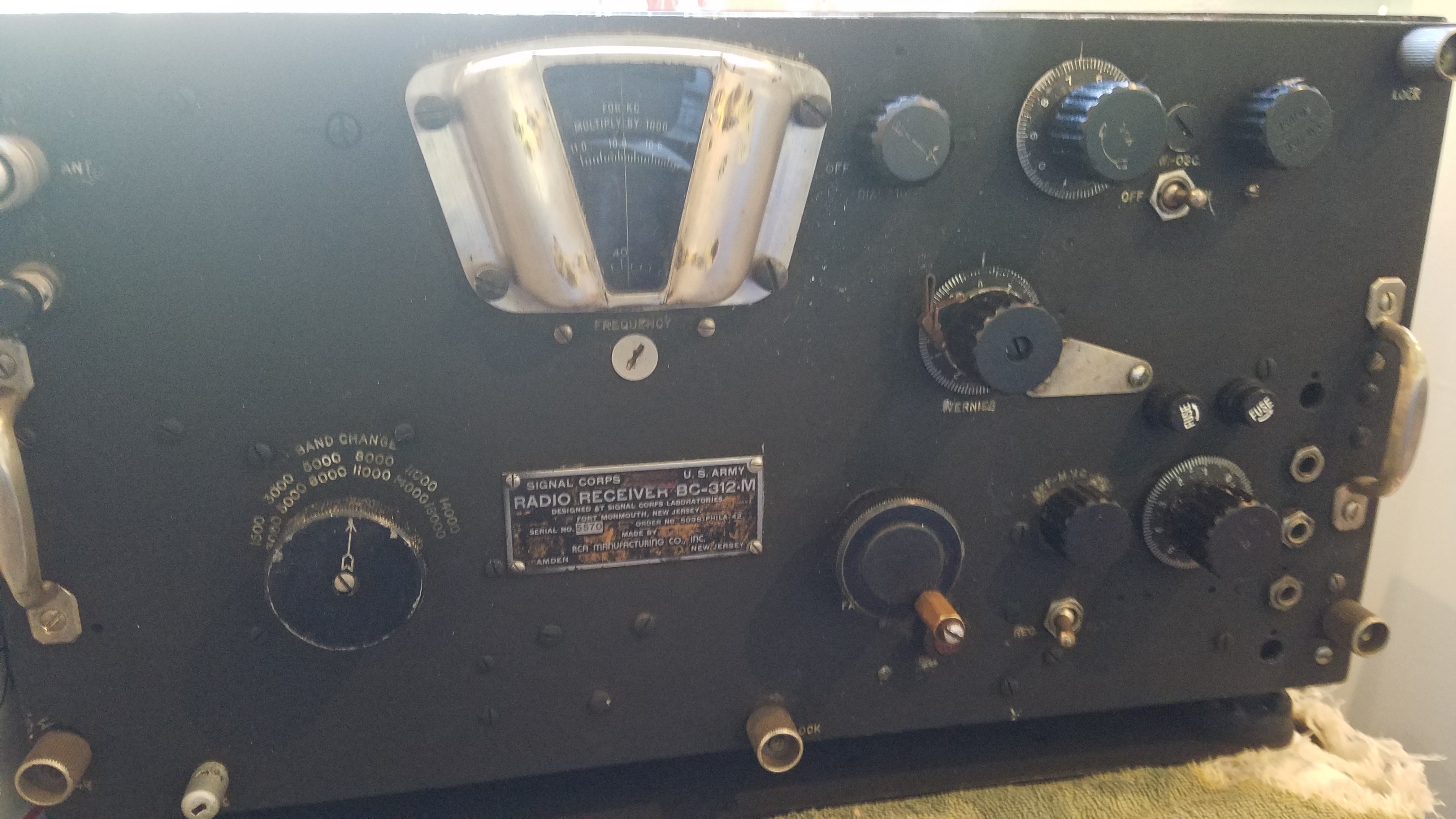

Bc 312 m army signal Corp radio

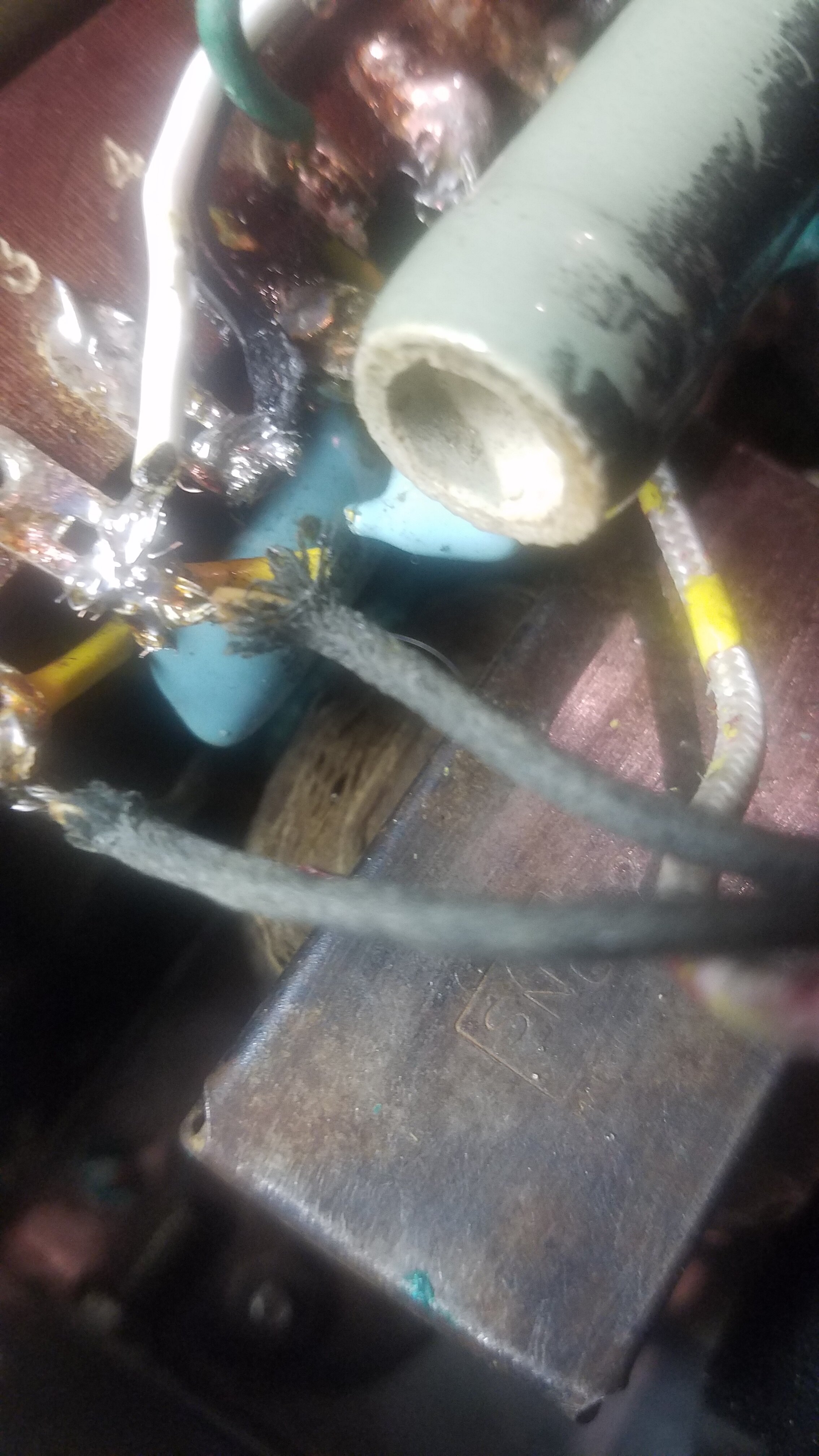

In radio service parts lists and schematics, paper and electrolytic capacitors are usually expressed in terms "microfarads". Short forms for microfarad include mfd, MFD, MF, UF, and uF.
https://www.justradios.com/captips.html
Remember these have specific voltage ratings also, always replace with higher or same voltage rating never lower
  • How about using NOS (New "Old Stock") capacitors? These are not recommended…use at own risk! As paper and electrolytic capacitors age their capacitance values drift, they dry out and they become leaky. Would you drive a 1930's automobile with NOS 70-year-old tires?
Reactions: Tweetybird
Good info.so it has 250v in the hv. Minimum 250v? Some 12v sections too so two different voltages of the same value capacitor?
