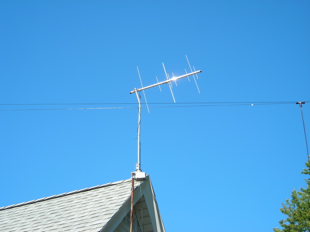

Ok Part 2, antenna orientation changed, gonna try the AO-51 in a bit and see if its any better..
Its a Bust, so maybe I need more elevation on it or its just a crap antenna. SWR is pretty low on the TX side for both elements, 2m and 70cm but so far the RX is Horrible.
I'll try to find an adjustable mount for the antenna so I can add more angle without bending the pipe anymore.
That would kind of kill the budget thing a bit. I'm gonna find an adjustable clamp for the antenna to mast and see if 30 degree's or so makes any difference. After changing the orientation the local 2 meter repeater comes in awesome now, with it the original way I was only getting maybe an S8 now it pegs the meter. So I'm thinking its the elevation.

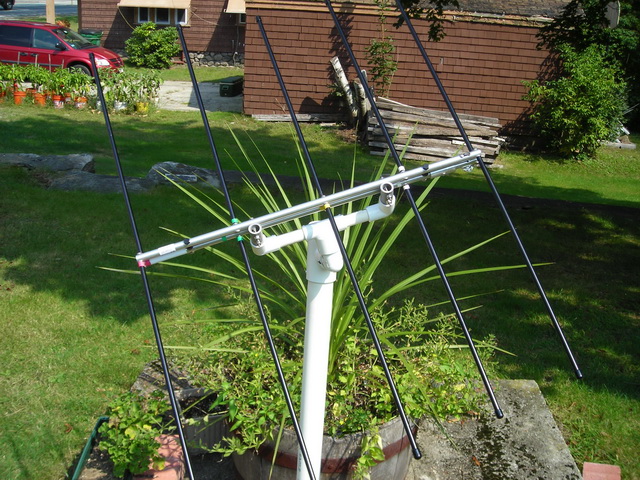

I took some pictures of my elk antenna using a camera tripod
Now if I used the tripods axis to rotate the antenna I would have fixed my elevation at about 45 degrees, but if I use the bolt that holds the elk onto the tripod, a quite different result

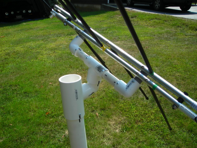

Antenna : Elk Dual Band SAT antenna
Mast is made of all PVC stuff with set screws holding everything in place, I am starting off at 17 degrees as thats what the local Sat Guru recommended as a start point. He also said to set the antenna orientation at 45 degree's as that seems to be what has worked best for him with the hand held Elk. The good thing is this will be extremely adjustable remove a screw, adjust and insert the screw.
BINGO we have a winner !!!!!
Well I finally got it up on the rotator this afternoon and it works amazingly well, I worked the SO-50 bird and I can start picking it up as soon as it gets in the radar screen on the Orbitron Software.
