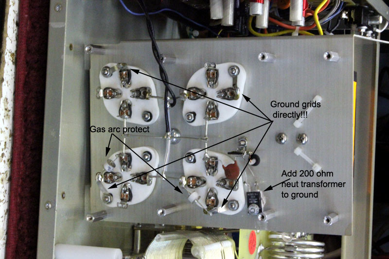

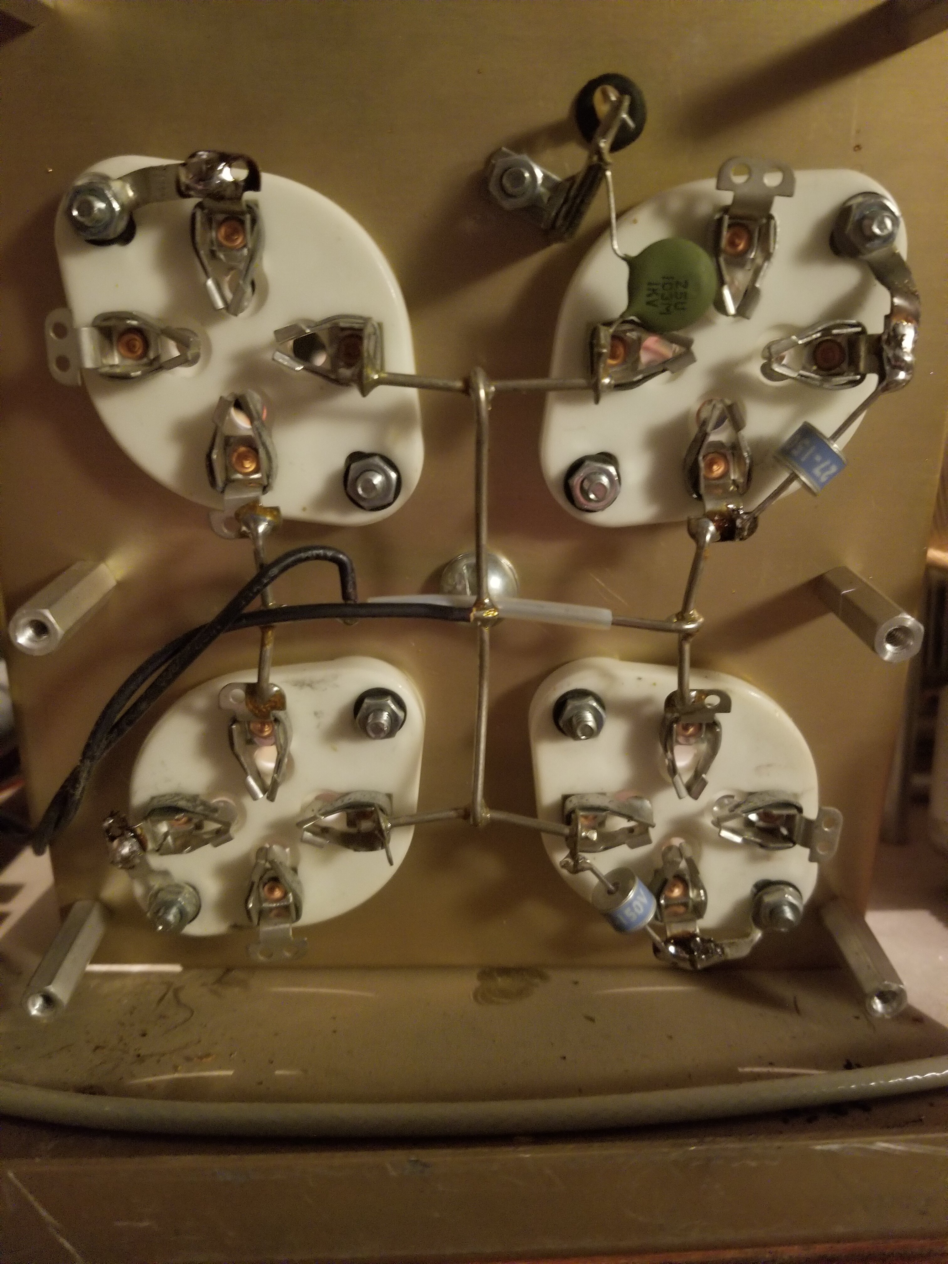

I got her in all done up I think. Unfortunately I don't have a dummy load or a tuner, or a resonant antenna to give her a try. I spent my bi-weekly budget on an antenna analyzer and a used tuning pulser. Oh well I guess
Before
After
