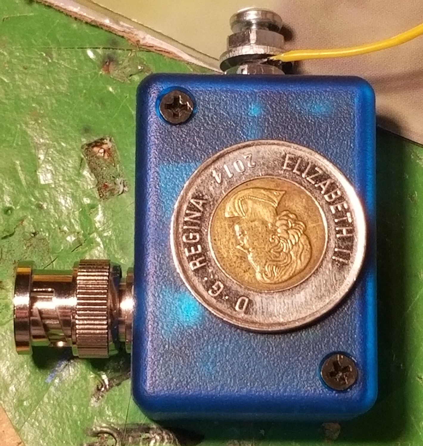

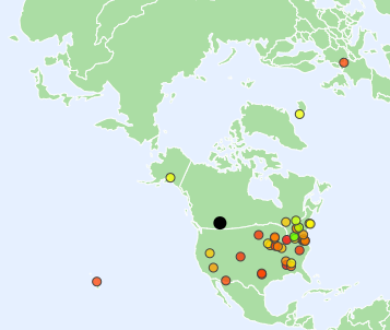

For fun, I dug out my homebrew 20 mr EFHW and set up a WSPR test. The transformer was on my portable fibreglass mast, 1' from the ground. Wire went up to the top of the 14' mast then over to a fence post about 6'6", configured in an inverted "L".
Edit, Radio was a WSRLite with an output of 200 mw.
