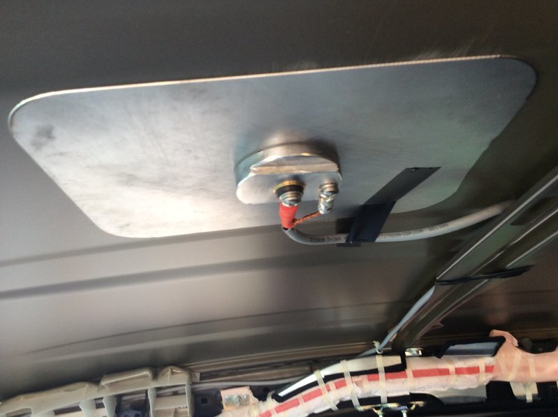

My plate will be a little smaller.

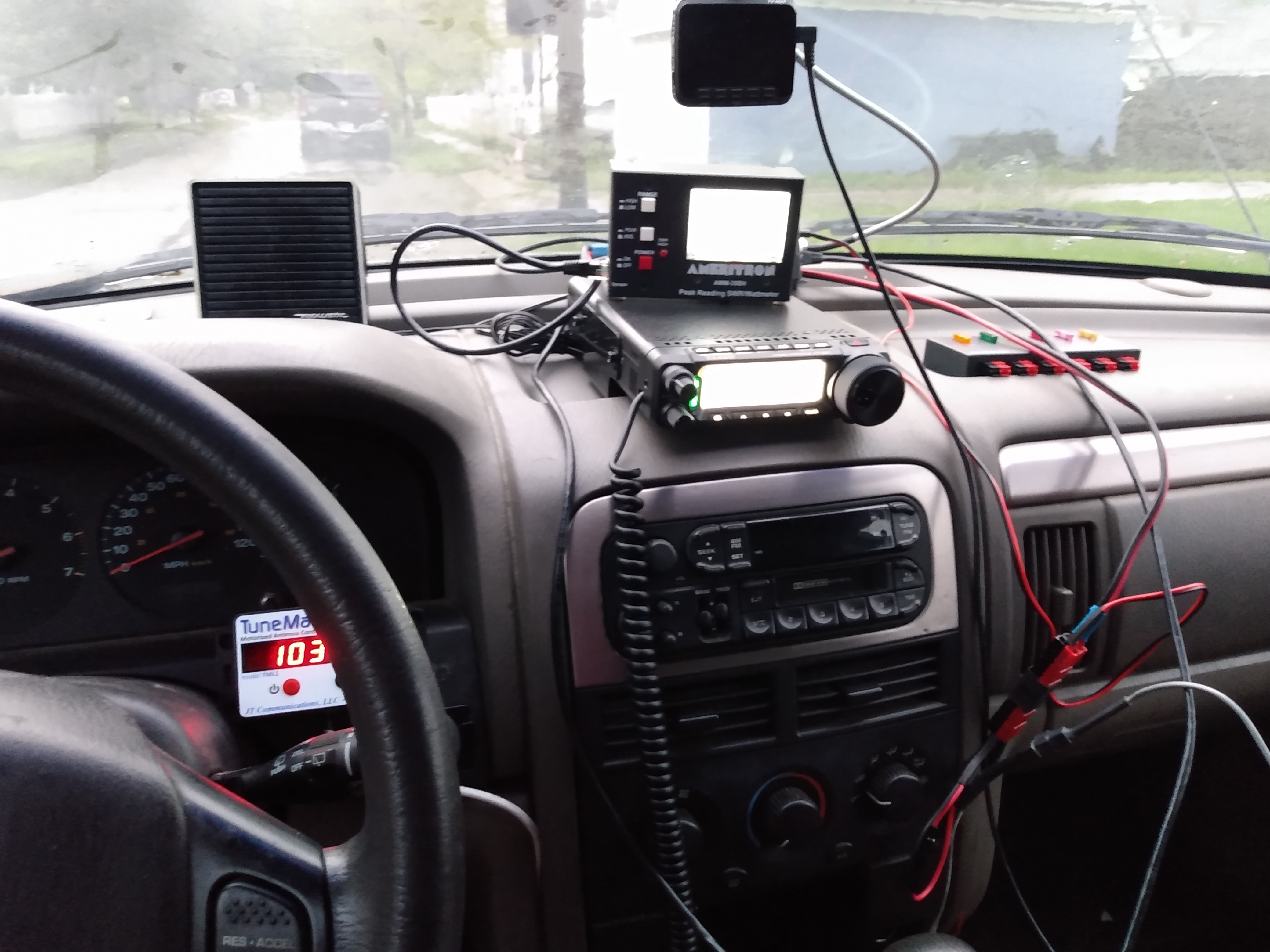

I don't recall the brand of aftermarket antenna controller that I used but it was easy to operate.I never used the switch that came with the TARHEEL II just the other controller. It was quick & required just one push of the tuner button on my ICOM 7000 & it was done.

The West Mountain Target tune works well but I didn't like all those wires going to the control head. The Tune matic lite is a good compromise for semi auto-tuning and less extra cables.

I got the 56" loading up good on 80/40 now. I don't like losing 6 meters. I've been making a few contacts mobile lately. I also use our local repeater. Oh well, I'm satisfied with 80/40, as that's the majority of where I'm going to operate.
6 meters is cool, but it's even cooler mobile. Maybe I can rig up a quick whip change.
