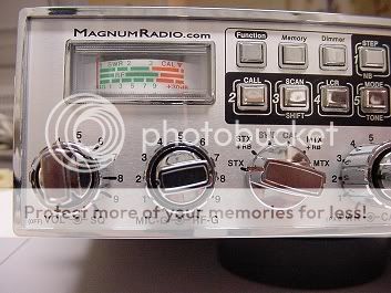

Here's a thought if you are considering putting together an up-to-date base station...
The Magnum OmegaForce S-45 HP.
It is true this radio was designed to be a mobile radio; but I have found that it makes a compact multi-featured base station radio. Sure; any mobile radio can be used as a base station. But not many mobile radios carry enough new innovations; this is also true for many base stations being sold today on the market. RF Limited/Magnum International has combined the PowerBand RFX-75 amplifier to the OmegaForce chassis. This particular model has undergone many evolutionary changes in less than a decade. This evolution started with the AlphaForce to DeltaForce. Then, from the DeltaForce to the OmegaForce. Now; to the OmegaForce to the OmegaForce HP.

I used to think that Galaxy radios were the best receiving radio on today's market. I was wrong. The receive in this radio is better than any of the Galaxy's I presently own. I can hear people that others can't. I didn't expect this radio had as good receive as it does. Considering I don't run the world's best antenna - I find this a definite 'plus'. Of course, nothing can make up for the quality of the antenna. It sure does help to be able to everything that the antenna can offer - though. This is a dual-conversion receive radio - with an important difference. Both the receive and transmit circuitry is CPU controlled - which also means more precision for AM, FM, and SSB modes. Only RCI has some radios that are in the same class as the OmegaForce using a CPU to control receive/transmit circuitry.
The truly unique feature to the OmegaForce HP - is it's ability to modulate on AM and SSB modes. For 10 meter operating on SSB, simply turn the selector dial to 'STX'. This will apply compression when transmitting. With the stock mic's condenser element - being understood is no problem whatsoever. If one wants a truly wide range dynamics for AM mode, switch the selector to 'MTX'. When in the 'MTX' selection; the compressor and the TopGun modulator is also on. Making one sound distinct enough to cut through any mucky-mud/pile-up. The 'MTX' will work on AM only; and not on SSB or FM modes.
The other feature that works in this radio - that is unlike any other that I have seen on the market - is the ability to turn down the RF power output knob all the way down in AM mode - and watch it swing upward. I checked all RF Limited's claims with my Dosy meter - which I'm quite sure is 15% off (meaning that there is probably more power out than my meter will show). This radio will dead key at one watt and swing up to nearly sixty watts! I had to see it to believe it; but I did. Probably closer to 75 if a Bird meter was available. Turn the RF output knob to the halfway point and see eight watts dead key and ninety watts. Turn the power knob to the 3 o'clock position when on SSB and hear them come back to you during skip with 65 watts swing. Just imagine that available dynamic audio range with the best mic in your arsenal...
Yes; it has toys that can be turned off. But they are top-notch too. The digital echo is rivaled BY NO OTHER manufacturer. Sam Lewis -of "RF Limited/Magnum International"- explained to me that they use a high-end echo chip that is used in high-end karaoke machines. Not mushy or muddy; but pristine and clean. Keeping one's 'high-end' frequency response audibly clean. I felt that the highly acclaimed Galaxy echo boards sound muddy by direct comparison. Another area that I feel that Galaxy dropped the ball and Magnum picked it up and ran with it is the all-mode talkback feature. It is simply no contest comparing the audio of these two, the fidelity of the Magnum's talkback is superb. The roger beep function gives a quick beep rather than an elongated tone.
All of the Magnum S-6 and S-9 series have the TopGun compressor and TopGun modulators. As well as the Alpha, Delta, and OmegaForce radios. The S-3 series has only the TopGun modulator. I believe that the TopGun devices sets the Magnums apart from the other radio manufacturers - as far as being clean, clear, and pleasantly audible. They also have the characteristic of being able to key with 1 watt and swing to 50 watts.
I usually run the RF output at the nine o'clock position on AM for a cool 2-75 watt swing/PEP. I also usually run the RF output no more than three o'clock on SSB. I never turn it all the way up. That isn't a wise thing to do on any radio. With that much dynamic range; why mess with it by turning it up all of the way and compressing the power? Let it swing as much as possible to get the best that it has to offer! Keep the RF output knob set low - and keep it cool. One would just be heating up the heatsink and output transistors needlessly.
