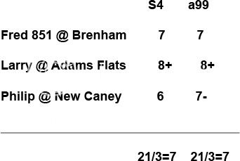

I took a look at these figures. When I looked for stations that were the same for each of the antennas I found only three recorded for both antennas. they were.these:
If the 8+ signals were to be figured as 9, and the 7- as 6, the figures would be
22/3=7.3 showing identical results for both the A99 and the S4.

Actually marconi uses a half rating for the plus (+) and minus (-) symbols. So that for the s4 you would add 7, 8.5, & 6 for average of 7.17. And for the a99 7, 8.5, & 6.5 for average of 7.3. On the averages the A99 would have an edge on marconi's system.
as far as the individual data i would say it is too close to call wouldn't you?
Yep, too close, except to say the Sigma 4 is not doing it the way it's supposed to do it - much better than the A99. . . What a deal.
