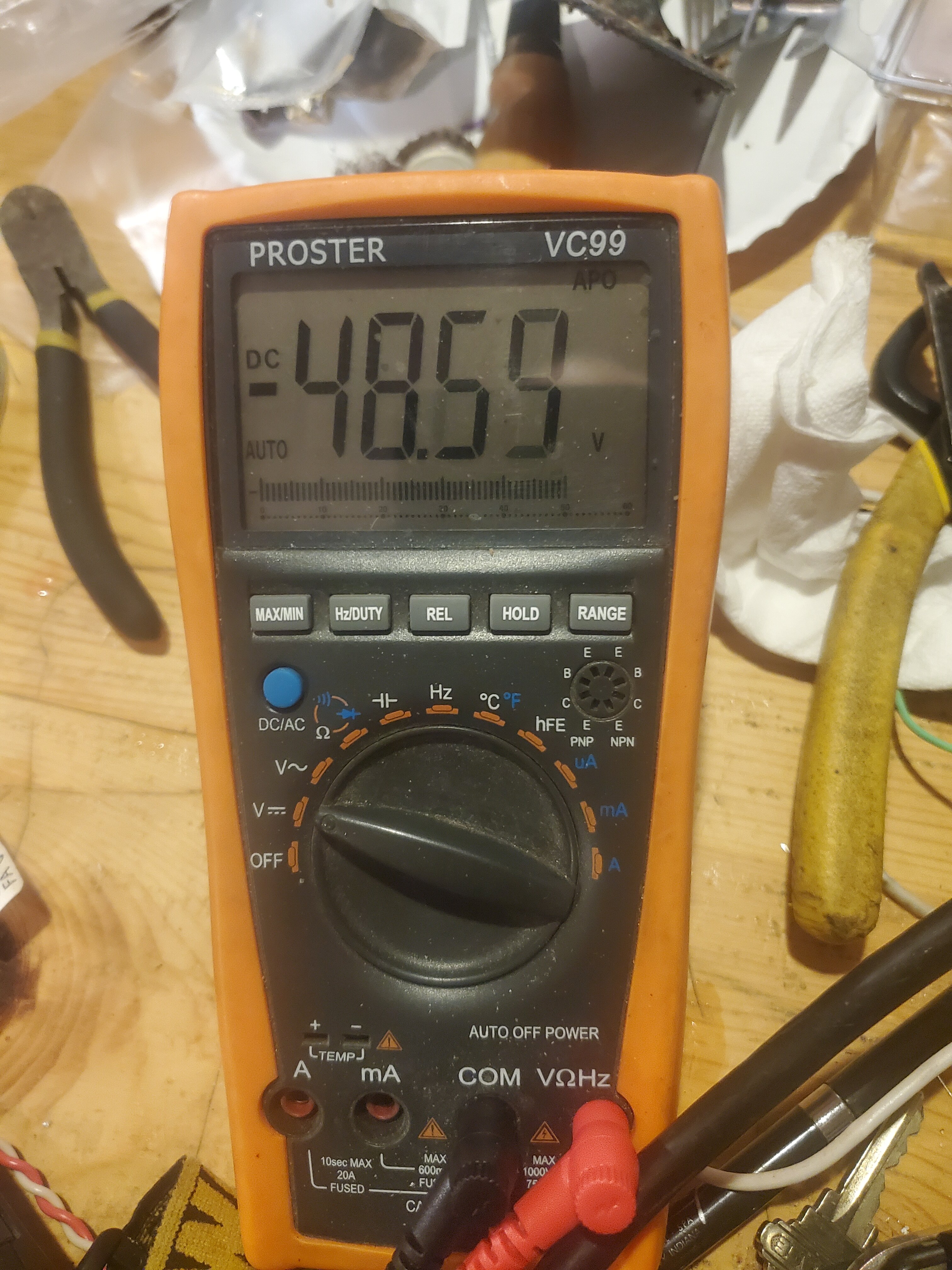

I tried it and grounded the screen grid pins and it worked but I was lucky to see 100 watts out of it so I wired it back up the way it was before and will start over. Ya know one thing I noticed last night after I keyed it down enough times and got it to start cherrying the plate I heard the hiss in my radio, there was no rx present as the tube was starting to redplate as if the relay had stuck during tx and I saw bright light under the amp and I think it was the neons, this would be oscillating wouldn't it ?????? Don't the tubes cherry if a oscillating situation happens ? The driver tubes are right on top of the finals like no other amp I have all others are located away and have a cage around them . The photo are of the negative bias off of pin 5 during keydown wouldn't that be enough negative bias with 500 volts on the screen ??? The other photo showing 2 volts is without the radio keyed
But that -48 volts of bias was also under modulation I forgot to mention that but you said with that high of screen voltage the negative bias would have to be 10 times higher than the -16 volts and that's nowhere close, is it perhaps possible to use the screen voltage off of the final tubes for the drivers also ?
Gotta distinguish between the steady fixed negative control-grid voltage present in receive mode, and the dynamic (higher) negative control-grid voltage you'll read while keyed down and driving the amplifier with a AM carrier.
