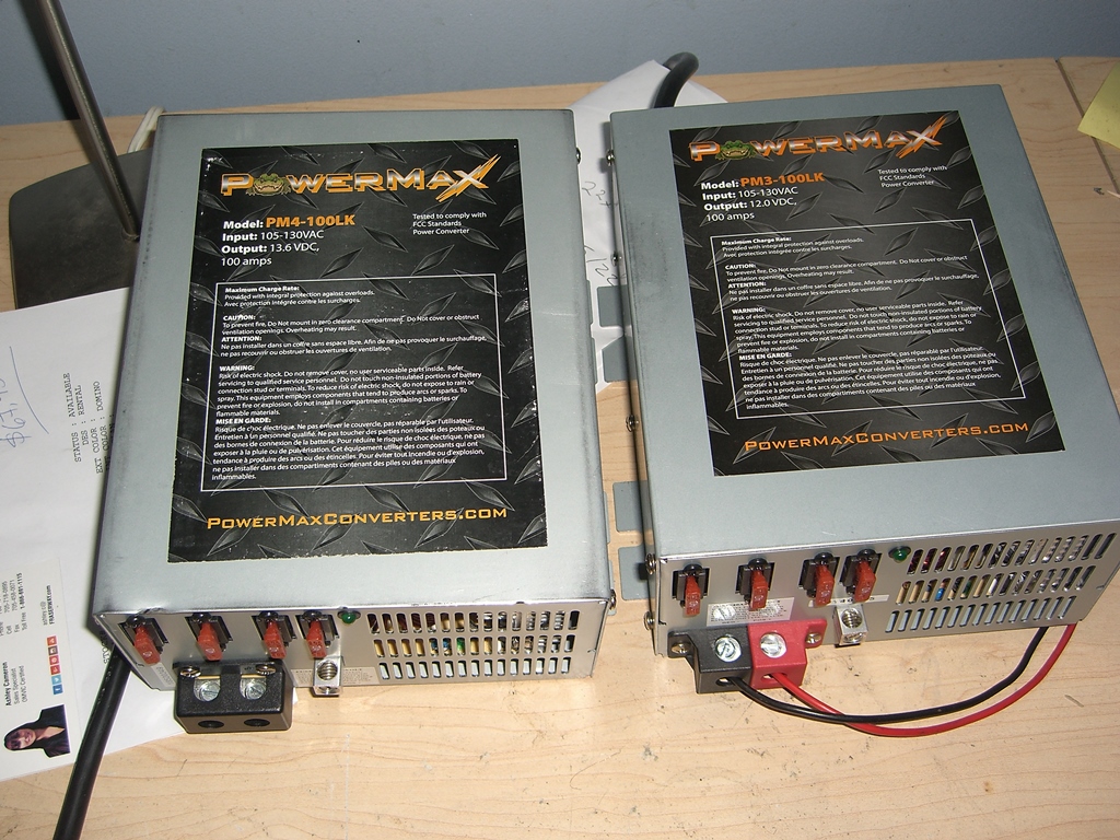

Watts ÷ Volts = Amps so it depends on what voltage was used to determine amps.
I would bet its a 1200 watt supply at 110v and output will be 100 amps at 12v flat. 88.24 at 13.6v.

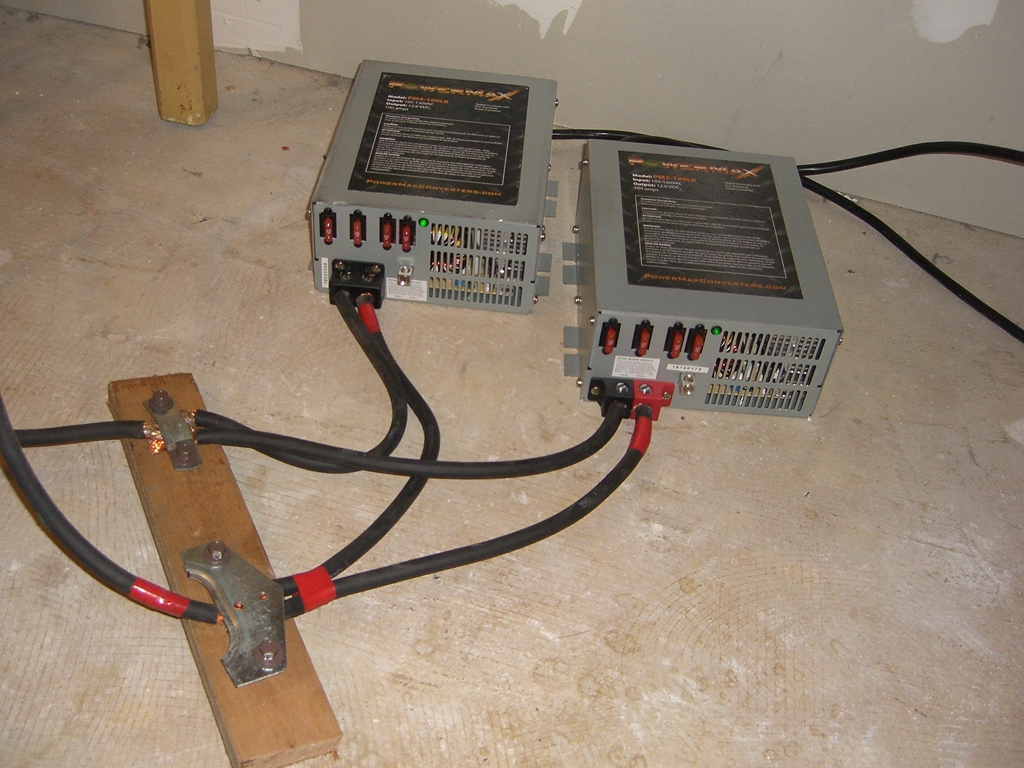

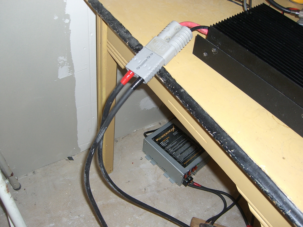

Yeah the PM4 say 100amps at 13.6v and the PM3 is 100amp at 12.0v...?? Anyways have both set at 13.8v and seem to be pushing sweet 16 really good...tomorrow going to run the hopper for first time. BTW I am using #2 welding cable to conect these things.

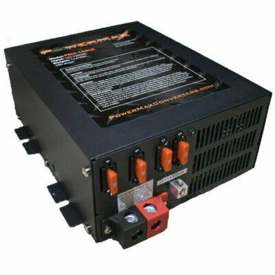

I just purchased a 100 pm3 from ebunk.
Ive heard good reviews of the Powermax units. So far the seller thunder rv has been slow to ship. I believe ive bought from them before and they were slow then too.
Anyhow here is the sellers description. It looks like it was taken from the powermax site:
The PowerMax PM3 Series converters 110Vac power to 12Vdc power to charge a battery and/or power 12V equipment. With our state of the art 3 Stage Smart Charging and adjustable power supply modes, the PowerMax AC to DC power converter/battery charger are engineered with the user and variable environmental conditions in mind. They will fully charge and maintain any battery type while providing very clean DC power. Ideal for use in CB/Ham Radio, RV, Automotive, Boat, Car Audio, or any applications where battery charging and/or 12V power is needed.
PM3 Series Converters can also be wired in Series or Parallel to reach even higher power outputs.
Lithium compatible when using in Fixed mode output and recommend by many of the popular Lithium Battery manufacturers such as Battle Born
  • Built-in 3 Stage charging and fixed single output modes
  • Suitable for charging ALL battery types including Lithium, Lead Acid and AGM
  • Fixed output mode voltage can be set between 13.0 Vdc to 16.5 Vdc
  • LED Indicator light
  • Temperature controlled- Quiet fan cooling
  • Reverse Polarity, Overload and Thermal protection
  • 2 year warranty
  • Unit weighs 9 pounds.

Tin Can posted side by side PM3-100 and PM4-100. Physical can container shape and size notable. Tin Can confirms both have essentially 2 modes; 3 stage charging and selectable constant voltage output mode.
