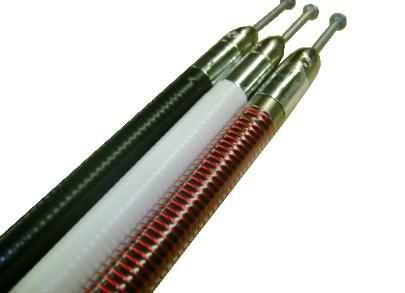

There used to be a type of antenna that used a long bottom load about 12" long.
Also is similar to what some would call - a Tiger Antenna - twin wire wound - as in two separate wires running up the winds of the shaft - supposedly to improve the surface area and the bandwidth. Came in both Top load whip and bottom load like you'd see above (without the Puffed Rice)
If you've ever dealt with Hot-Rod Fiberlgass or the Francis Amazer antenna - they use a similar concept of multi-wire of different AWG # size - run up inside the fiberglass sheath and provided a level of performance due to their construction - that was unique to their brand.
There is a company called ProComm in Illinois that still offers these (CitizensBand)...now they come in 4-wire (Quad wound) - PDF attached...
First, am not talking Predators on this. Second, this may sound stupid but why is a 3ft top load antenna, like so far I found a k40 tunable 3ft with 16 gauge wind so bad when a center loads coil would actually be lower? I thought I understood the whips were for adjusting? And the higher the coil the better, even though I have read that is to a point as well. The shortest "normal" size center load coiled antenna I found was a 5inch shaft W2000 4.5 ft taking my watts. Is that a bad antenna as well?
Thanks read all those already. I don't really need wide band width. When I use this it would be on 27.185AM mostly. I think Skipshooter has one called the double barrel.

As a word of caution though. The shorter the antenna - the more voltage losses due to the transformation that is occurring - generates a lot of heat - even to the point of making the tips - that metal ferrule top - very hot. Can melt solder and even fatigue the fiberglass to a point where it simply collapses on itself (crumbled away) and you can find the top of your antenna missing after using an ATM or hitting a tree limb overhang.
It - heat from the power you run thru it - can ruin the seal the wrap it uses to keep out water - so be careful with the "fire in the wire" you use. Too much and she'll burn up - literally. The tips are small and light for a reason - but that also equates to not much there to take up and dissipate the heat that forms in the tip from all the RF radiating from it. Firestik offered more of a robust design but added weight and if you use a shock spring - albeit a heavy duty one at the least - for she will whip from the overweight top heavy thing they are.
It's what I encountered with "Tiger" antennas - those twin wire wound beasts that were around in the late 90's. I had to throw them in the trash - very little was salvageable. The tips themselves were chrome plated brass with no nickel plating in-between to protect them - so they tarnished and corroded to the point they were unusable The wire and its sheath corroded from the water entry - like I said - little was left to salvage.
