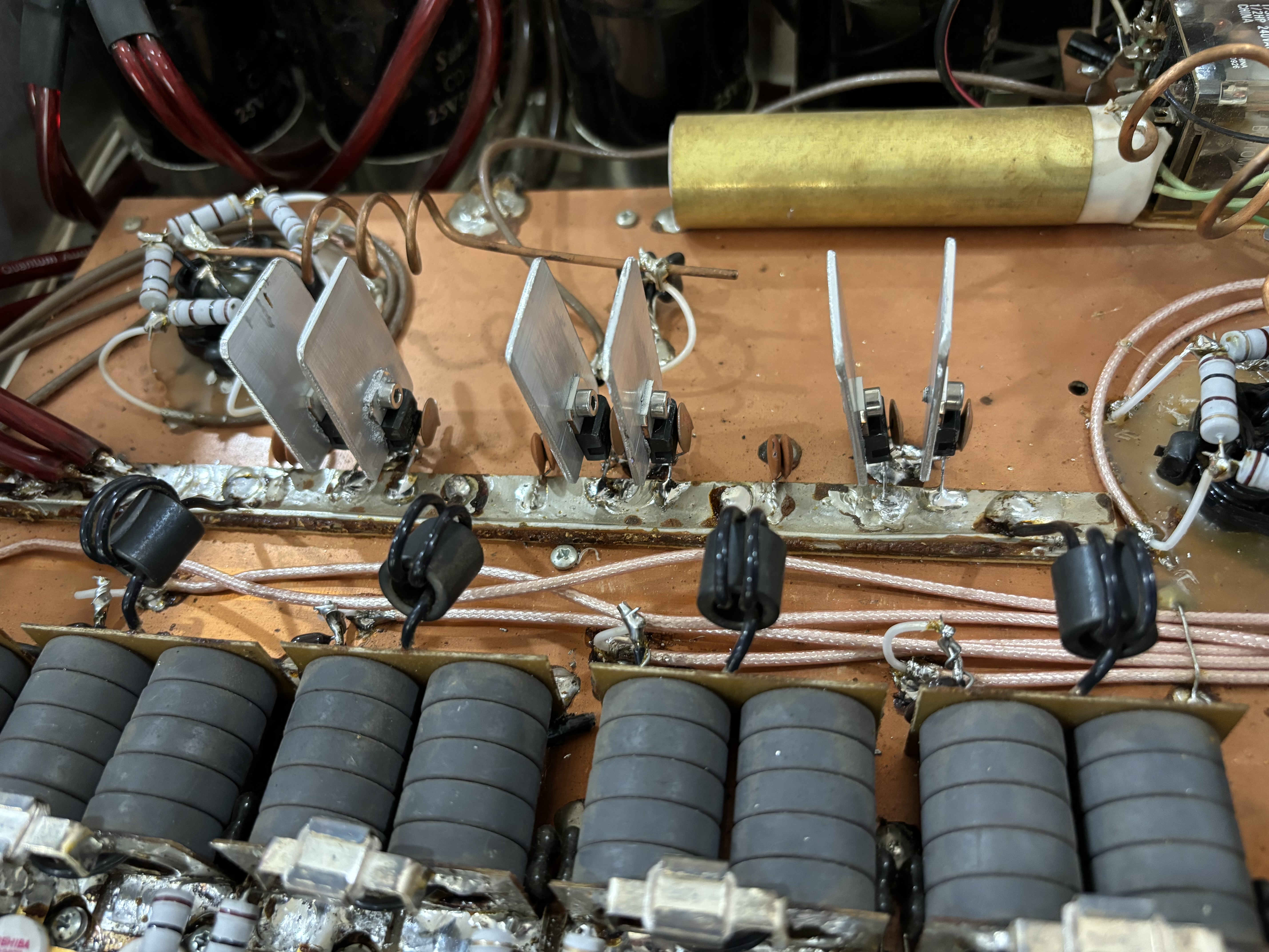

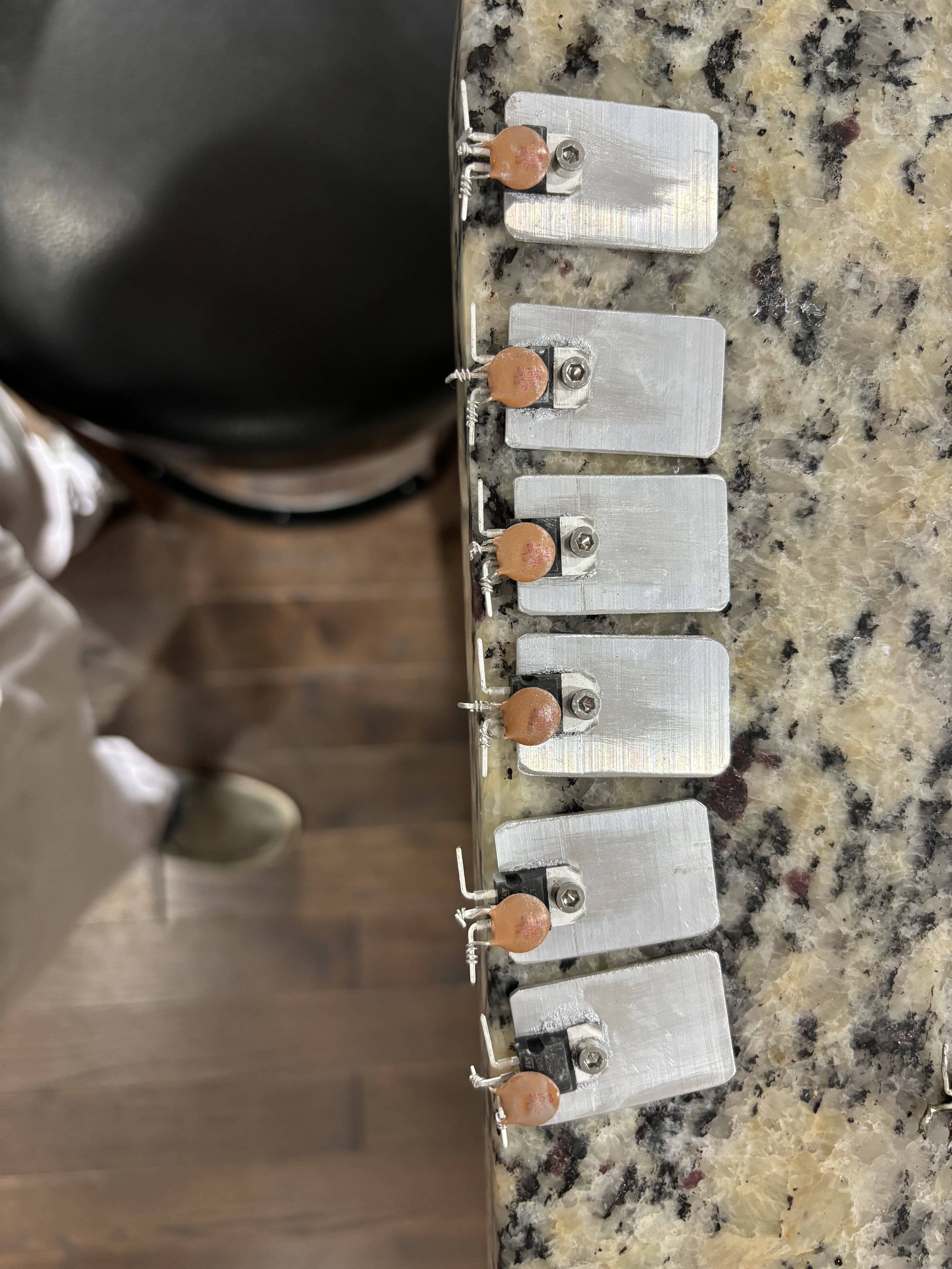

Update on amp. Used 6 regulators instead of 3. Do each fan has its own dedicated regulator. Also used some aluminum plates for heat sinks. Replaced the one bad pill. Seems to work well. Thanks for all the advice. Greatly appreciated. Cheers!!!

Looks good, I would get those loose solder balls out of there. They can create havoc.
