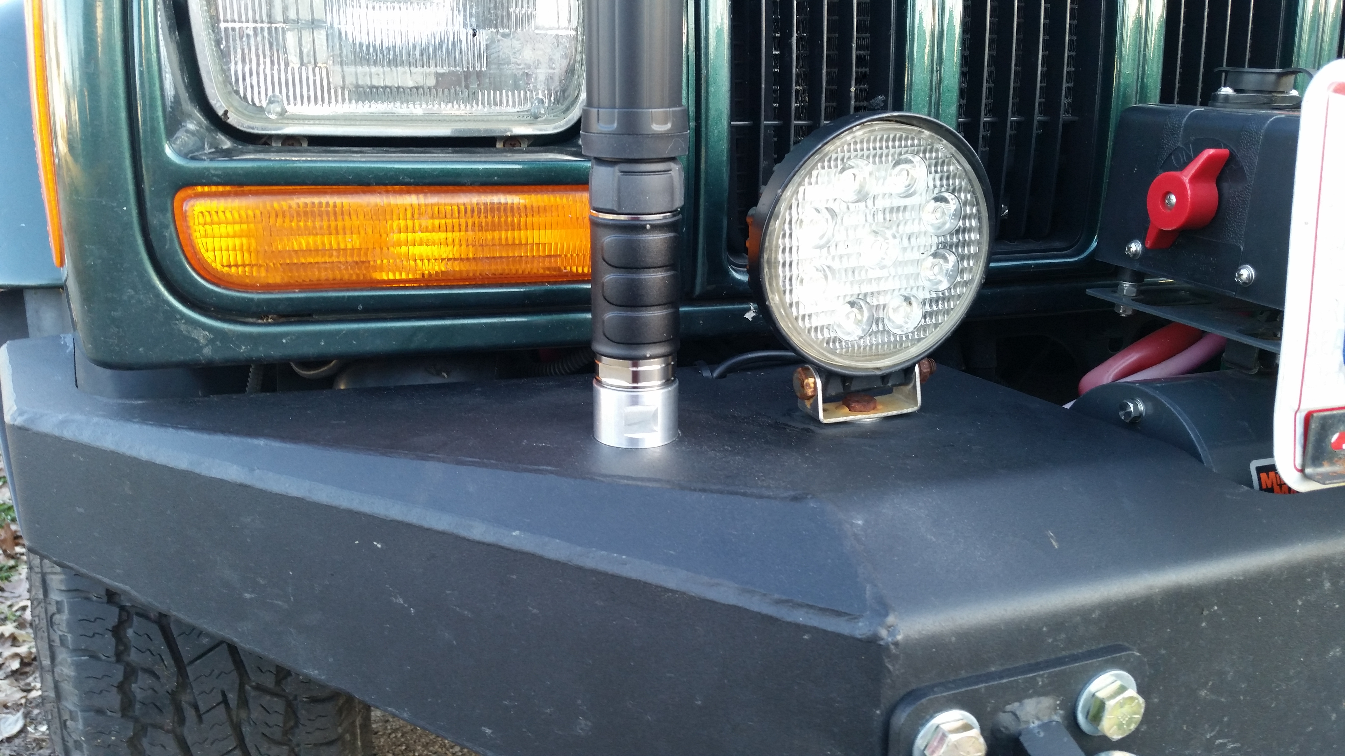

Slapped it in the Jeep XJ this afternoon. The ATAS tunes up nicely on advertised bands, except 40 meters. I'm experiencing common mode. When I key up, my fogs lights act as anmodulation indicator and I heard some kind of buzzing/clicking sound in the dash. SWR on 40 is pushing 2.0. I was sort of expecting something, since I put the antenna on the front bumper.
I believe I'll order a ball mount for the passenger rear quarter, or K400s mount for the rear hatch. Hopefully, this will minimize issues. I don't believe I have a grounding issue, but possible.

The ATAS is pretty particular about grounding. I ran a could of ground straps to the body on mine. Looks like you have a real solid mount, but I would double check it just to be sure, and maybe even scuff up the hole in the bumper. 40 is easily do-able with mine, but every vehicle is different. I have seen where some guys use a longer whip to have better bandwidth on 40. If you have a Wilson whip around, might be worth tossing it on there just to see if you get an improvement. Also, I did run a couple of ferrite chokes on the remote cable for my Mic, and it helped quite a bit with rig.

I sanded both sides of the bumper down to shiny metal. My bumper is bolted on with frame rail plates. I also welded them in a few places. I was thinking everything has a good ground.
I was outside earlier changing some menu items and discovered 6 meters is now getting flaky. I'm not going to trouble shoot it any further. Having the ATAS on the front bumper is starting to bug me now. Going to go with the ball mount.
I do have various whips laying around. Guess it's worth a shot to try them out tomorrow.
