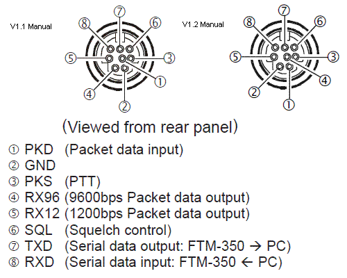

APRS manual pinout error
The last item in the APRS manual is a pinout diagram of the data port. The version 1.1 of this manual has some of the pins mislabeled. Those of you who are experienced with mini-dins probably noticed and ignored the bad info. The rest of us will struggle and not understand why our data cable doesn't work.
The APRS manual version 1.2 issed last week is corrected. The attached file shows the correction.
73,
K4MCK
