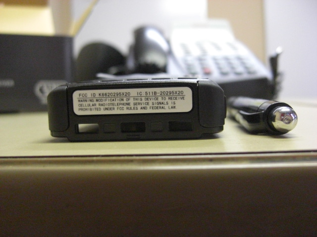

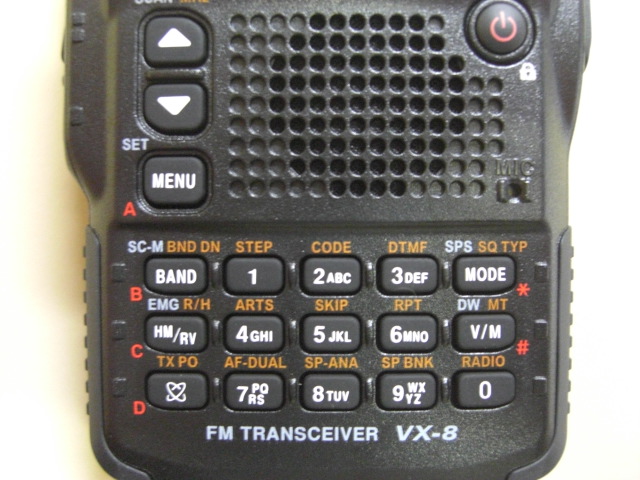

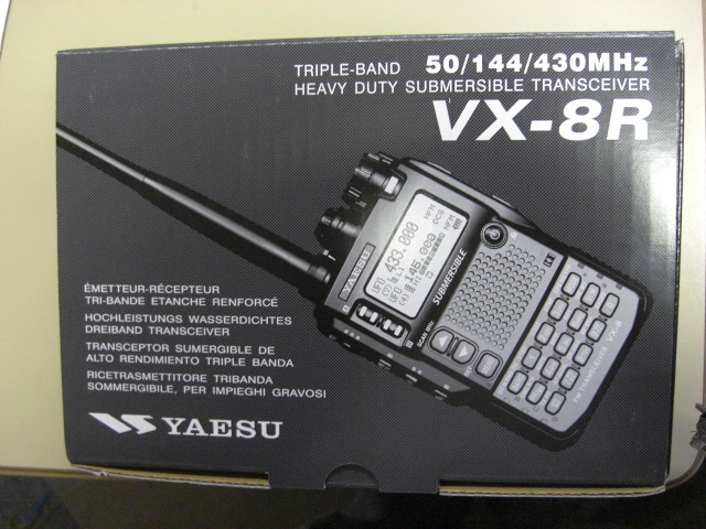

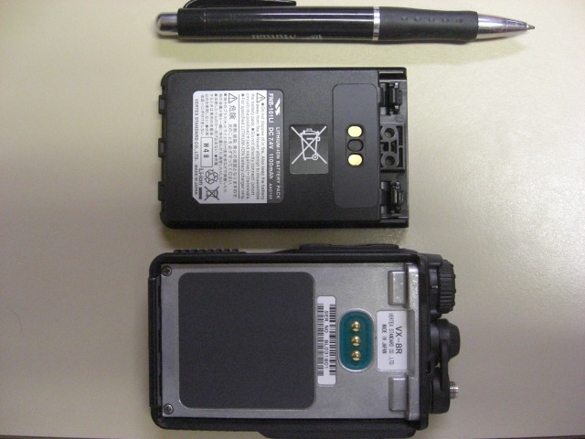

My VX-8R Has Arrived!
When UPS arrived today, I was all smiles... :) Here's a few pics for ya!

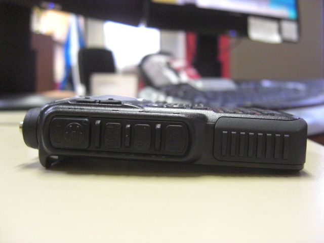

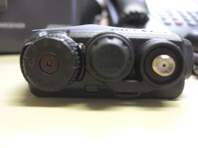

Some More Pics!
Enjoy

You guys take good pictures!
mpspringer, you going to try yours underwater also? :blink:
Happy_Hamer - Easy... Hopefully, I'll be staying away from water :) I've got FULL confidence in moleculo's underwater results!
Moleculo - thanks for the friendly shout out!
Its charging right now. It really amazes me how small and compact it is. They sure crammed ALOT of technology into this tiny package. I love the saying on the box too.. "TRIPLE-BAND HEAVY DUTY SUBMERSIBLE TRANSCEIVER" It just SOUNDS bad ass!
