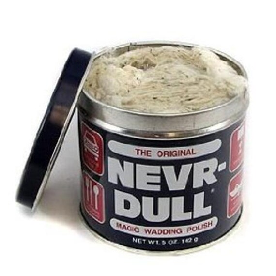

What about never dull. It's made for cleaning aluminum wheels and such and does a good job. It's one of the few I have found that doesn't stain or leave that milky discoloration.

Never Dull is what I have used before on my Predator 10K's...shines them up like chrome!...Probably last a few weeks, depending on the weather...You can find it in the automotive section at Walmarts where the rest of the wheel polish is at...One can will last for years.

This is the stuff I use to clean my antennas. I think it is the SOS competition. I wet everything first, while cleaning it makes a black film, then I wash thoroughly with water.
Optional step: After doing the cleaning with Brillo, you can use Magic to make it super shine, but it is cumbersome to do it. I just clean with this steel sponge and that’s it.
