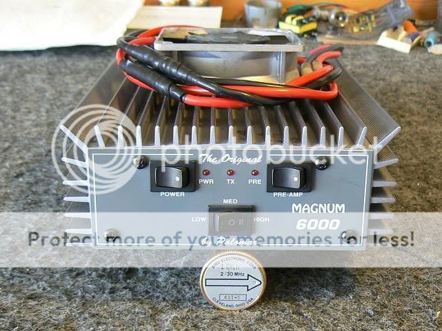

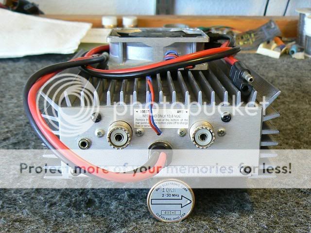

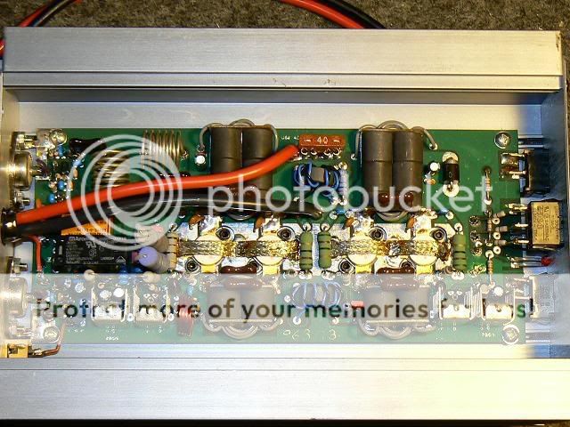

I really enjoyed my Magnum 6000.
Class AB-1, 4 x 2SC-2879, active Bias, 5 pole Chebyshev LP filter, intenal jumpers for low, medium, and high drive, independent pre-amp, wrap around heatsink, common ground (not floating), Flame proof resistors, excellent input and output SWR, etc. I added a keying circuit for ham or modded CB radios (left side on rear view, bottom left on internal view) so no SSB chatter and no delay when unkeyed and I added a fan (I have been called a bucket mouth!).
A good friend talked me out of it and he loves it.
