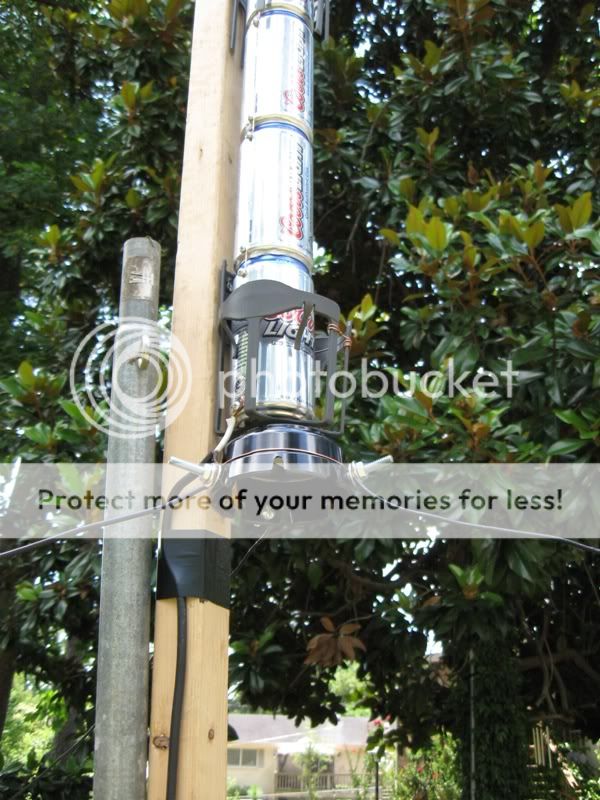

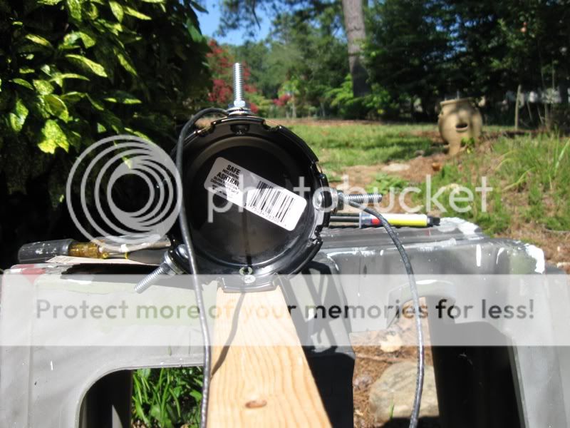

Another setback-- radial mount snapped in two when I tripped over a radial wire while moving it. Off to Walmart for a replacement. Today is the day.
OK, here we go:
Radial mount from the DX department at Walmart:

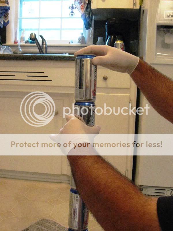

Highly scientific construction technique (notice that up on the counter is what I was drinking, Diet Coke):
I was lucky to find these:

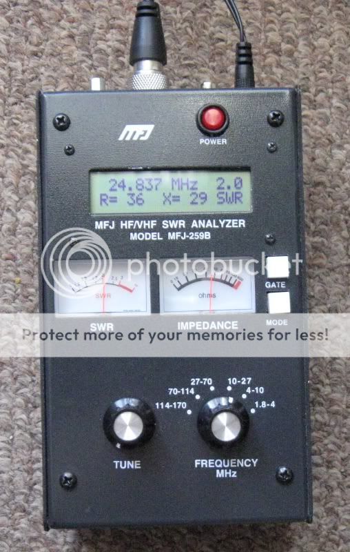

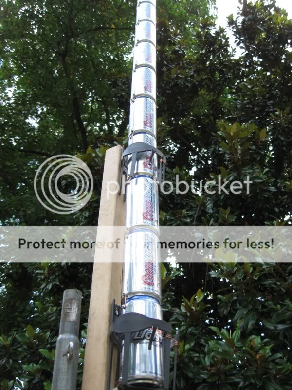

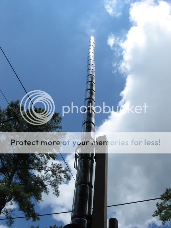

Antenna at resonance, 20 cans (I didn’t crop the photo so I could acknowledge the help of Daisy, the RF Dog):

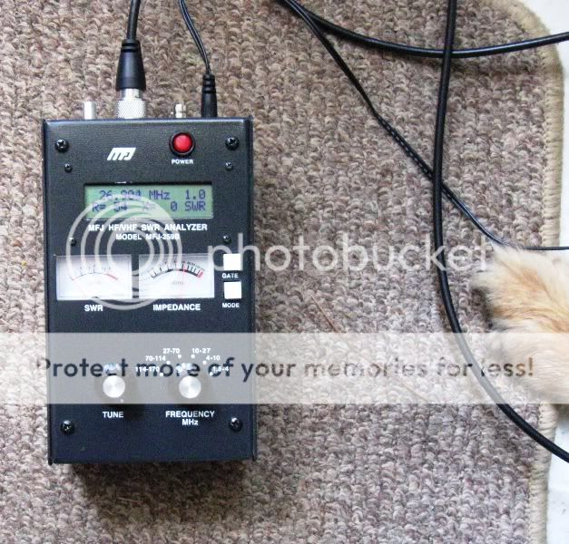

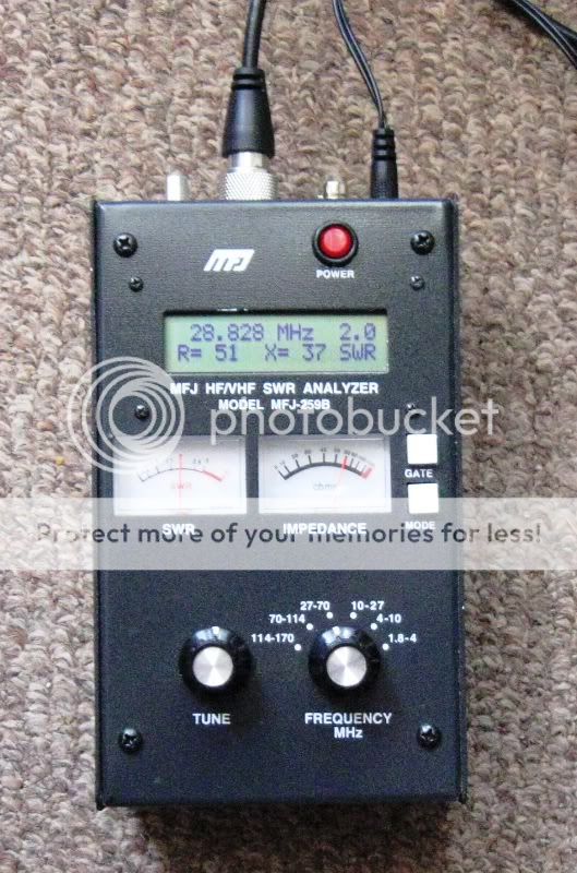

VSWR of 2:1 from:
To:
Since the VSWR was OK that high I dragged the TS-520 into the dining room and ran the coax in the back door—not a thing, not even on 28.400. So I went into the garage and grabbed a Cobra 25 and a 12VDC supply and made a couple of contacts on CH 19. This ended up being a lot more work than I thought- but worked OK for only 6 1/2 feet off the ground and 3 radials.

Now that is worth the wait. Cool.
I'll have to confer with BM to see whether he wants to change his vote.
Just might be a winner.
Ha! Well Homer, it'd be pretty cheesy for me to win my own contest, though I have to say that $1M bill looks pretty good!
You know, the bands always fold up and go on vacation whenever I have a new antenna to test, but I finally eeked out a couple of W3 special events stations a few minutes ago with it on 10. The band is not in good shape at all today, but oh well...
