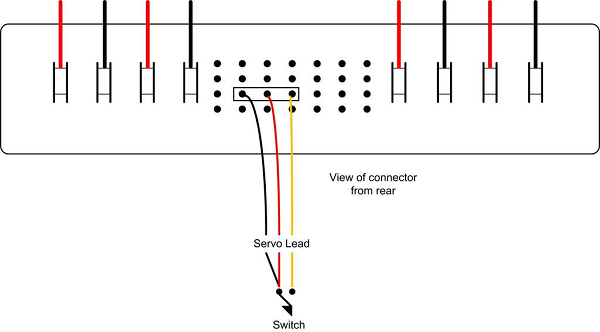

Found a thread about these supplies on an RC model forum. Seems that these guys use the supplies to recharge their model's batteries. Lots of good info. Well written thread.
A simple high quality 12Volt 100Amp Power Supply- Part1 - RC Groups
Here's a picture from the thread showing how to "hot-wire" the unit. Connect the red and black leads together, and connect them to the yellow lead (which is ground) through a switch.

I have 2 on the way $8 each plus $24 in shipping. I will let you know about "noise" , but do not expect any, I use switching power supplies all the time to run radios and amps.
