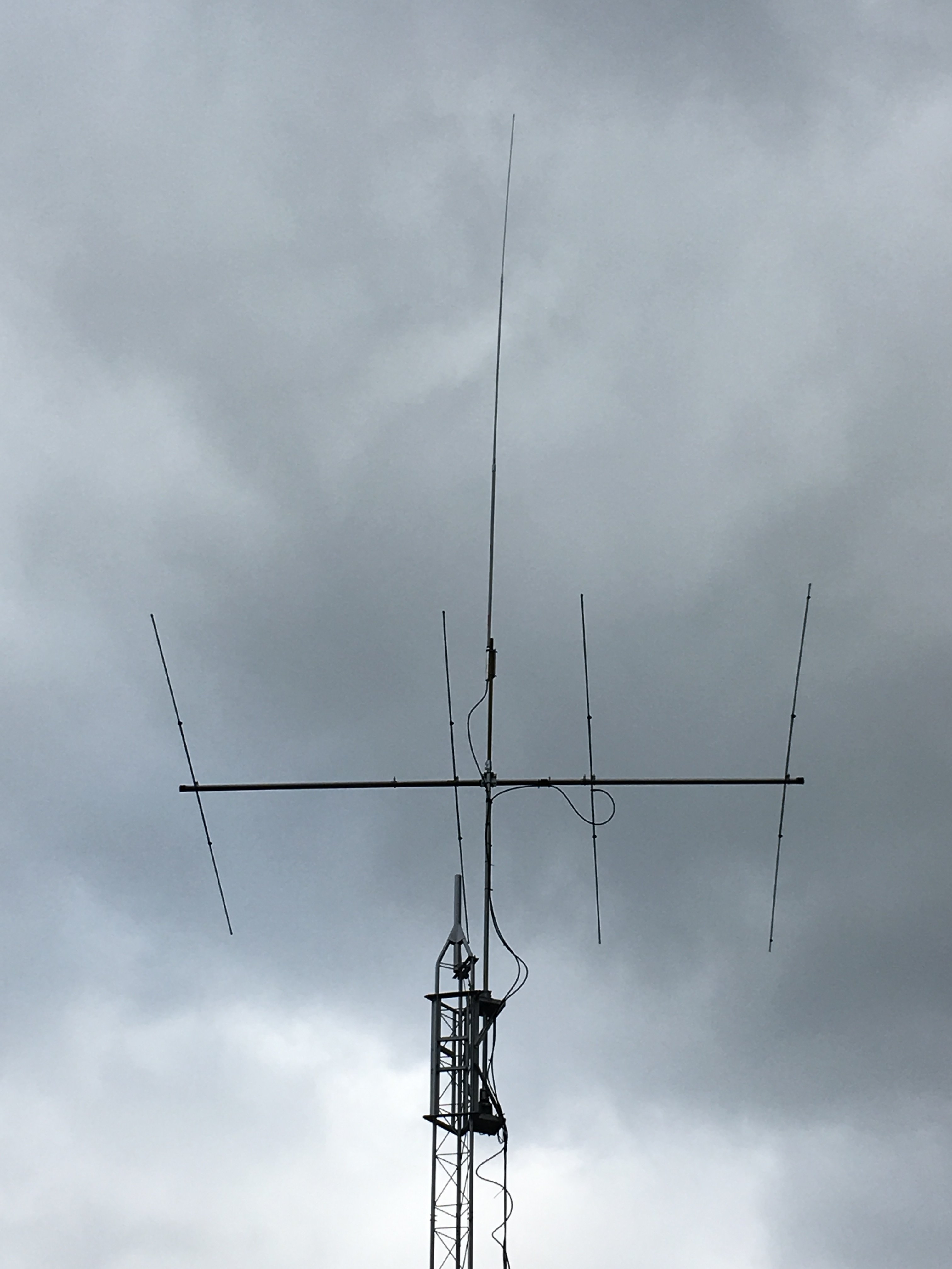

Ok so the tower is up 40' hazer to crank the antenna up an down to service. Mast is 10' and on top 4 element Maco on the flat side. and last Saturday pu an Imax 2000 on top. An now I bought a 5BTV also with the bracket for the pl-259 conector. Capt. question did you the copper ss-30 jetlube or is the nickle standara anti-size ok.or nothing at all. was going to make my own radial plate I have aluminum angle or diamond plate ok or wait for stainless does it matter.also hardware dont have stainless screws might go with steel zink coated etc would it matter all that much. your looks real nice. got to add some stugg to the list for guy wires to should have that laying around too. thanks
I would go with all stainless. Aluminum will corrode in contact with the ground and zinc plated hardware WILL eventually rust. All that is BAD juju when an RF field is concerned as it could lead to lots of RFI as a worst case or as a best case poor antenna performance. I did not use tye copper anti seize on the aluminum antenna sections and used NOALOX instead. Just something about copper flakes and aluminum does not sir well with me dispite DX Engineering recommending it. Other sites I have seen including a retailer of it said not to use it on aluminum. I did use a copper based anti seize on the stainless hardware however.

Grogan looks good.
Only thing I will recommend, and recommendation only
Is to secure your coax using either zip ties UV resistant type or some other form of tie.
My QTH is in Florida and we get some high winds from storms, any loose hanging coax catches the wind and makes it a nightmare on connections..
So I over do it with zip ties and securing coax to mast pipes or booms.
