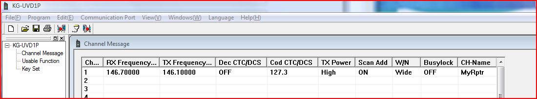

The programming, what is the Decode CTC... and the Encode CTC.. fields I think I need to use only 1 but not sure which
I'm trying to program 146.700 it has a negative offset and a tone of 127.3
thank you
You have to enter both the TX and RX frequencies yourself. The software doesn't do auto-offsets. "Decode CTCSS" is just a Chinese way of saying "Tone Squelch" :D. "Encode CTCSS" is the Repeater Tone. For most repeaters, you just need to set the "Encode CTCSS" value. The software labels that "Cod CTC/DCS".
I attached a print screen example of how you would program the repeater you indicated using the software.
