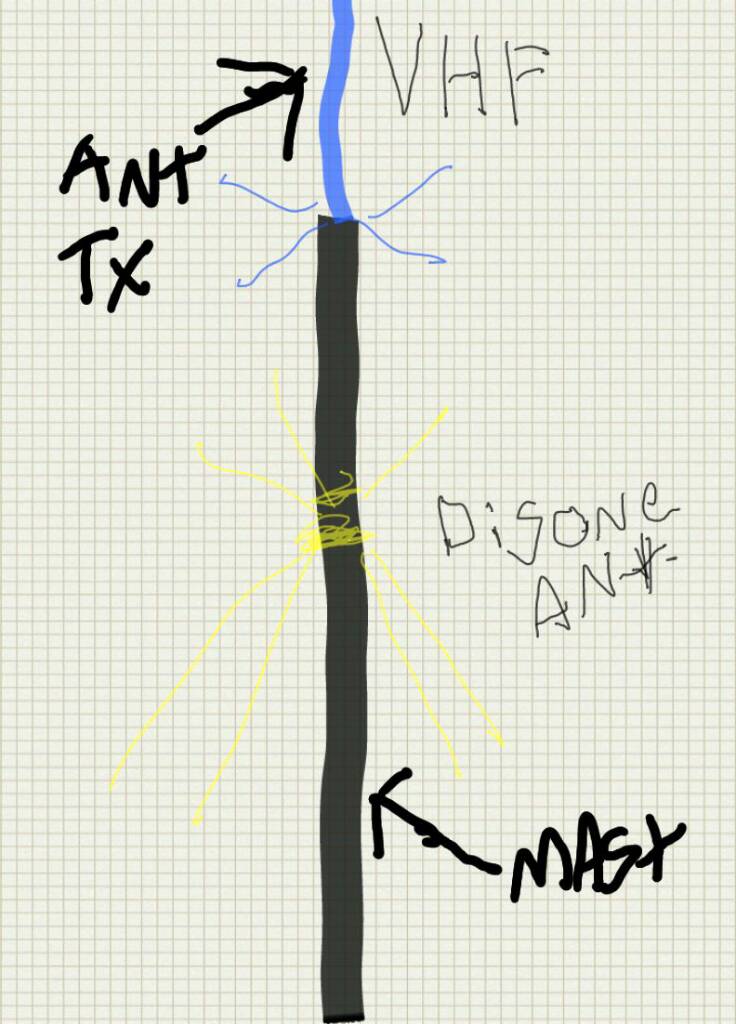

    Real quick can a discone antenna be mounted in the middle of a mast below a tx antenna ? Drew this Rad photo with my note 2.

    A discone offers no gain, keep this in mind if you're trying to monitor far off stations.Does CHP still use VHF low band? if so, the Scantenna would give performance on that band.
