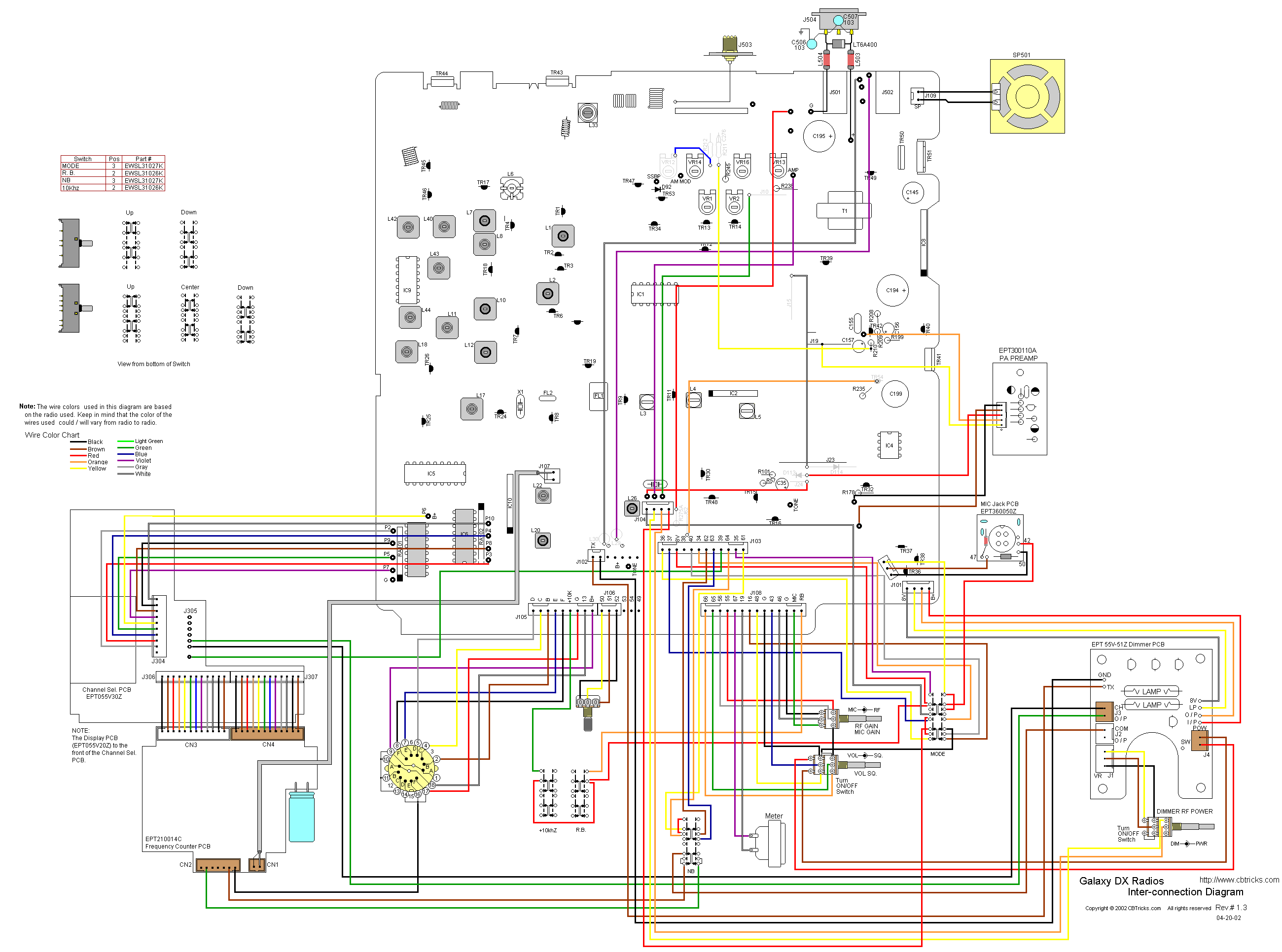

    DX55V Inter-connection Diagram

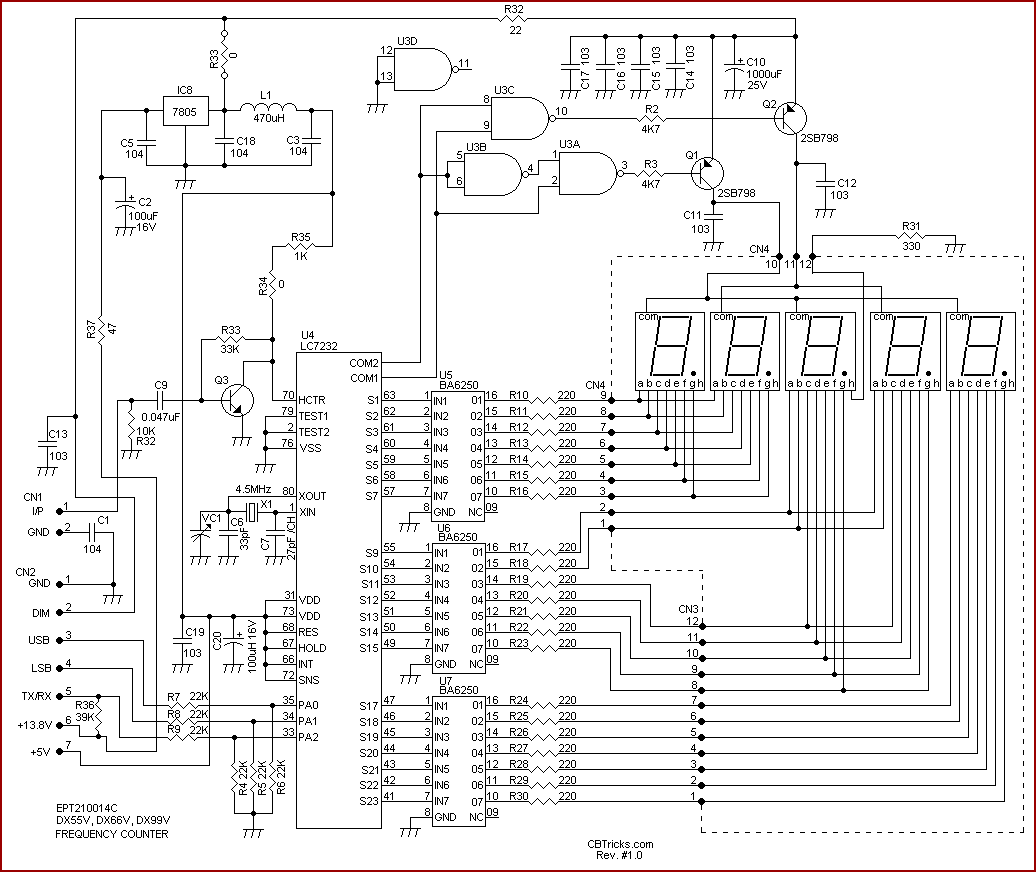

    Frequency Counter PCB Schematic Diagram (EPT210014C)
    Frequency Counter PCB Schematic Diagram (EPT210014D)

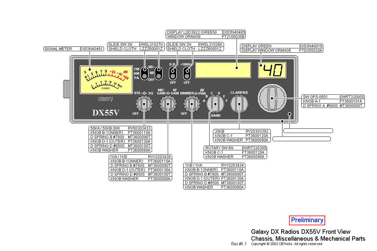

    Front View Chassis Parts
    Rear View Chassis Parts
